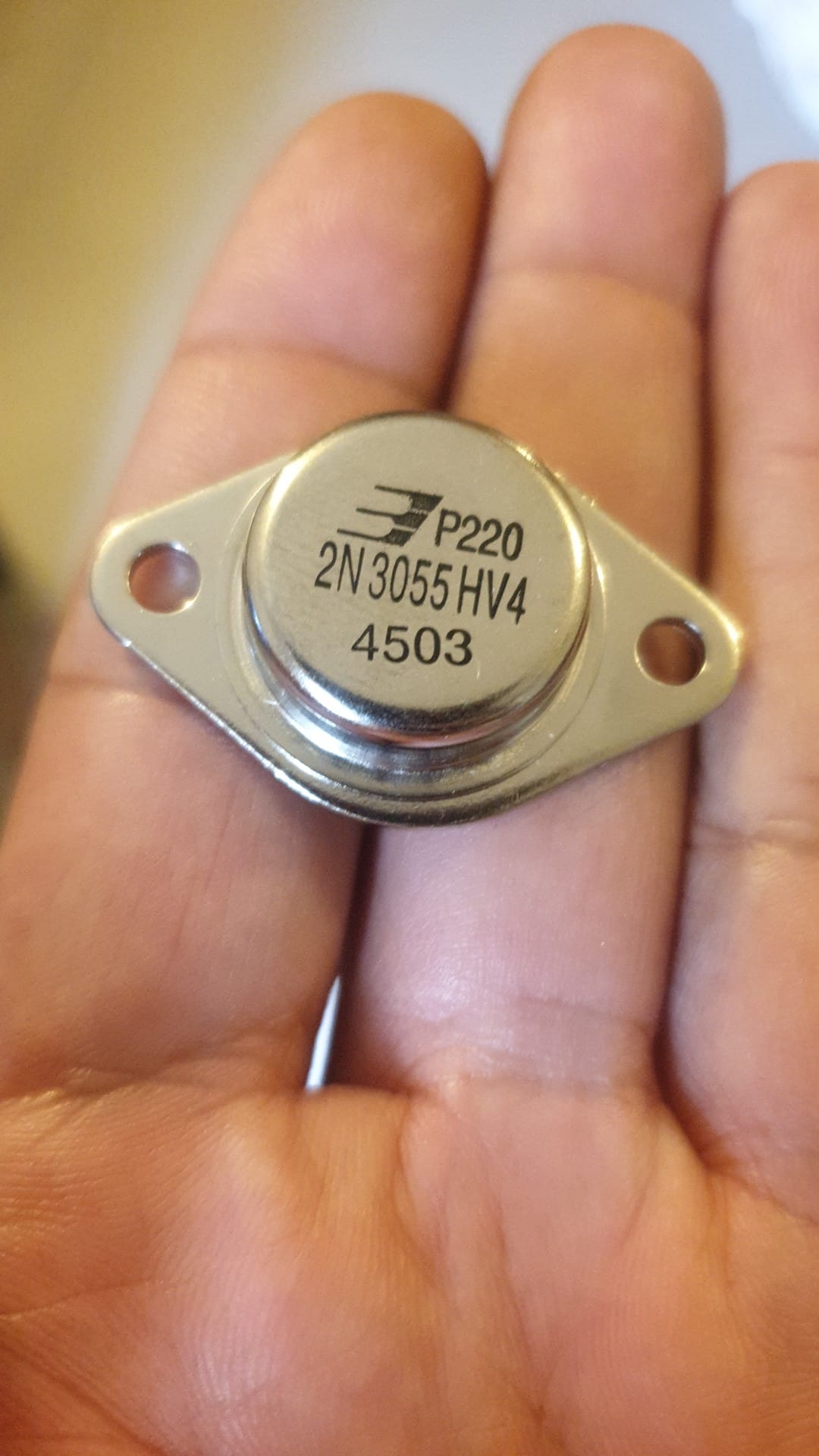

https://static1.squarespace.com/sta...63e1d89f5277f56705/1655092581521/2N3055HV.PDF
'NOTE: This device is also available in Defence/ Miltary, HIREL, JANXXX Grades'.
CDIL, same item.....https://www.cdil.com/metal-can-transistors/2n3055hv-1
Searched, and found same device from CDIL, it is a 100 V version instead of the lower voltage on the regular device, you can check for frequency performance. Note is on their web page.
BEL is mainly defense oriented, the stock sold in the civil market may be excess production or inspection rejects from the parts intended for defense use.
BEL supplies can be erratic, they focus on defense production, see their site.
It does meet minimum specifications, another issue is fakes (!)....stick to CDIL, last they were 40 Rupees when I asked.
Fake BEL are about 20 Rupees.

Here is a pic of the Transistor I picked up a few as I plan to keep this amp for a long time.Hi chinoy,

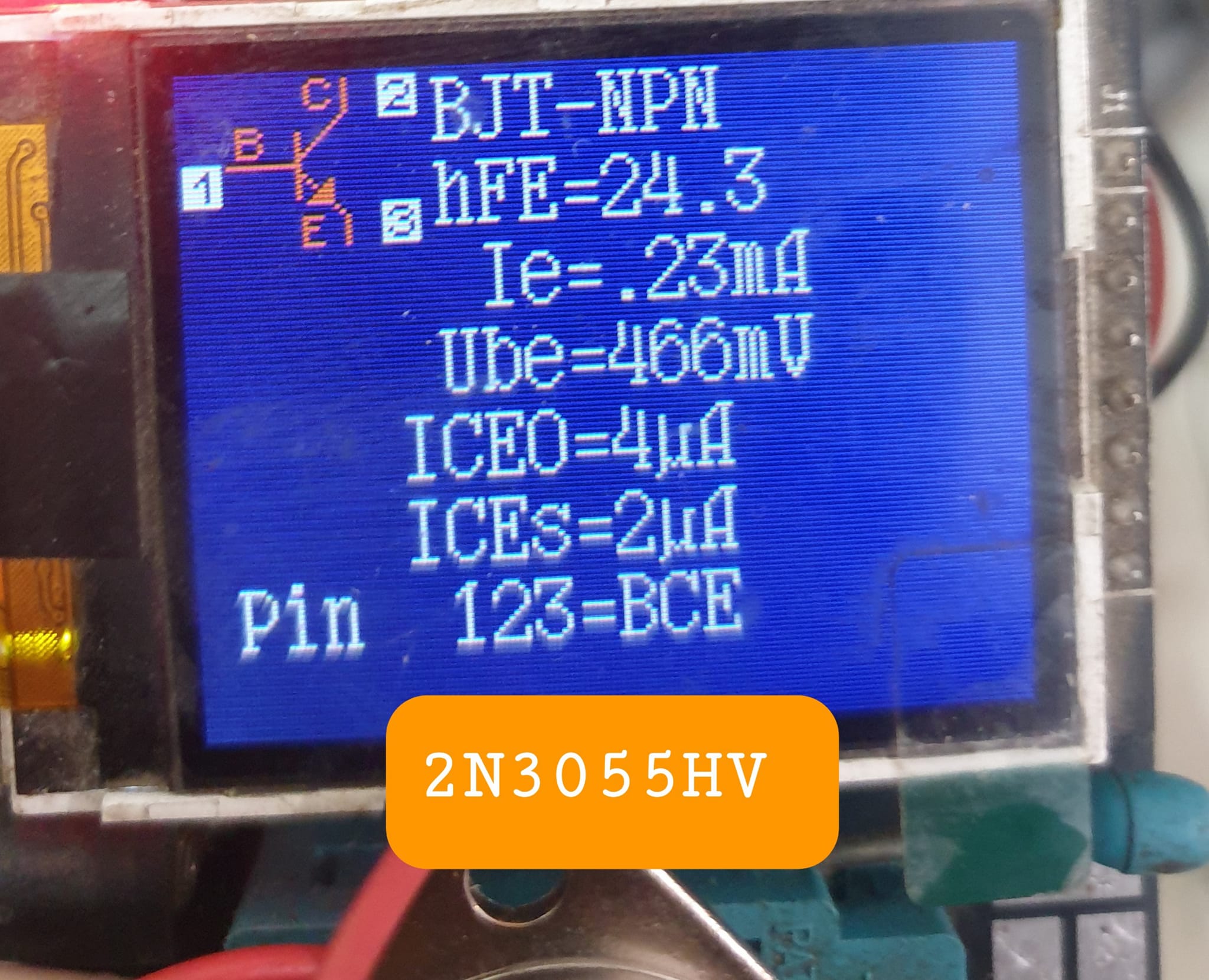

Here is a pic of the BEL transistor and I have a screen shot of its value from a component tester.
These are HV units so are technically supposed to handle high voltages than the regular old plain jane 3055.
The good news is the original 3055HV transistors from that era are still on the amp and still working fine.
These are picked up as backups as they are dirt cheap.

I tested every transistor I own on the tester and have created a database of the values I got.
Noticed that batch to batch Hfe is stable. But same transistor different make or even batch and the hfe values change. So the thought of these dis-similar transistors triggers my ocd.
Here is the pic of the transistor. Let me see if I can add the value screen also. I did not solder a wire to the case so if the values look off let me know and I will re-run it with a soldered wire to the case.

Ps: BEL makes these for our defence sector. So they have to be MIL spec and no messing around. You can find pics with the cap removed and you see the insides look better than the units made by On Semi and other companies.

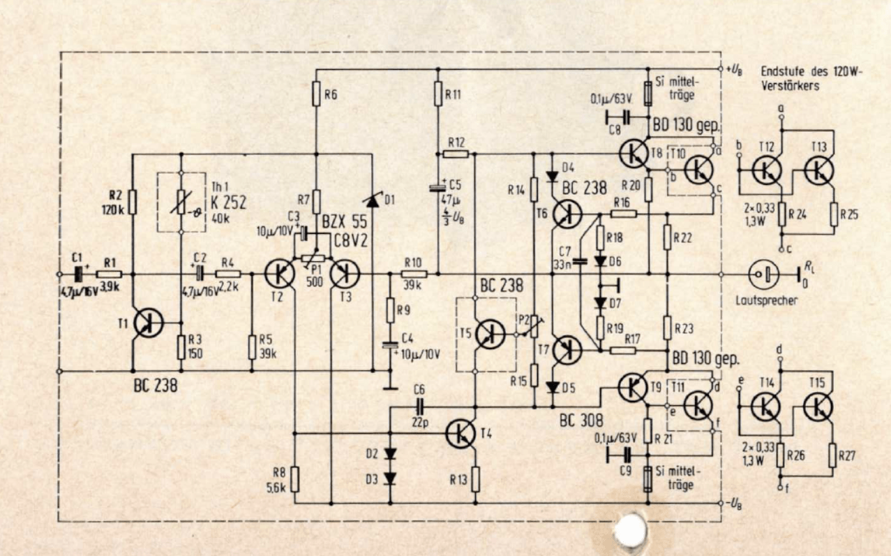

The schematisch in #306 ist a Siemens design, first published in the German FUNKSCHAU magazine in 1971, mainly to promote their own BD130 transistors, a 2N3055 equivalent. Subsequently many German vendors offered complete kits with PCB's to hobbyists. I've built almost a dozen of them. They were quite robust and reliable, even in guitar and Bass amps that I've built. But you needed to chose the VAS transistor according to the rail voltages, of course. The BC547b as suggested by Siemens didn't always serve well.
Didn't I show build instructions incl. PCB layout earlier in this thread?
