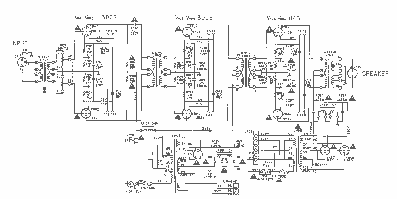

Same as western electric did with the 211? ... see here
Western Electric - Rosetta Stone for Triodes
about 3/4 of the way down the page ... don't think I'll get away with one of these in the lounge

Technically you'll get a diode that way, but in all my years the proper way has been to connect the grid to the plate as pictured in the Western Electric schematic posted by Doz. Not to the cathode.As you do with any triode: connect its grid to the cathode (if it is an indirectly heated tube) or to the ground, where the filament will be referenced as well (if it is a directly heated tube) and you get a diode out of it.

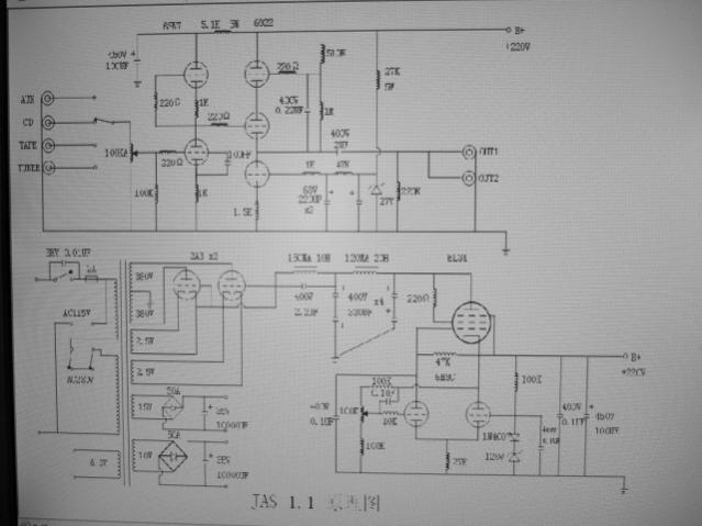

Thanks guys for the replies. I'm going to get the schematic for this so you can have a look. I still don't understand how you can configure a Triode for rectifier duties. Any rough drawing would be appreciated.

MingDa has one...(and a RIAA that use 6N6P as rectifier)
