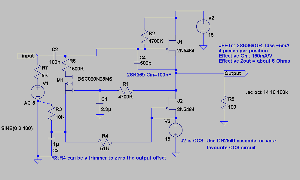

I can see the LSK170, 2SK369 and the 2SK170 - are they all still obtainable? Do you see these as good SE choices directly after the 26 stage to use into a transformer to do the phase splitting? I'm also thinking PP2a3 here.
Presumably a 2SK170 stage would give low output impedence and allow a transformer volume control. This is getting into Thomas Mayer's territory.
andy
Hi Andy. I assume you're interested in zero-feedback circuits - otherwise there's many feedback-buffers on the SS forum, I imagine.
If you just want to stiffen up the output impedance of your 26 preamp, usually a transformer would be a good choice. But if you want to experiment with low-cost SS circuits, the 2SK369 does have amazing performance.
Low impedance and capacitor-coupling is a bad combination, but achieving zero offset requires some kind of servo. Well, why not. You don't need an op-amp, you can use a friendly low-capacitance MOS like the BSS138 (SMD) or BS108.
Here is an idea for a buffer using multiple parallel 2SK369 for driving a TVC or splitter transformer. All you have to do is work out the minimum load impedance, and the maximum voltage swing you need. That will give you the class-A current required for a JFET buffer stage.
for example, say you want to drive 10V peaks into 600 ohms - that's about 16mA peaks. 4x or 5x 2SK369 at 5mA Idss will supply those peaks amply. You can go on adding K369s in parallel to get any current peak you like, but calculate the rolloff from the output impedance of the preamp with the circuit capacitance.
The 2SK369 (Green grade, Idss about 5mA) was still available last time I looked. They give 40mA/V at 5mA, so 4 in parallel give you 160mA/V, with an output impedance of about 6 ohms. This is with zero feedback!
The attached diagram gives a circuit idea, complete with offset-nulling servo in M1. You have to make R3:R4 into a trimmer to zero out the offset. The 26 output impedance is modelled by the 5K of R7, and the 500pF C4 models 4x input capacitance (+ stray) of K369 at Idss. Even there you get out to 60kHz before dropping a dB.
THe class A stage is completed with a current-sink (shown here as J2) - use your favourite CCS circuit, or cascode a pair of K369s.

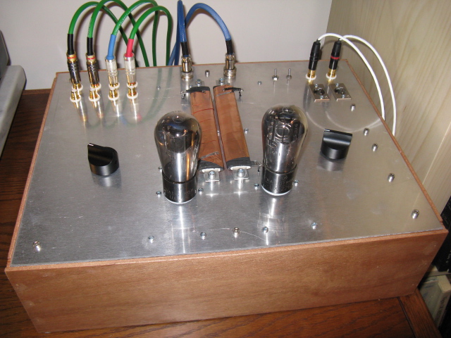

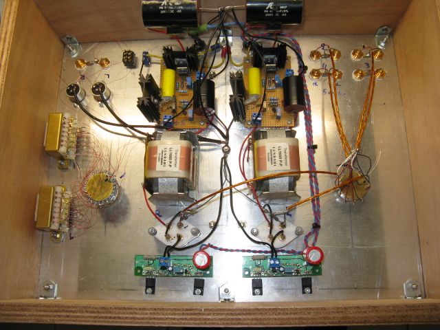

One more #26 pre finished.
This time I used filament bias, instead of battery. Getting rid of the input cap was nice. Also, ll1660pp output transformers, Intact audio autoformers at the output for volume control. Heater regulators by Rod, and double latest Salas design SSHV2 for voltage regulation.
There is big change in sound to the better from the one I had before with battery bias. Mainly it seems clearer and more dynamic. I like it a lot!

With Rod's kits the filament bias seems the way to go, I mean you eliminate an input transformer/cap and don't need a cathode bypass cap, I imagine there is a limit to how much vou can have across the regulator outputs as far as using the cathode resistor in series with the cathode as the load ?
Rod can tell you more about the limits of his regulators. In my build, I have vin 17.5V and 11.4Vout.
Hi George, Looks like good layout and build!
Voltage Rating for Filament Bias:
With correctly specified C1 and R8, any new kit can be configured to run Filament bias up to 45V or so at the input.
With changes of transistor 200V is possible - though I can't imagine it is needed.
Flexible operating voltage - the beauty of discrete-transistor design! New V4 kits are available for Filament bias.
