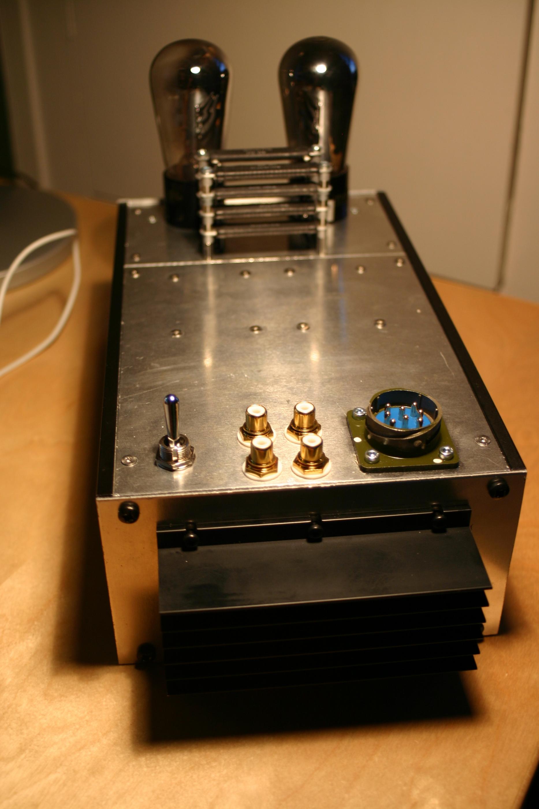

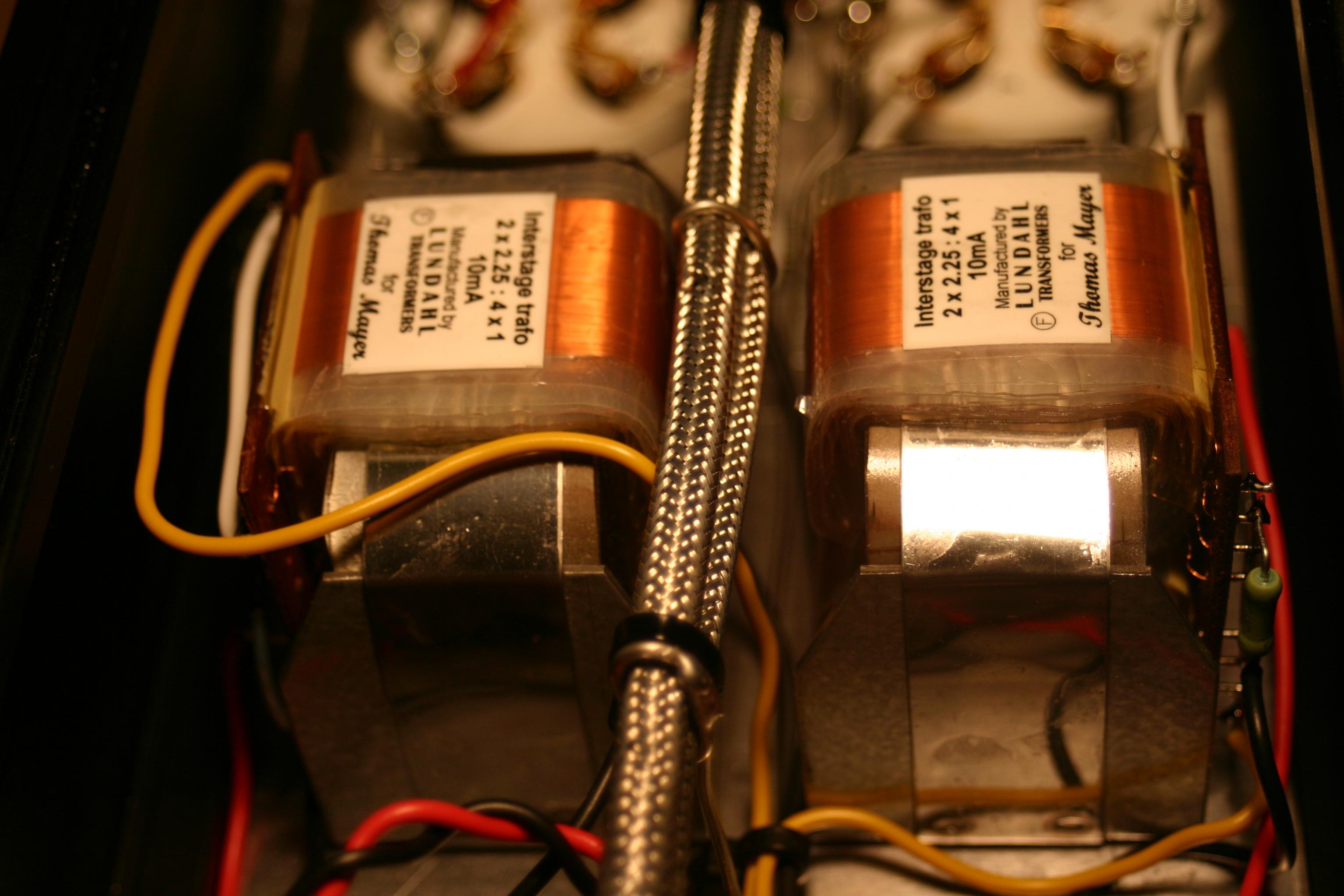

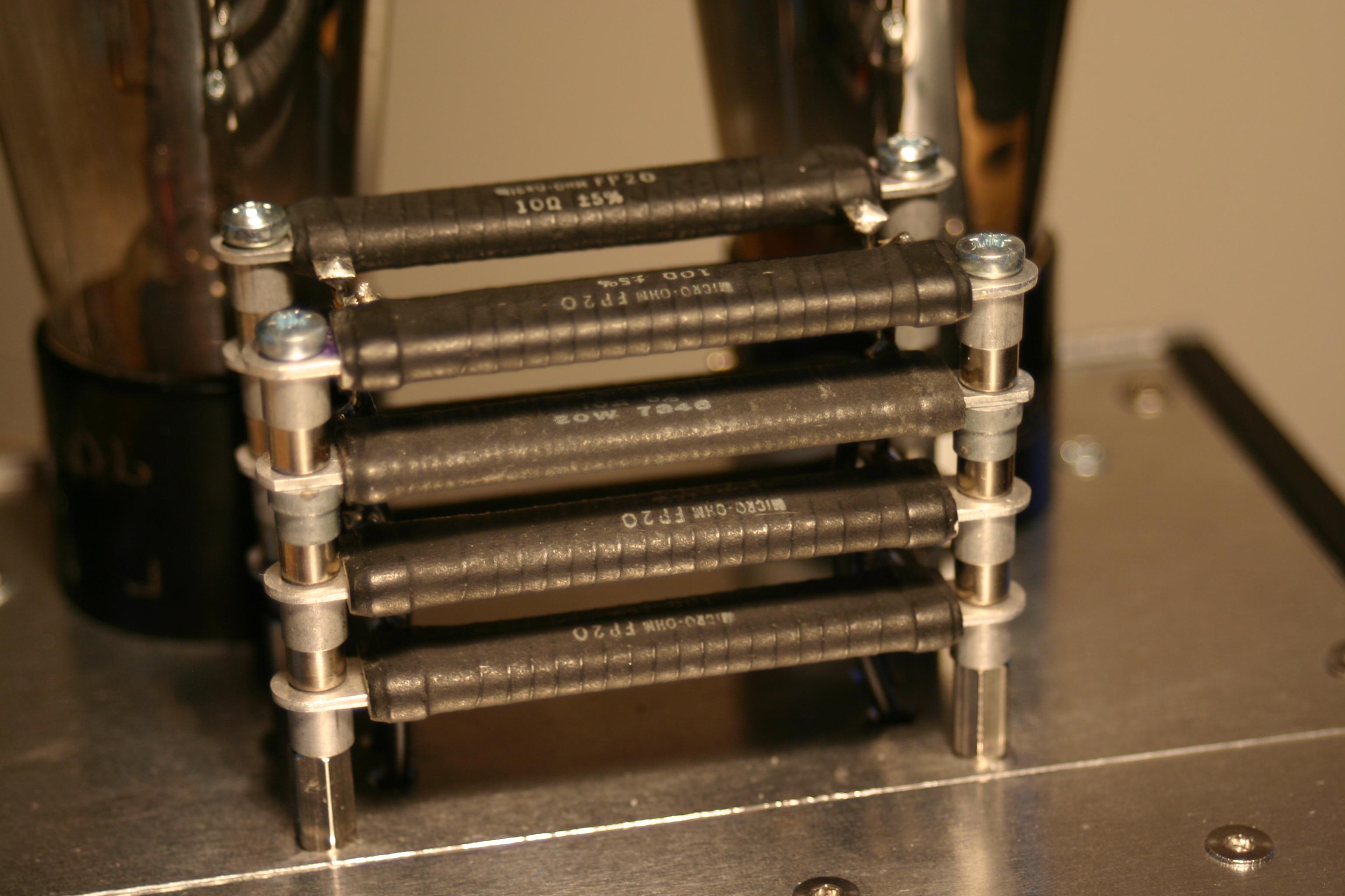

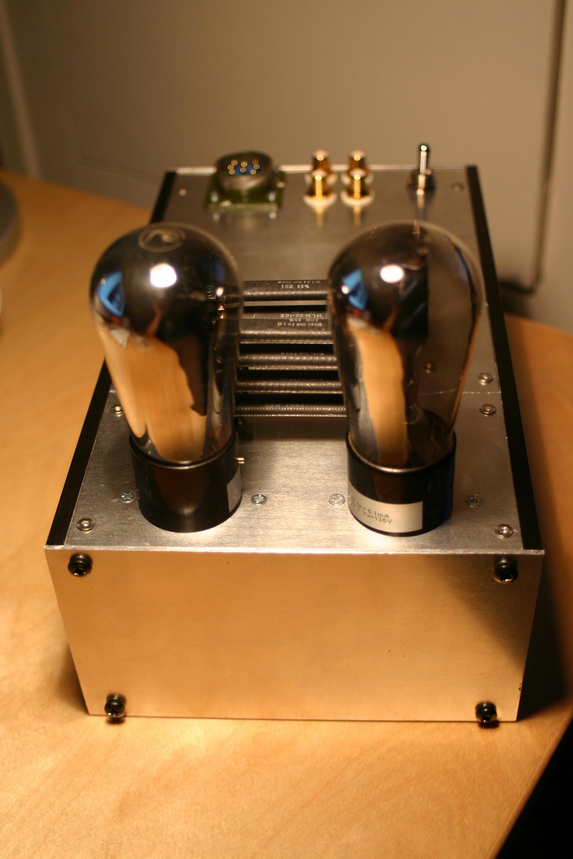

Hello,
Today I finished the 26 pre-amp, albeit still need to build the power supplies.
I did a listening test and was very surprised with the results. Great sound, very warm and natural and gave me the additional slight gain I needed.
I tried a pair of Sylvania 26, which could notice a bit of hum induced when I put my hand around the tube! Then switched to a pair of CX-326. Much better mid and treble.
Noticed that when HT was off had a distinct hum noise which is gone when I apply the HT. Any ideas why this could be?
I have the output floating to the amp i.e. the LL1660 secondary is not grounded...
Ale

Well, that looks great! And the (expandable) pictures are great also. Thanks for sharing.
Hum after switching off your HT is a strange phenomenon. Is this happening when filament supply is still on? Looks like the only source then.
Are there two filament resistors in series and then two parallel to get 10 Ohm? Looks like a little overkill to use an 80W (in total) resistor to dissipate only 10W.
Peter
Hi Peter,
Thanks, it's coming along after all the effort.
I'm suspecting is my HT bench supply as I turned down an output voltage setting potentiometer and not switching it off as I said on my previous post, so will do some tests to find out root cause. I did left the heater supply on by the way. It looks like is the HT supply as I can't explain otherwise why the hum is gone when both supplies are active...
Now need to crack on the power supply design. I will use an AZ1 with a pair of fast diodes for the bridge, an LCLC stage with 20H chokes and 47uF oil caps and a Salas HT shunt regulator for the HT supply...

@ikoflexer: That hum is probably being picked up by the plate chokes. Try to rotate them by 90 degree and see if that changes the hum. Or shield them
Best regards
Thomas
Thanks Thomas, that's the same advice Kevin gave me, and I tried it. Took one of the chokes and put on it longer wires. Rotating the choke did change the size of the hum ripple, but couldn't get it small enough not to be heard. Shield the choke also didn't fix the problem.
