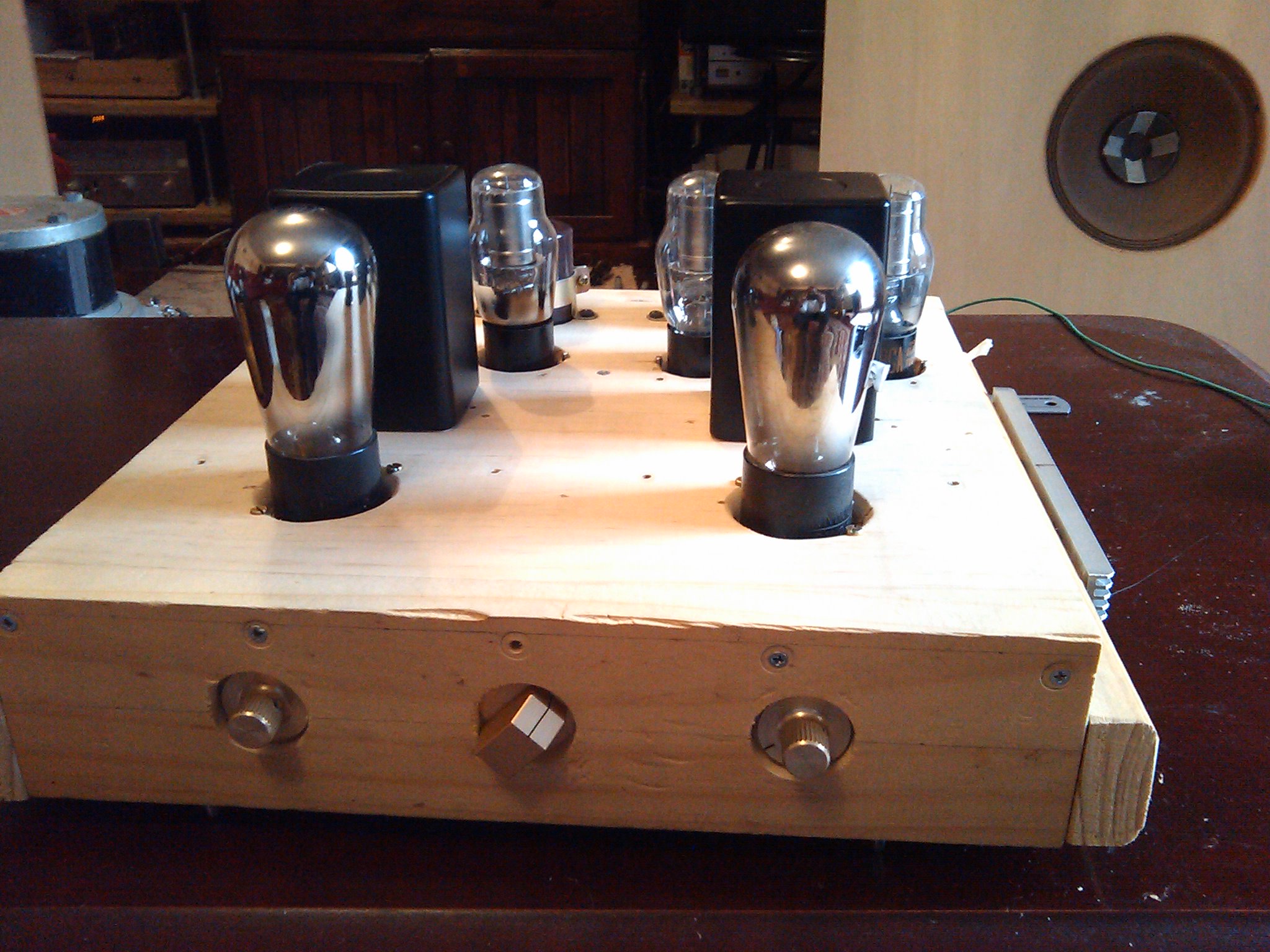

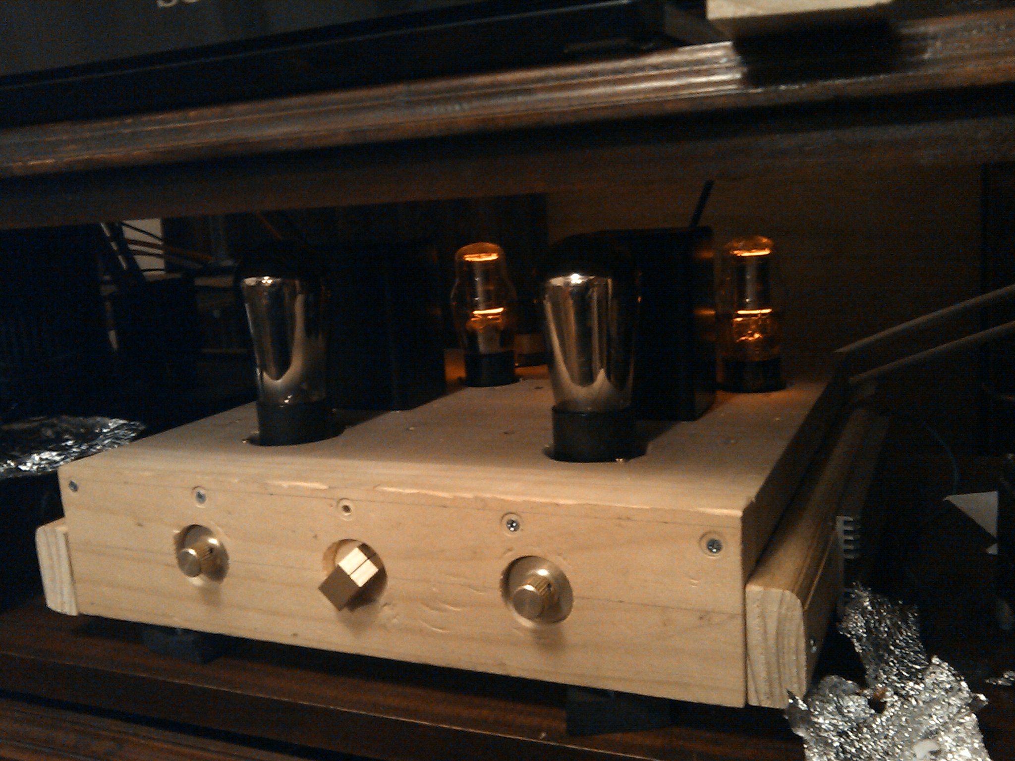

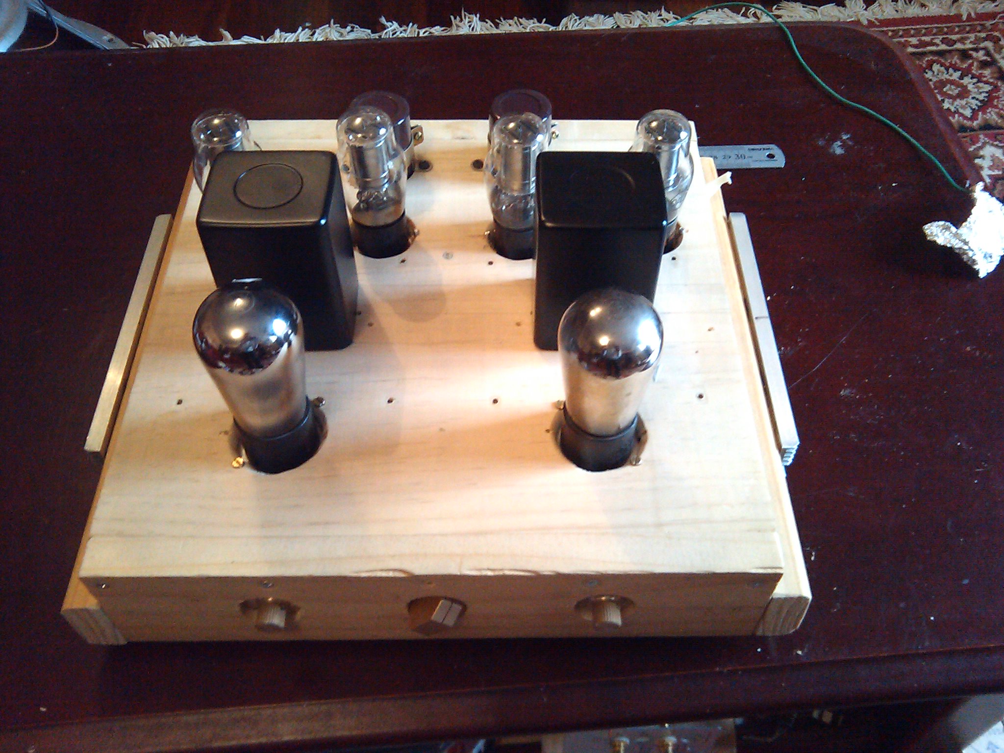

G'day All,
Geez this thread has progressed a lot since I finished my 26 pre. I've recently updated my preamp using some Hashimoto Hl-20K transformers. I was using 2 Hammond 150 chokes in series with a FT-3 0.1uF & 1M RC output, for over a year.
The transformer out did bring a lot of improvements to the sound. Clarity is something that stands out the most, I'm not good at using audiophile words but it sounds much more natural now with the Hashimoto's in there. I've been running them in and the bass is also improving. Still not quite as good as the 300H plate choke, but it seems to be getting there in time.
The rests of the system uncludes a 2A3 PP amp and Philips AD5200M in JE labs open baffles, with Saba black cone tweeters. One thing that was also evident, was the sound of guitar. The notes seemed to have more weight to them.
The next stage is to add a TVC and do away with the pot and input cap. I'm using battery grid bias as per schematics in the this thread. I'll post my findings when I get around to this upgrade.
Rich
