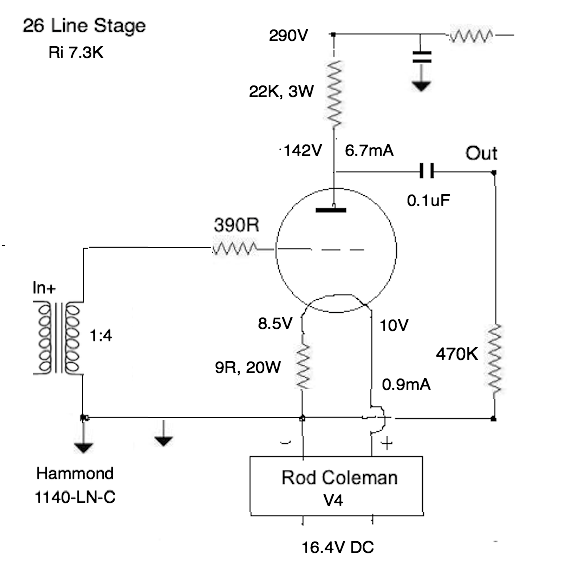

Jogged by the latest posts here I converted an 01A stage that wasn't working very well to 26. I haven't used this tube in ages, but it has a special place in my heart since it was the tube that converted me to DHTs. My jaw literally dropped when I first heard it and I muttered "this is the tube I've been waiting for all my life!"
That was back in 2011, but subsequently I bought some 10Ys and that became and still is my tube of choice. Behind that tube are the 46 (close), 47, 112A and 26. A bit further back the 2P29L. The 46 has the best piano tone and is a leaner, more percussive sound. The 26 is a little plummy on piano but wonderful on vocals. The 10Y is the master of inner detail and subtlety, including the crystal-like treble. The 26 has good treble, but not 10Y class. But nothing really matches the 10Y for all round performance. All these have been used in filament bias with Rod Coleman regs. Big chokes in the filament supply and paper in oil and DC Link caps in the PSU. I use a 1:4 step up since this stage directly feeds my 2a3 SE outputs. The Hammond 1140-LN-C is excellent - one of their broadcast range and remarkably good value.
So here's the circuit I made. I like it and it will stay in my system for a while until I miss the 10Y too much. I sometimes put in the 46 stage, which is very realistic on jazz.

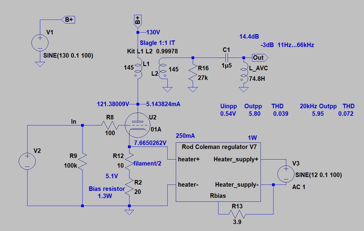

I am looking at the simulation schematic in this message and trying to make sense of it...it shows a design that looks to accommodate either 26 or 01A with cCCS load and switchable filament bias according to the valve used, Rod's V7 filament regs. The switch position is consistent with 01A and indeed the valve is labeled as 01A. But it is shown with Va = 150v and Ia = 5.9 mA, both being way high for an 01A...those values might be O.K. for a 26.
Please explain, and also...what is the circuit inside the cCCS box?
I am looking to try something like this, but with the cCCS replaced by an output transformer and Slagle AVC, maybe with a different HT supply and I'm not sure about including an SSHV2 reg.
This is curious to me because 01A has the same plate structure as type 71/71A, and the filament is a single run (non-parallel) of that used in type 71.

Yes, it was a typo, from previous schematic, where #26 plate voltage was 150V.But it is shown with Va = 150v and Ia = 5.9 mA, both being way high for an 01A...those values might be O.K. for a 26.
The correct plate voltage for #01a is 127V.
As you can see in #01a datasheet, this plate current gives -about- 7.5k rp, so if you want it with choke/transformer, the required inductance -at least- must be (2*rp load) 120H (rather 3*rp 180H):
Zload>= 2*rp
Zload=2*pi*f*L (for example at f:20Hz)

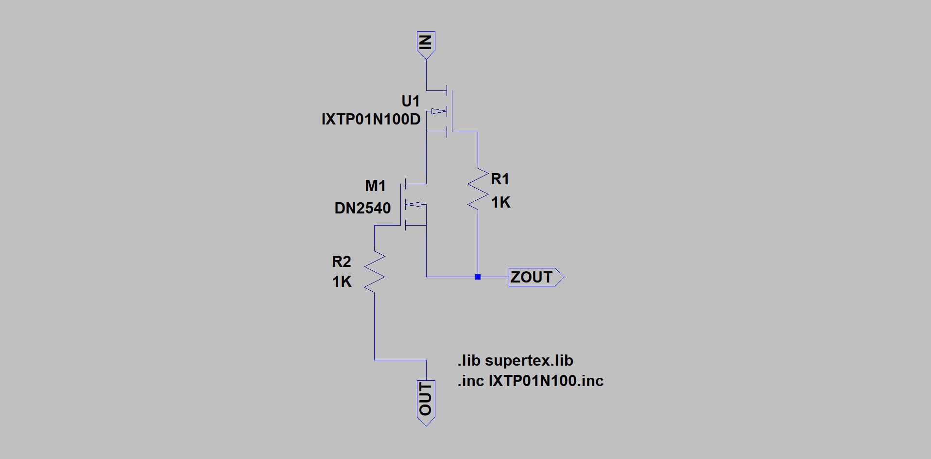

The CCS is simple depletion MOSFET cascode CCS.

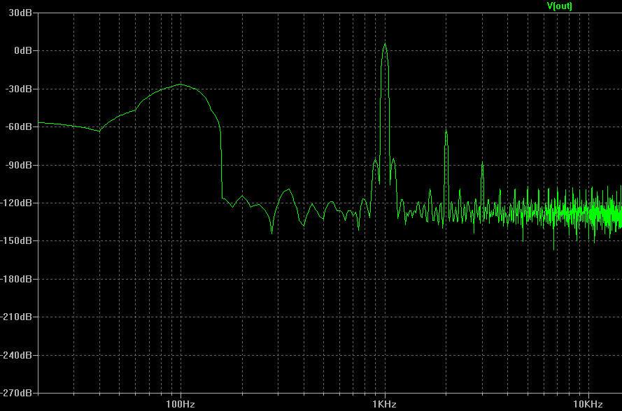

The PSRR of #5277 schematic is "nothing" (only 3dB), so hum/ripple/noise on HT will be present on output about 0.7 magnitude.Thanks euro21, it would be at least LCLC...maybe another LC, or could be a SSHV2...recommendations?
If you get 10mV hum on HT, 7mV will be present on output.
It's not negligible for 2V RMS signal (case of power tube, where signal is few ten Volt, it's acceptable).
I used cLCLC for my 801a preamp HT supply (2mVpp hum on B+) ... but I use Ale's gyrator (at least 40-50dB PSRR).
