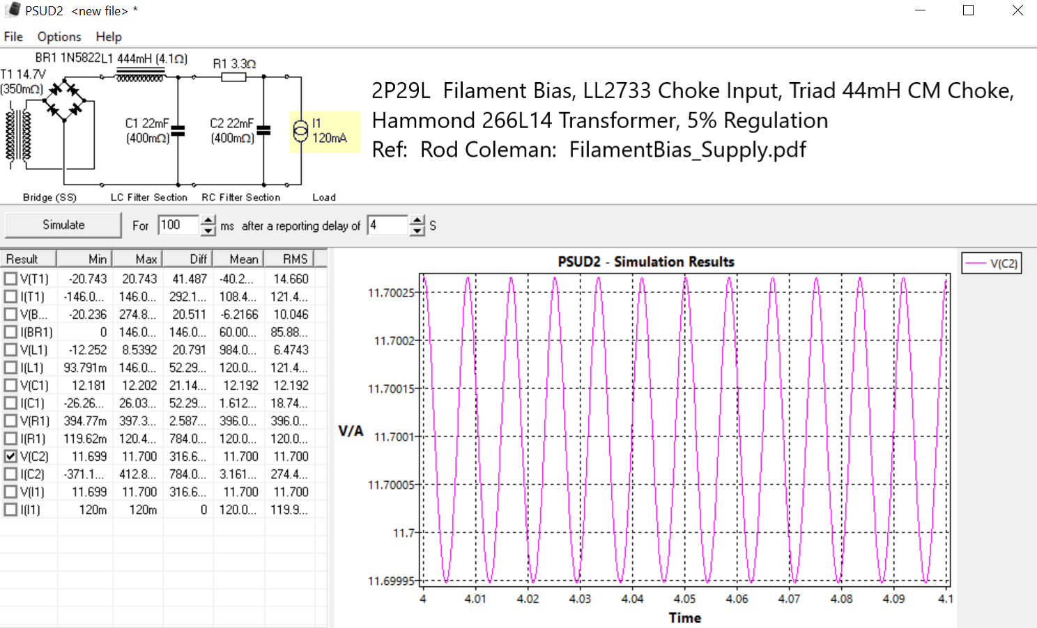

My suggestion was for suggestion was for 22000uF caps, as the difference in ripple reduction between 22mF and 10mF is worth considering at these low voltages—especially considering the cost is the same.
Try it out in PSUD2, see what you think.

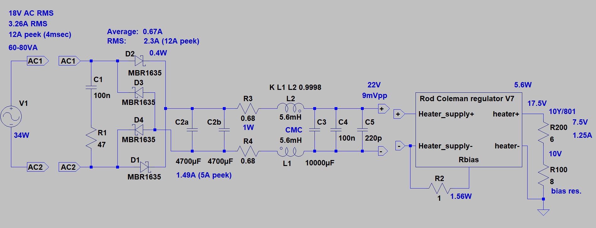

What specific make and model if transformer are you using for the filament supply?
If possible, try to using transformer, which have separated primary and secondary chambers.
This type transformers have minimized primary-secondary capacitance, so disturbances from the (primary) line are less bothered the secondary.
https://ce8dc832c.cloudimg.io/v7/_c...sign=452c6d3c63b2074d9a2702b3868b3ed5570236ef
I usually use Indel transformers, but any similar is appropriate.
https://www.tme.eu/hu/en/katalog/transformers-with-fastening_100531/?mapped_params=2:337;101:1445764;444:1445638;445:1445082;
The rule of thumb: use at least two-three times larger dissipation transformer than load!
p.s. sample (working!) LT PSU for 10Y/801a

Thanks John,
I did that and included a LL2733 input choke. The p-p ripple is reduced to about 0.3 mV, see attached. Please let me know if you note any abberations in the PSUD execution.
The caps were the ones you suggested...EPCOS B41252A5229M000 at Digi-Key, $5.07 each. They are 105C, life is only 2000Hr at that temp, but increases to 20000Hr @ 71C and 50000Hr@60C...shall see what they actually run at.
Best, RC
