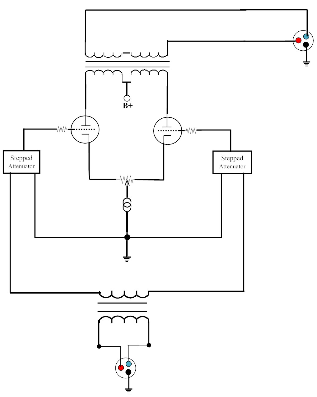

Balanced Differential #26 Pre-Amp
What a great thread!!
Unfortunately, it's a bit long and hard to find stuff. I suspect the questions I'm about to ask have been answered before so I apologize in advance (and also for the long post).
I am designing a preamp and need someone to look over my shoulder to see if I'm calculating things correctly.
Design Concept
Each channel of the preamp uses two #26 tubes in a balanced differential pair. The two kathodes of each pair are tied together and bias will be provided by a CCS in the tail.
Each tube will likely operate around 6mA and the anticipated plate resistance per plate is about 7400 Ohms. A drawing of the basic concept is attached.
I don't need much gain from the preamp; 2 dB will be plenty. This will allow use of a step-down transformer to lower the output impedance. The preamp will connect to a crossover with an input impedance of 25k Ohms. I'd like to get the output impedance of the preamp down to 2.5k Ohms, or less. I can fudge on this last requirement if necessary, as the cables will be very short.
Here are my calculations and questions:
1) Load from the Tubes. How do I determine the effective plate resistance of the differential pair as seen by the output transformer? Is it just double the Rp of a single tube? That would be (2 x 7400) = 14,800 Ohms.
2) Reflected Impedance. Assume (for the moment) that the step-down turns-ratio is 4.5 to 1. The reflected impedance from the 25k Ohm crossover will be the square of the turns ratio multiplied by the load: (4.5 x 4.5) x 25,000 = 506,250 Ohms.
3) Inductance Load. The load presented to the tubes from the transformer is dominated by the inductance of the transformer's primary coil. This varies with frequency.
Load = 2 x Pi x F x L.
F = frequency in Hertz
L = Inductance in Henry's
Assuming a transformer with 240 Henry's in the primary coil, the load presented to the tubes at 20 Hertz would be:
6.28 x 20 x 240 = 30,144 Ohms
This is about 2.0 times the combined plate resistance (assuming item #1, above, is correct). This seems low from my experience. A transformer primary with 295 Henrys would produce a load of 37,052 and about 2.5 times the tube's combined Rp. This seems like a more appropriate load for the #26.
4) Low-End Bandwidth. The -3dB frequency = Z/ (2 x Pi x L)
Where Z = "Reflected Impedance" in parallel with the combined Rp of the tubes.
Assuming I got item #1 correct, this should be:
Z = ((506,250 x 14800) / (506250 + 14800)) = 14,380 Ohms.
And, the -3dB freq (assuming 295 L) = (14,380 / (6.28 x 295)) = 7.8 Hertz.
5) Gain. If the tubes Mu = 8.3 and the transformer step-down ratio is 4.5 to 1, the gain for each volt of input will be:
8.3 / 4.5 = 1.84 volts out.
6) Output Impedance. How do I calculate this?
If anyone spots any errors I have made, please let me know. If others have built a similar preamp circuit I'd love to hear about your successes and failures. Advice on an appropriate output transformer will also be welcome.
Thanks!

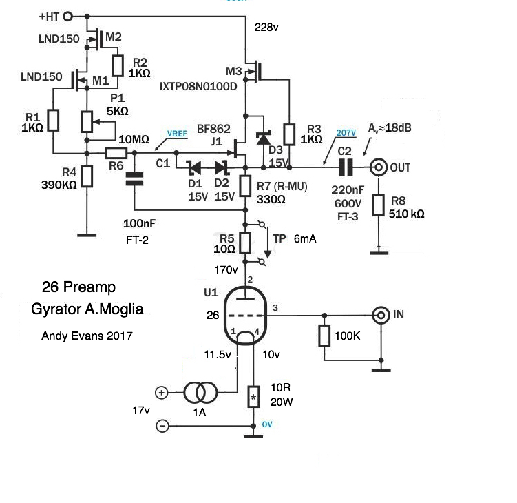

Not much action on this thread recently so I thought I'd post a build I just did.
I built myself a 10Y line stage with filament bias at 1 amp so I could swap in a pair of 26s without much work. It didn't take long - just change the cathode resistors to 10 ohms and dial in 6mA on the gyrator. I attach the schematic.
I can say straightaway that the 10Y is a better sound. More clarity, more detail, more dynamic, tighter bass. I was surprised that the usual "warm and euphonic" sound of the 26 wasn't in evidence with the gyrator. It was clear and neutral in sound. But that extra dimension of magic with the 01A and 10Y wasn't there, alas. It stayed on earth. A good clear DHT sound nevertheless and would see off most other line stages. If you hadn't heard what a 10Y or 01A sounds like you'd probably look no further. I don't know if in the case of the 26 the gyrator is the best solution, but it makes demands on a plate choke with its higher Rp.
Where does the 2P29L figure in this? Again not a 10Y or 01A and I've only tried it out with a 126C as plate choke. But I like that combination, more than 26 with the gyrator.
I think the future is with the 10Y, once I figure out the best operating conditions. Thankfully I have a few of them. I still need to hear the 2P29L with the gyrator and also the 01A with Ale Moglia's new source follower board, since I'm driving a PSE 4P1L output stage.
My journey into DHTs started around 8 years ago with the 26 and I've only used DHTs since. I have a lot of affection for the tube, but this wasn't its best incarnation even though the operating points are pretty textbook.
Interesting observations. Perhaps you are right and that the mu-out of the gyrators doesn't enhance the "intrinsic" sound of the 26 tube, but somehow changes it to something different. I haven't been entirely happy with my build either (when do we ever?). For me it has become too detailed, clean and neutral. I have experienced something similar when I tried out some amorphous core input transformers from Lundahl years ago.
Yes - the 26 with the gyrator is a disappointment. Not sure why. The amorphous transformer analogy is also interesting. I have a few OPTs - an amorphous core one, a couple of standard Lundahls LL1620 and LL1664 and two O'Netics. Recently I've been listening to the O'Netics. Not the detail of the amorphous core, but I've been liking what I'm hearing, especially the smoother treble.
But the 10Y is something else - I can hear words clearly that I never heard before in choral music, modern gospel and the like. It's a step up in clarity. But again, I'm not sure if it lacks a little body and warmth. Need to sort out the right operating point and run it hotter.
