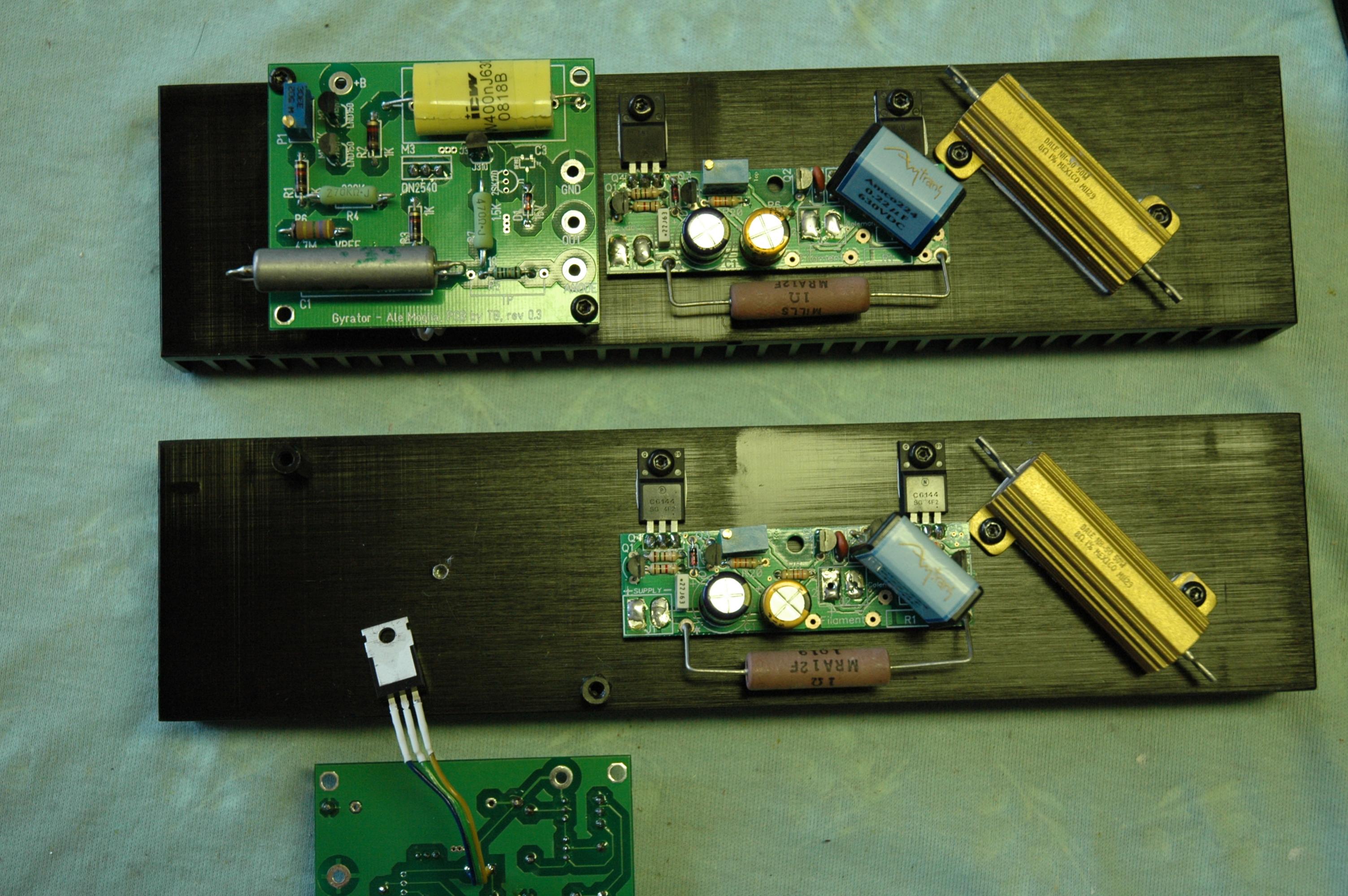

The common-mode impedance is fairly low, but in differential mode, maybe about 1KΩ.
If you try larger cylindrical capacitors, use a C-meter to determine which lead connects to the outer foil, and connect this to the Bottom PCB lead (nearest J2).
Shielding the capacitor, or locating big caps too near to chassis may also degrade performance.
Leads of more than about 20mm, or capacitor bodies longer than 20mm are likely to cause more problems than they solve.
Having said all that, you may be able to find a silvered-mica cap of 150n 50V+, and that might be worth a try. The ac-voltage is so small that mica's soakage-effects won't be a problem, and the dielectic is otherwise as good as it gets.

C3 is in the control path, but the signal voltage across it is well below 1mV, so I would be surprised if there were any differences with fancy dielectrics./QUOTE]
Surprisingly -or not :) - the difference is audible.
Good polypropylene capacitors are "better" than stock ones.
I regularly use Amtrans metalized PET capacitors here.
Amtrans AMCO | Hifi Collective
The lead-pitch is 5mm, for the PCB position.
This old sorrow for us. :)
As you can see, the soldering -via as poppy seed - and fixing is a real pain.
Redesign would be an salvation. :ppp
How about PPS dielectric? It's better for time-constants than MKT, and the 6mm long SMD chip will solder to the back of the PCB easily, and its EMC 'moment' (susceptibility to pickup) is that same as the standard part.
ECHU1H224GX9 PANASONIC ELECTRONIC COMPONENTS, Film Capacitor, 0.22 µF, 50 V, PPS (Polyphenylene Sulphide), ± 2%, ECHU(X) Series | Farnell element14
I haven't compared caps, but use a 0.22uF Hovland Musicap as C3, mainly because Simon (sjs) said he uses fancy caps and resistors (R1) in positions "where they are claimed to make a difference". :D I have a bunch of the Hovlands, 0.22uF and 0.33uF, so it cost me nothing.
EDIT: I posted this before I read Simon's post! :sorry:
