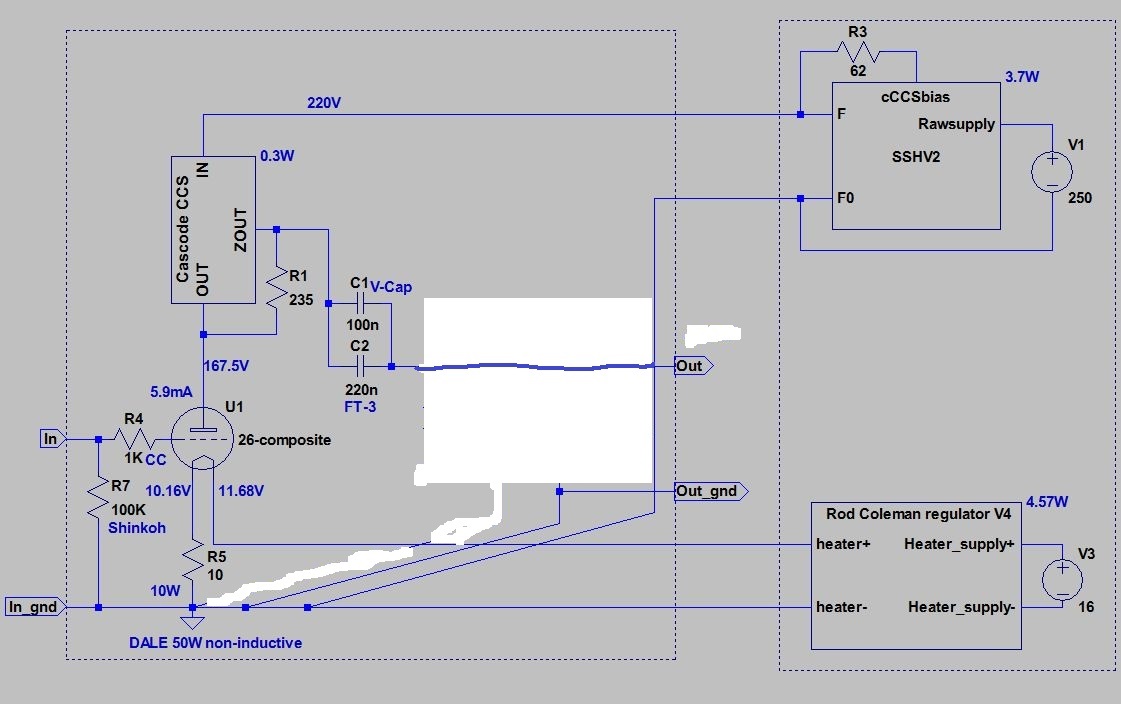

Very very similar to euro21 except without the S&B.....I am using only one SSHV2 for the 2 channels (space limiting!!).......actually he helped me a lot to put my 26 together......but I am using Salas SSLV for the filament instead......dead quiet 26...
My thanks to euro21
My thanks to euro21
Is V-cap = vitamin cap; and FT-3 = Russian Teflon Cap ??
If not, what are they please??
V-cap should be V-cap, expensive stuff, not Vitamin Q. See V-Cap Fluoropolymer Film Capacitors | Oil Capacitors
FT-3 are the Russian teflon caps, yes.
