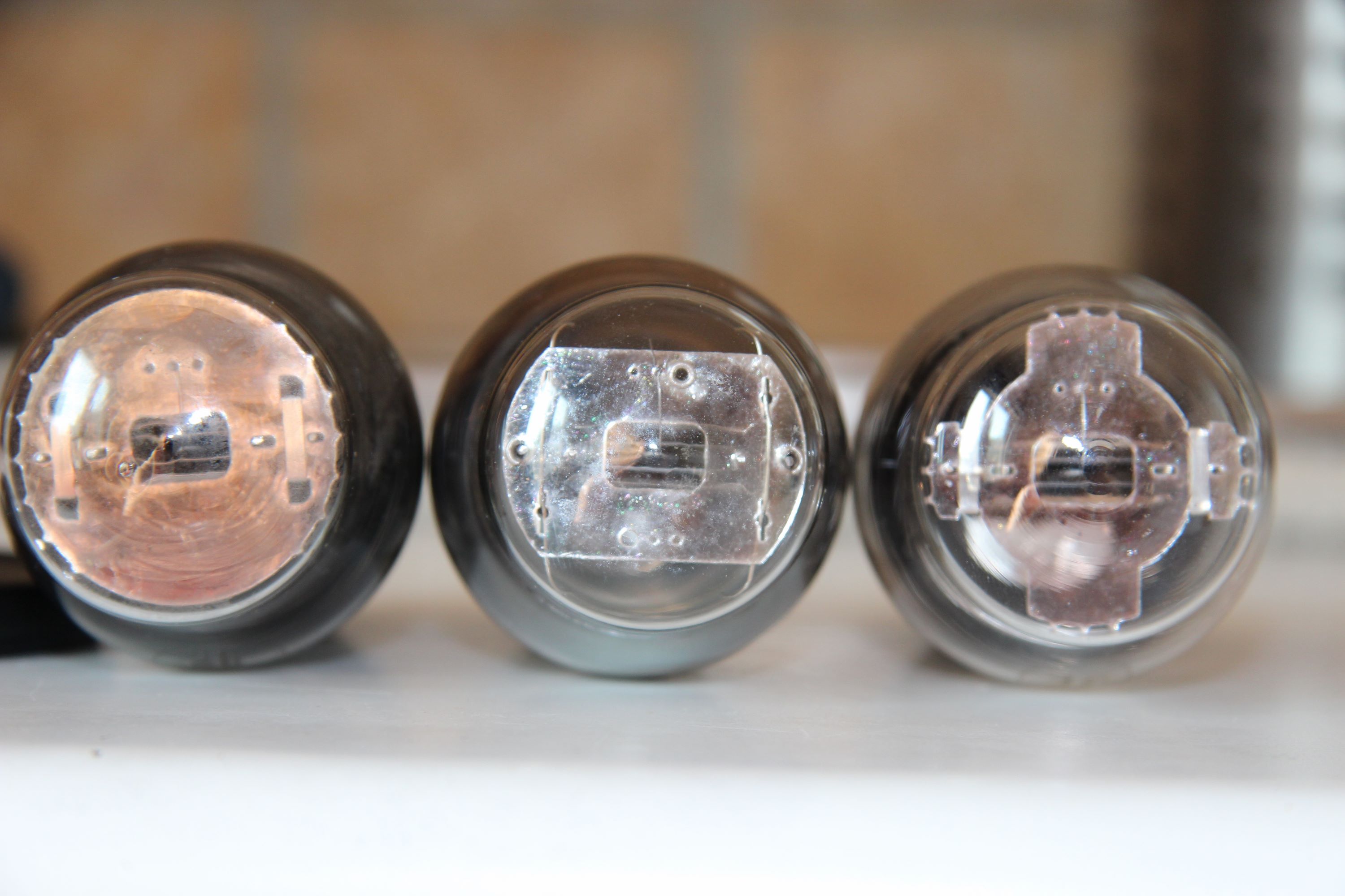

Thanks for the shared opinions. On the #26 tubes that I have, noted construction differences are :
- ST have larger mica spacer that touches the glass envelope
- Globes have wider and larger plates
- Globes have closer grid to plate distance
Can not say if noted differences between types are consistent on wider selections. However, those properties will certainly contribute to microphonic and resonance property differences as Susan mentioned.

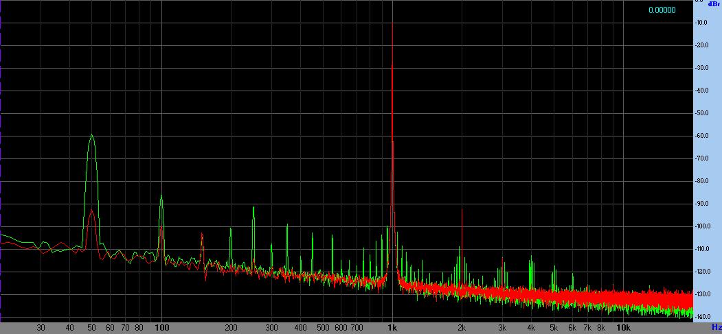

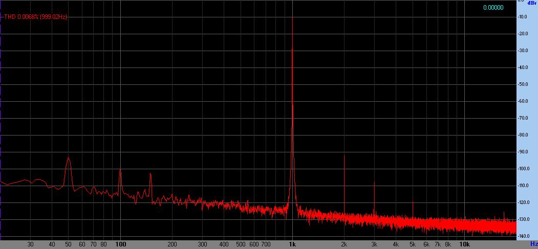

Try simple FFT measurement.
Good signal generator (I use Victor's), or sound card output - preamp-attenuator-sound card input-FFT capable program (for example Visual Analyzer).

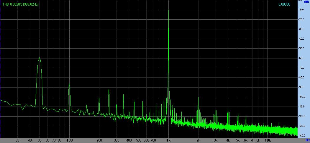

This is my #26 preamp, with different (same manufacturer, same product) tubes.
As you can see, the THD is nearly the same, but the tubes filament sensitivity of hum is significantly differ.
This difference (25dB at 50Hz) is audible. The green curve has sidebands around the 1kHz base, and harmonics (+/- n*50Hz).
That is a HUGE difference, and simple to set up and measure too.
I assume that this is mechanical pick-up from a chassis mounted power transformer?
It would be interesting to set up an isolated test platform with a voice coil actuator (old bass speaker?) to do vibration testing with spot and sweeps.
Anyway, great post. many thanks.

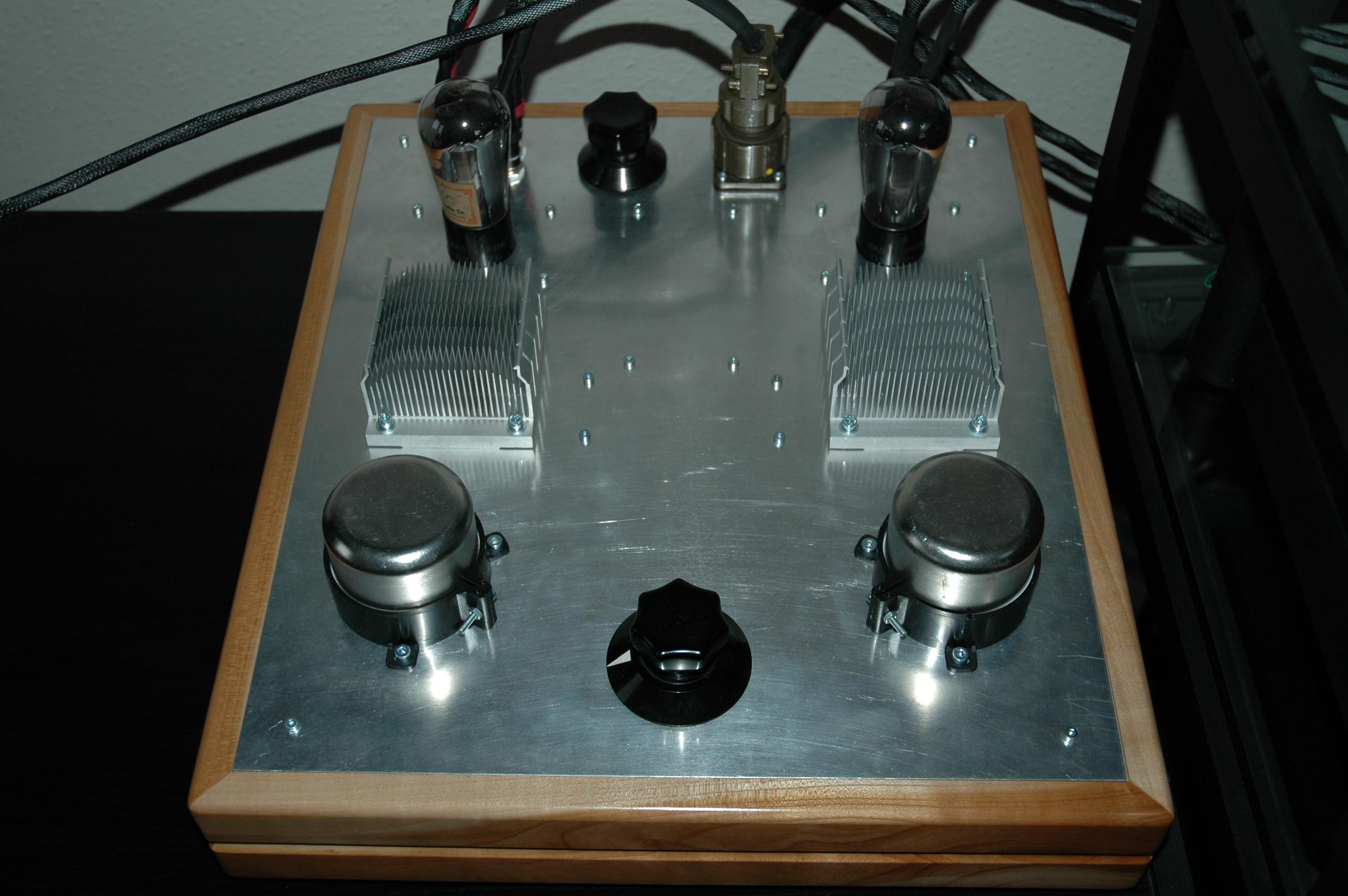

Joined 2004
It's the two box system, 2m umbilical between us.
PSU box is about 8-10kg (large HT transformer, AZ1 mesh, CLCLC + SSHV2 for both channels, separated heater transformers and raw supplys).
Within the preamp each tube socket is on the suspended sub-chassis.

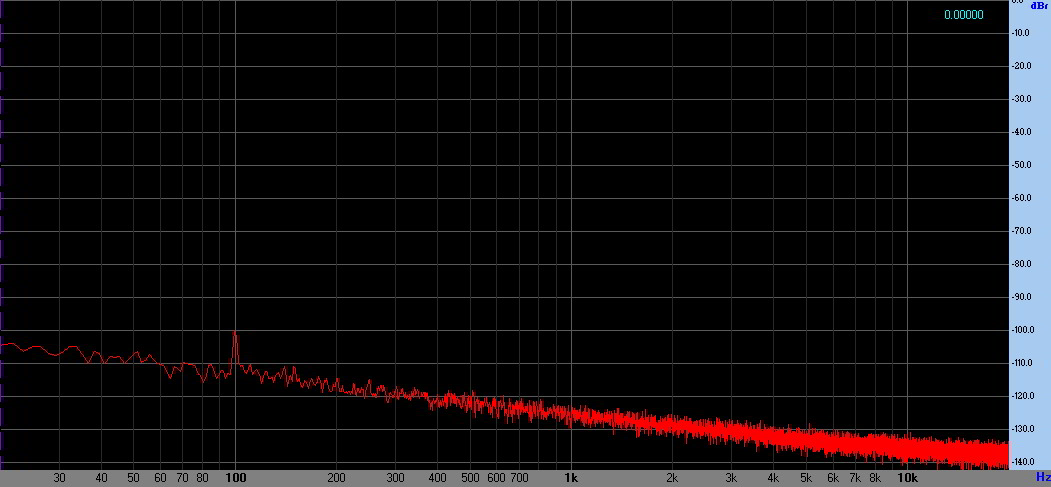

This is the self noise of the preamp (with the least hum sensitive tube).
#26 heater wire -mostly the globe versions- is very sensitive to (induced or radiated) hum, even though I use Rod Coleman regulators.
I have about two dozens of different #26 tubes, after the selection ("best" working points, hum, THD) I have two or three -mostly- identical pairs.
Mechanical noise sources would be unexpected - with vibration from a mains transformer, I would expect to see only a little 50Hz, and much more 100Hz (the core's magnetostriction-driven expansion-contraction cycles occur twice for every mains-driven flux cycle).
When 50Hz dominates like this example, I think that EM coupling is more likely. Different valve designs present varying amounts of loop area (grid-filament loop or filament's own loop), and maybe this is enough to show the difference.

I've stopped using globes as they seem in general to be even more microphonic than the STs, and I have found some ST types to be better than others, and it seems to relate to the design of the top mica, those with only two contact points to the envelope seem to ring somewhat less than those with 4, and much less than those where the entire mica contacts the glass.
