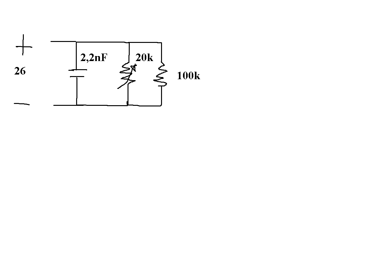

Like the pic?
Joined 2011
My power amps have an input impedance in unbalanced mode of 100K, how to calculate de RC filter?
I'm not sure how you got in on RC filter. Maybe that is the thing, I dont know. It will cut off outgoing HF. If you want to ease up the ringings in the OPT tho, I think one can either experiment with zobels etc on the primary or, for the bold, introuduce some small GNF with a cap over the resistor.
