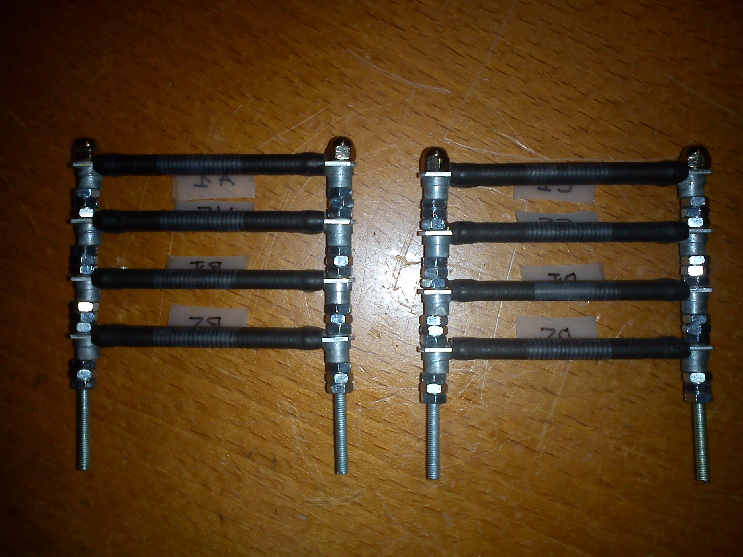

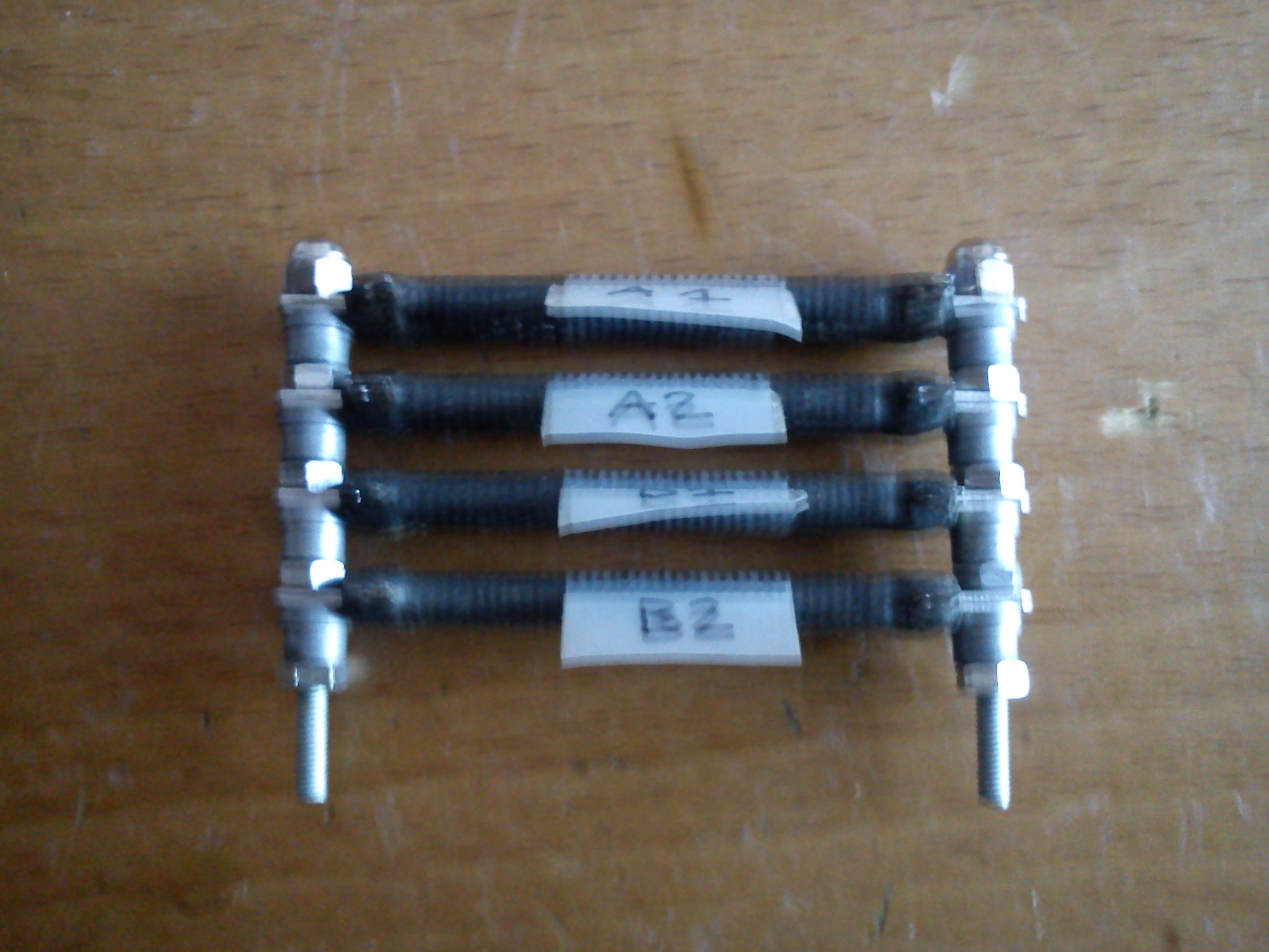

As a suggestion, you may want to consider increasing the space between individual resistors of each stack as they will get hot. Not the most efficient way to dissipate the heat by stacking them up vertically. I have them just like you buy added some metal separators between them an longer screws...
Ale
It's enough the increased space between individual resistor?
That's better Filipe. Looks good to me.

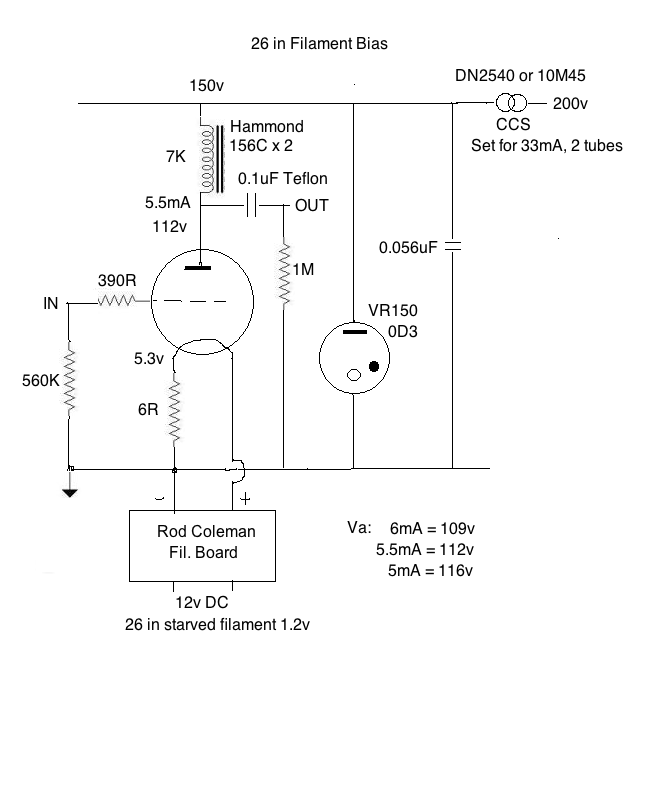

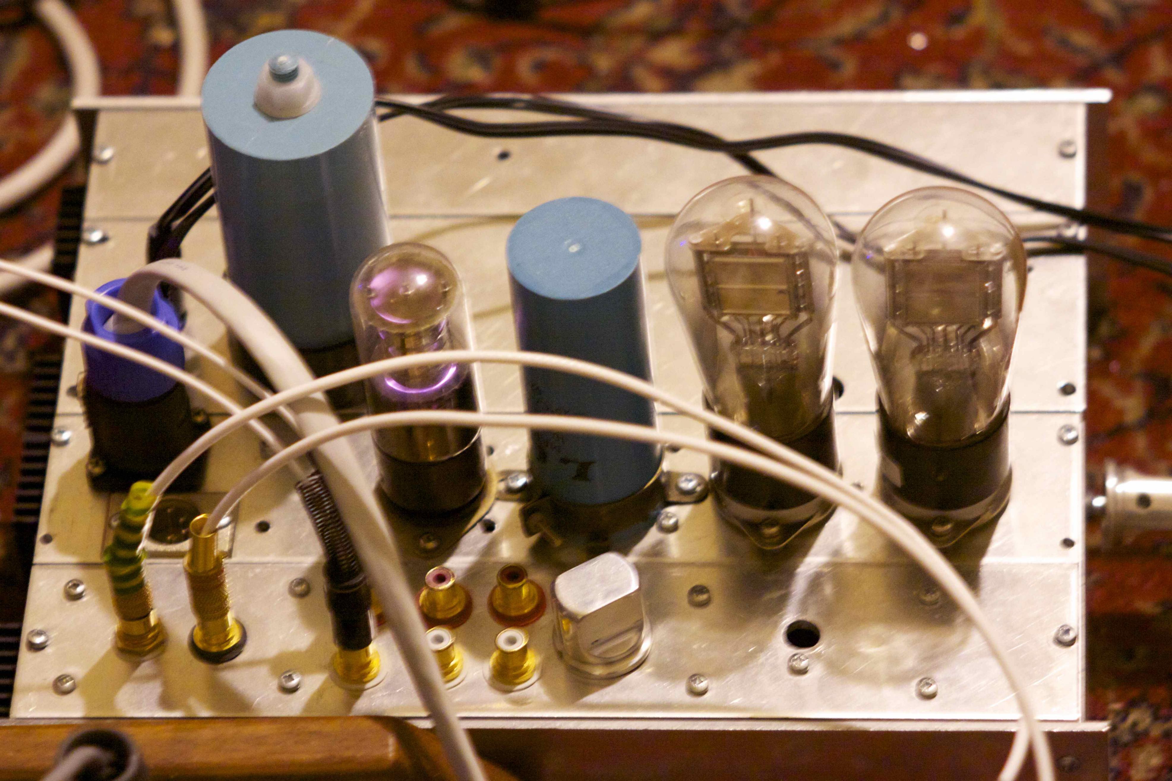

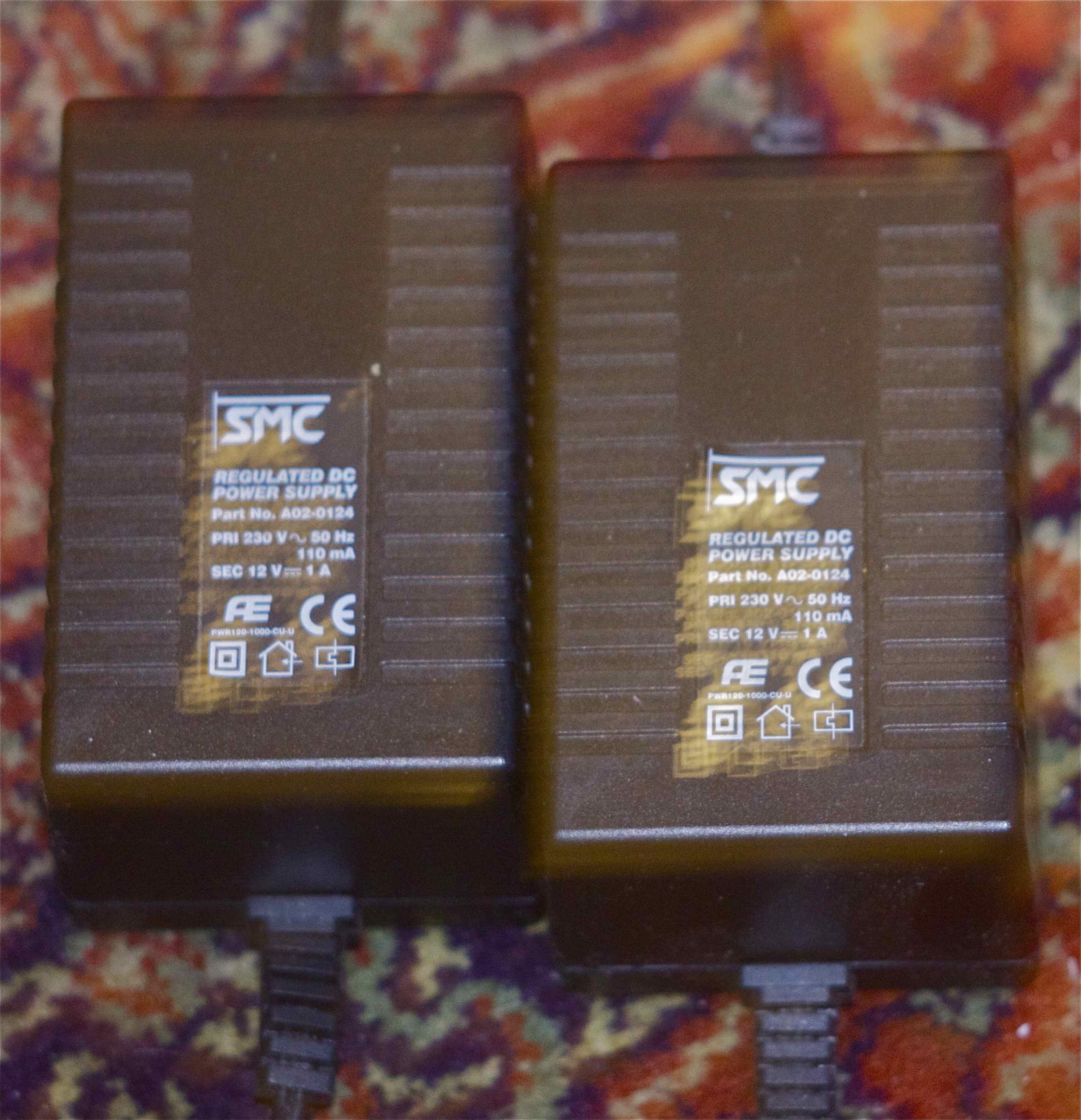

I've gone back to my 26 preamp with the two 156C in series and updated the power supply a bit. The hum is still there but not audible from my listening seat, just close up to the speaker. So that's proof to me that the 156C option is viable. I must say it sounds really nice with the FT-2 teflon output caps. I'm using a couple of ordinary commercial 12v DC supplies - probably switch mode I'd guess though I haven't got inside them. They sound much better than I'd expect!
Thanks Andy,
Try FT-3 in place of FT-2, huge difference: I have both.
Cheers, Felipe
