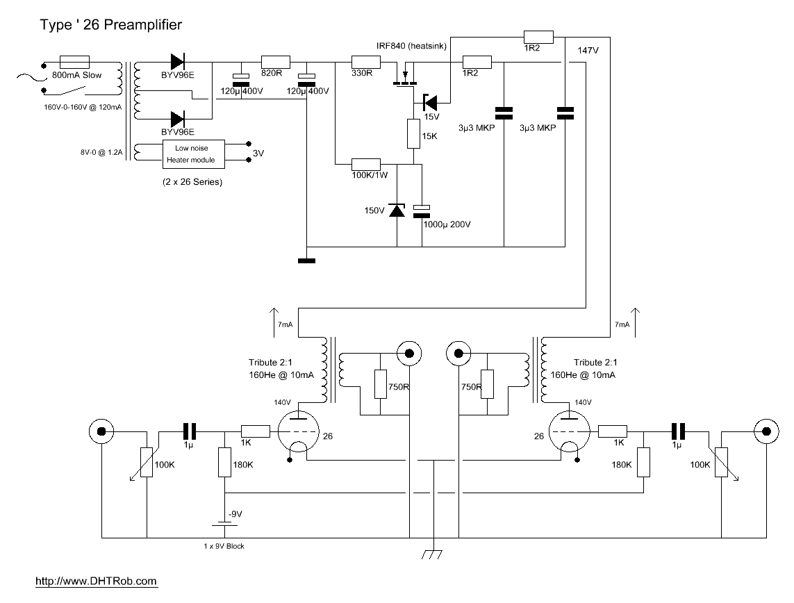

Thanks.. Some time ago I stumbled on the same challenge: Only on filament winding on power transformer but wanting to use directly heated Triodes. Following "old school" diagrams I came upon this. Since the filament is grounded, there is no (audible) noise penalty when using LM317 as current source..
For completeness of the post I attached the diagram..
Rob

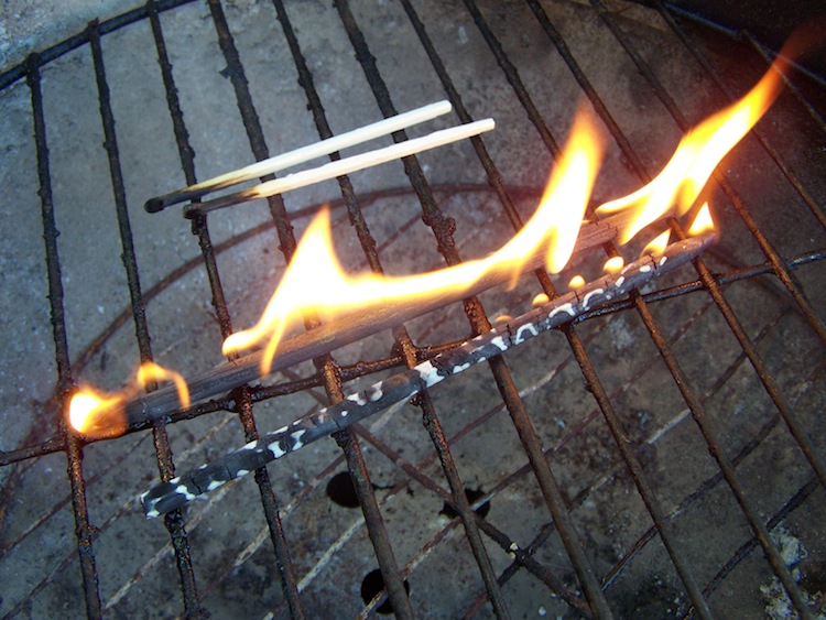

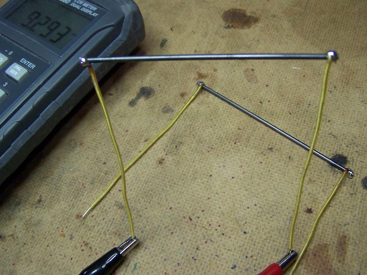

Since I am posting, also an idea for the bias resistor..
Use graphite! :)
De-wood a HB pencil and use the graphite rod as bias resistor. Sounds better to my ears than wire-wound resistors. Wattage about 10 Watts (although they can be heated until they glow bright red :D )
See for more how-to details on my site (Dutch), but pictures are more or less self-explaining..
Also on Troels site in English (I used his as reference..)
Rob

Rob, Works OK when the filament Regulator has dynamic output impedance much higher than the filaments (1.5 ohm). Crosstalk between L & R channels is degraded by leakage capacitance (or stability capacitors of voltage regulators). If you have a Turntable with a moving-coil cartridge, this high impedance must reach to 50kHz, to keep out crosstalk of scratches/defects!

Actually it was designed as a 2A3 1:2 step-up interstage. I use it in reverse.. It has excellent bandwith (up to 80khz, no saturation at low frequencies), has an amorphous core. Sound is very much okay..
Rob

There is one possibility: At ground potential you can get away with one filament supply (transformer and Coleman). Put both filaments in series, adjust for 3 Volts. Ground the filament between the two filaments, so you have one 26 at 1.5Volts and one 26 at -1.5Volts. Bias the 26 with a battery (9Volt).
I have tried this succesfully, however not exactly cathode-bias, sound is excellent.. :D
Rob

you can do this with the "Coleman" regulators, because they do not couple the + and - outputs.
But, any other heating method that has a capacitor at its output will directly mix L and R channels, (large crosstalk) so please take care.

To be honest, you got me into re-engineering the 26 preamplifier.:)
Starting of with no load is what I normally do, then implement load if response is bad. You triggered me by stating that gain was probably low. That was correct.
I tried several loads, but could not get the thing going with more gain using the Tribute IT. I than swapped the 26 for a 101D (same filament amperage) and got nice frequency response with no load..
So, diagram is useable, only a sufficient Line-out should be chosen for the 26. Then again, chances are small that someone has the same IT lying around..:D
