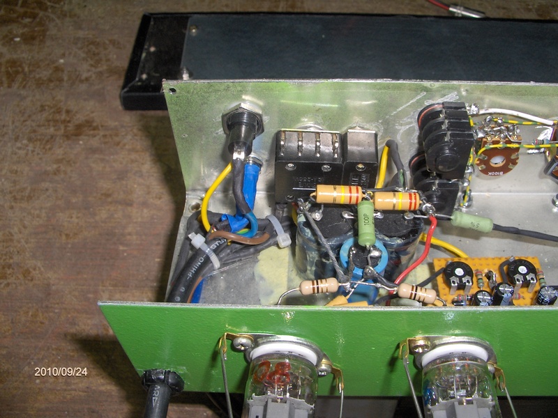

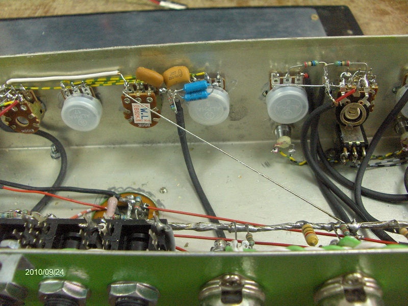

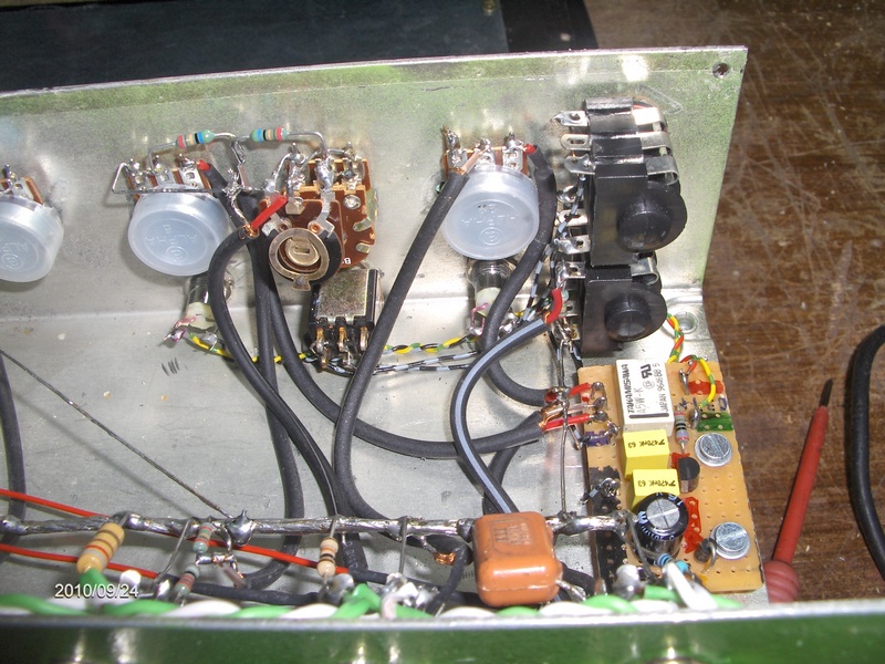

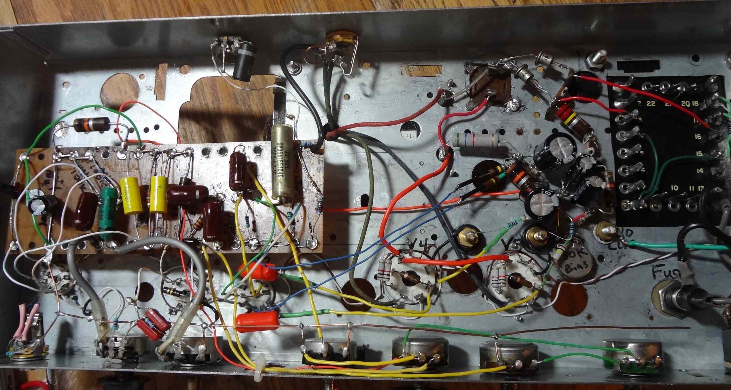

Faceplate was created with "Card Maker 2.0("Zweckform"-program), and printed with HP-DJ970Cxi (ink-jet) on common office paper (80gr.). Glue was transparent spray lacquer on chassis first, than on paper for protect color and printing.
Did it take many attempts to get the spacing right? I have the worst luck with printers and scale drawings.
I have no problems with spacing when I start with "Card Maker 2.0" program.
With some other programs I have problems with spacing, colour and contrast.
Limit is my printer with A4 maximum dimension (297x210mm), and I am planing to bay another with A3 maximum dimension of paper (420x297mm).

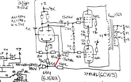

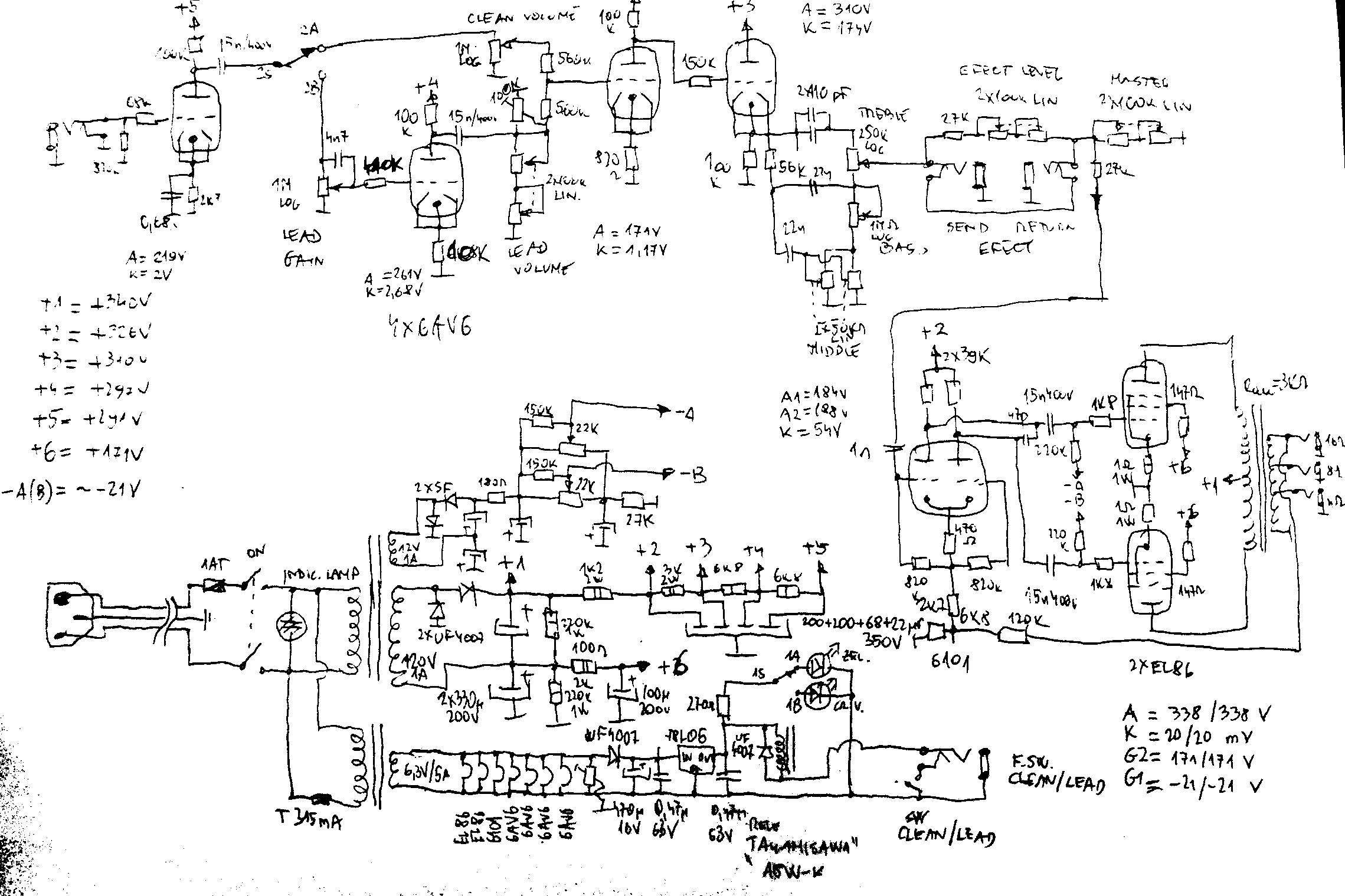

Do you have a higher resolution schematic you could post?
Very interesting! Fixed bias with individual adjustment pots. nice!
What is the PI tube?
I've got plenty of 6AV6s, and lots of premium Mullard/Amperex EL86s.
OT is 3K reflected load with 8 ohm speakers, and 25W?

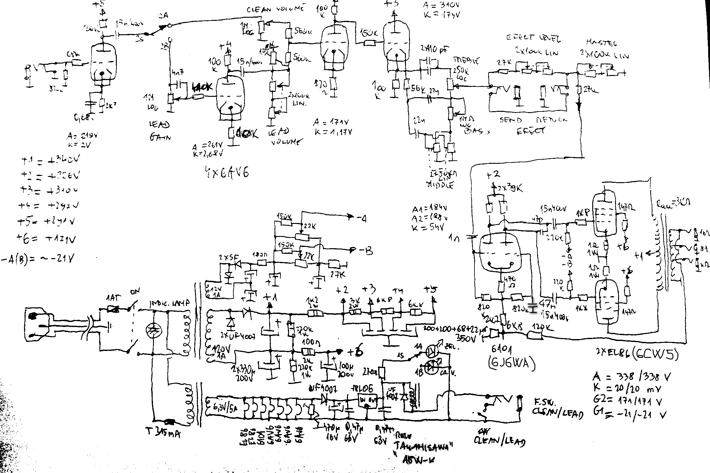

-PI tube is 6101 or 6J6WA
-Raa is 3 kOhma. Pout is nominal 25W, but maximum output power is more than 30W.
There is something wrong with drawing of the phase splitter, C missing ?
Mona
Wright! 47nF from grid tu ground! Sorry!
Isn't 340 (~300V) not a little bit to much for an EL86?.......EL86 work very well with Ua~340V (and more!) if screen voltage is low (<200V).
The 6CW5 and odd heater voltage twins will eat 350 volts on the plates if the screen is kept in the 170 to 200 volt range and 3K works too.
I have built a few amps using the 6CW5 on 340 volts with 170 volts on the screen and a 3300 ohm OPT. All have lived long lives without tube changes.
I made a "Marshall 18 Watt" clone for the Hundred Buck Amp Challenge. I am posting some of the details of the design in that thread. It ran UL84's on 340 volt and made about 30 watts at clip. The amp is somewhere in a box and hasn't been seen in over 2 years, since I moved everything 1200 miles....twice. It will be brought back to life once found.
Not like this ?Wright! 47nF from grid to ground! Sorry!

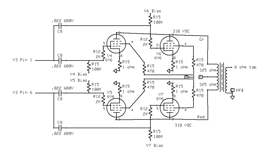

I recently built a lower voltage 6V6 Plexi. +325 B+ is what I could get out of my re-purposed Hewlett Packard PT. It sounds so good I'm now working on a Quad 6V6 Plexi with the same lower voltage PT. But with around that voltage, I've got another HP PT to use, it seems that 2 little EL86's will put out more output power than even the Quad 6V6!The 6CW5 and odd heater voltage twins will eat 350 volts on the plates if the screen is kept in the 170 to 200 volt range and 3K works too.

I'm an Army trained repair tech, not an engineer/designer (yet). So I still need help modifying a design like the Plexi to use these EL86s as output tubes. If you guys wouldn't mind helping me do that I would be very grateful.
I've got 18+ premium Mullard (Gt Brittan) Amperex (Holland) RCA (? GB/H???) to put to good use.

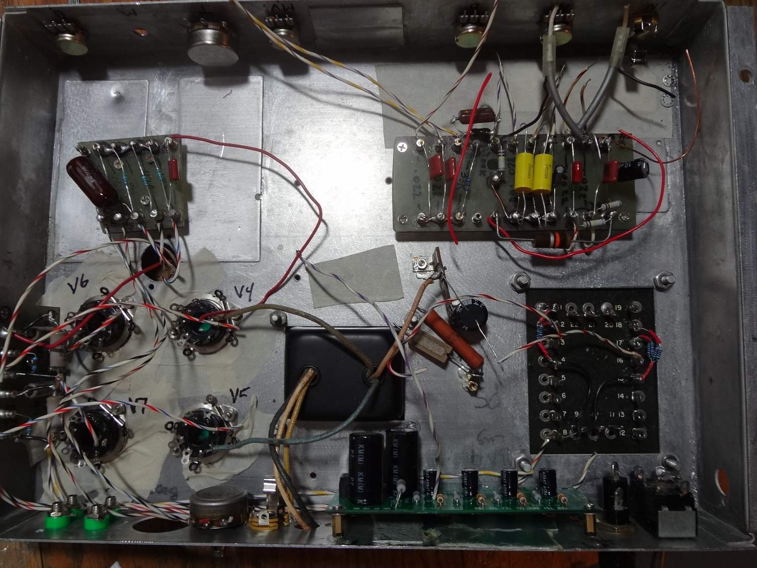

Here's a pic of the 1st Plexi's guts, and the mock up of the quad's guts.
I'm almost ready to wire the Quad up.
I hope to finish it before the end of the month.
I was going to do a different design build after that.
Now I think I want to stick with the Plexi, but an EL86 Plexi this time.
