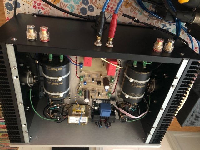

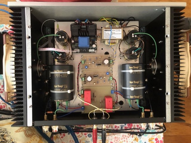

Most class A designs are heavy by default due to their inefficiency. My example of Ben's original design for this amp weighs around 36kg. Its a solid workout for me to move it from workshop bench to listening room. I used a Modushop 4U/300 case partitioned horizontally using 3mm plate aluminum. Meanwell LRS150 SMPS's, Hammond 159ZJ chokes (for CLC), Hammond 195T5 chokes and AC wiring on lower level. PCB's, soft start module, bias supply transformer, filter and output caps on top level. Using a matched pair of THF51S instead of 2SK180. Vds 35V, Iq 2.5A. Sound is sublime at this operating point. I've recently added a pair of Noctua 200mm fans to both heatsinks. They run quite slowly on about 9V which provides sufficient forced air to keep the entire chassis and heatsinks close to ambient temperature, even in hot Australian summer, and are virtually silent. Modifications in progress are change to Ben's new PCB's with negative Vcc. A few photos follow.Yes it will be heavy but I’m trying to make it as compact as possible. AND still keep it silent & cool

The SMPSs saved you a bit of weight. Imagine the weight with two large power transformers.

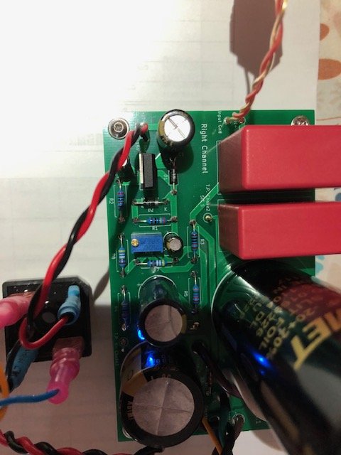

I have rebuilt the amp using your new design and PCB. With both main and bias PS's connected but without SIT in circuit, all appears OK. Voltages are roughly where they should be according to the schematic, bias voltage is adjustable and LED is on. When SIT is connected (with bias adjustment trimmer fully counter clockwise), the main PS (SMPS) goes into hiccup mode, which indicates a direct short circuit across its output. My interpretation of this is that there is zero resistance between source and drain of the SIT. Would this be correct? I have checked and rechecked all component values (including the SIT) and their placement on the PCB's as well as external wiring and connections. The strange thing is, I have been using this SMPS in your earlier design (+Vcc) for almost a year with same SIT (THF51S) and choke without any issues. I have also used it without problems in a MOSFET source follower design (Power Follower 2021 by Andrea Cuffoli), which uses -Vcc. That is, the SMPS works with both grounded negative and grounded positive designs. As noted in my previous post, I'm using a Hammond 195T5 choke which has a nominal DC resistance of 0.64 ohms (measures 0.61) which is quite a bit lower than the 193V. The only possible causes of this problem I can think of are differences between the 2SK180 vs THF51S, and 193V vs 195T5, and their interactions in this design. I have ordered a 193V to eliminate one variable, but I'm not entirely convinced the difference between them is the source of the problem. Any thoughts or comments would be very welcome.
Meanwell ENP Desktop SMPS looks like an alternative to a PS built in to the amp chassis ie. an external PS. I'm using Meanwell LRS-150-36 (one per channel) which are small enough to fit inside the Modushop amp chassis. They are nominally 150W and 36V with adjustment from 32 to 39V, which is ideal for fine tuning this amp.
Ben
Other things you can check:
1. With no SIT connected, power up and measure Vg at the trimmer min and max settings. Also measure Vs. All voltages relative to ground.
2. Check you SIT :
The 195T5 or THF-51S should not cause any major issues. If the circuit is operating as it should, the only problem that I can see is that if your SIT needs a very high Vgs to shut down. The circuit as is should be capable of a maximum Vgs of about -9.5V or so. That should take care of most Tokins.

Thanks for your reply and suggestions.
I think trimmer orientation is correct (see photo below).
Check of SIT with multimeter (Ohms range) confirmed results as above, so probably safe to assume it is OK.
Results of suggested voltage checks (Vcc = -37.5V):
Vg (maximum counter clockwise) = -39.13V
Vg (maximum clockwise) = -37.15V
Vs = -37.5V
Vgs SIT not connected: maximum counter clockwise = -1.63V (negative probe on source)
Vgs SIT not connected: maximum clockwise = +0.35V (negative probe on source)
Raw bias DC voltage (from rectifier) = 20.85V
![IMG_0534.jpg IMG_0534.jpg](https://www.diyaudio.com/community/data/attachments/1087/1087672-9f6cbcdcdbdeb220da929530730744ef.jpg)

There is a problem with the bias supply. Vg max should be about -46.5V.
Disconnect the V- power supply, no SIT installed, power up the bias supply, and check Vg. As mentioned previously, Vg max should be about -9.5V (without V- power supply).
Check resistor values in LM317 bias circuit, especially R1, R2 (240, 2k) and R7, R8 (5k,5k).
