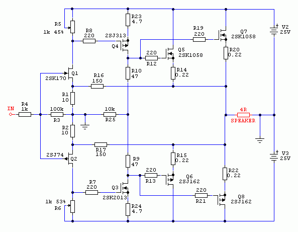

Laterals don't need that kind of stabilisation when there's only one pair per channel. For multiple pairs I use Source resistors to prevent current hogging. Some people advocate that even in that situation Source resistors are not needed because of their NTC. My experience is that NTC has it's limits in practical circuit and one can't rely on it to solve all the problems.
Since this amp has simple biasing procedure (just one pot to set) it's easy to have different bias settings - 1.3A in winter and the half of that during the summer (in regions with very high summer temperatures). The sonic difference is subtle if you don't play it to the max very often but dissipated heat is much lower.

Hello JUMA
You have the another amplifier all mosfet amp. I attache the schematic. Hopefully soon I power up that.
I have a question, If the power mosfets are close matched can I leave out the 0R22 Source resistors.
Do you think those resistor has any effect on the sound ?
If not I can use them even do my power mosfets are well matched.
Your design I would be interested on your opinion.
Thank you
Greetings Gabor :)

... to elaborate on this retro-tech circuit.ie. setup and any other vital info....
Hi Sandy,
I think I got it pretty much covered in post #1 :)
This is an experimenter's amp - you can try changing the current through Q1 and Q2 (i.e. their gains). Also, changing the capacitor types (especially at the output/feedback loop) gives different sonic results. Just take your time and find out what you like... ;)
