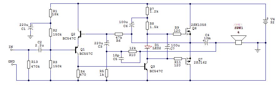

Could you please tell, what is the role of transistor Q3?Hi Skorpio,
I tested your 2-loops idea and it brings some improvement indeed
I also changed the input device into N-JFET which made some other changes necessary and the whole thing now looks like this (and sounds somewhat better)
Please don't ask me about parts substitutes, power increase or to compare it with other amps/designs....
The input FET Q1 has already have a cascode Q2. Seems like Q3 is taking the feedback current as input and giving its output to FET Q1, but not very clear what is the function of Q3 here.
Q3 is a part of so called Rush cascode, together with Q1. Its base is a feedback node transfered via Q3's emitter to Q1's source - similar to mechanism more often seen in LTP.
Q2 is a standard cascode and besides linearisation of the input stage it has a task to provide low Vds for Q1 in order to avoid gate leakage in Q1 so we can have high Zin (R2 || R1).
You can read more about Rush cascode elsewhere - there are numerous threads about it on this forum too.
Maybe it is clearer if drawn this way (BJT PNP input, "normal polarity" PSU).

The Rush cascode converts the input stage to an ugly differential amplifier. Gate leakage is not reduced, nothing is linearized, instead instability and high distortion introduced. The topology using two single ended stages is realizable without any capacitors, other than an output capacitor.

If I wanted to tune down the gain in this circuit would I increase R8 or decrease R9? I am looking for something like 14V/V.
I presume R10=100k is the smallest you can get away with to have enough base current for Q3 so better not touch it?
I don't get how R11/R12 work. Would they need to be adjusted for different gain?
Thx, understood.
Can you shed some light how you dimensioned R11, R12?
I understand that the sum sets the collector current of Q4.
Other references I found split the total collector resistance evenly to attach the bootstrap capacitor. You use different values, is there something to learn from this?
