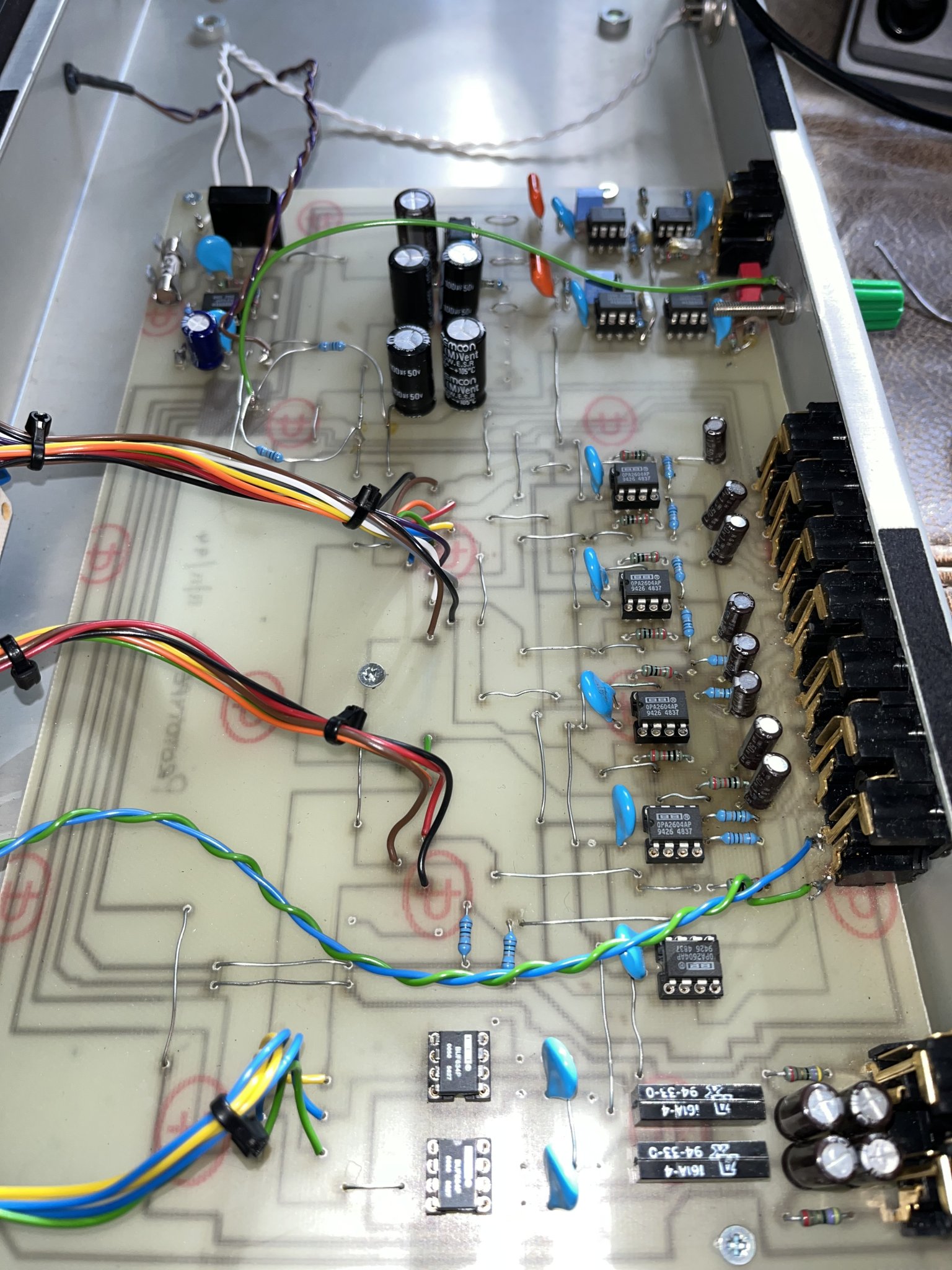

Without opening it up again to look I’d say 25mm x 10/12mm .Dimensions would help...
Bottom right in photo ( of course I can open it up again if needed)
They are at the preamp output RCA’sAre theese back to back input coupling capacitors? Close proximity to what appears to be some in/output
Uou could replace each pair with one Nichicon Muse bipolar capacitor. (audio grade).
25uf is amight big value for a coupling capacitor. What is it driving: must be quite low impedance.

Two 25uF caps in series is equivalent to 12.5uF, not 50uF. Personally, I would just throw a 50V 22uF Muse on each output. You can argue they aren't as good as film, but they're surely better than what's in there.

For coupling audio circuits together (not power supply de-coupling), a quality bi-polar electrolytic scaled correctly will work just as well as a polypropylene cap in that application. The afore mentioned Nichicon Muse work very well for coupling applications...when scaled correctly.

No need for 100v ones either I expect. 50v should be mroe than adequate.
