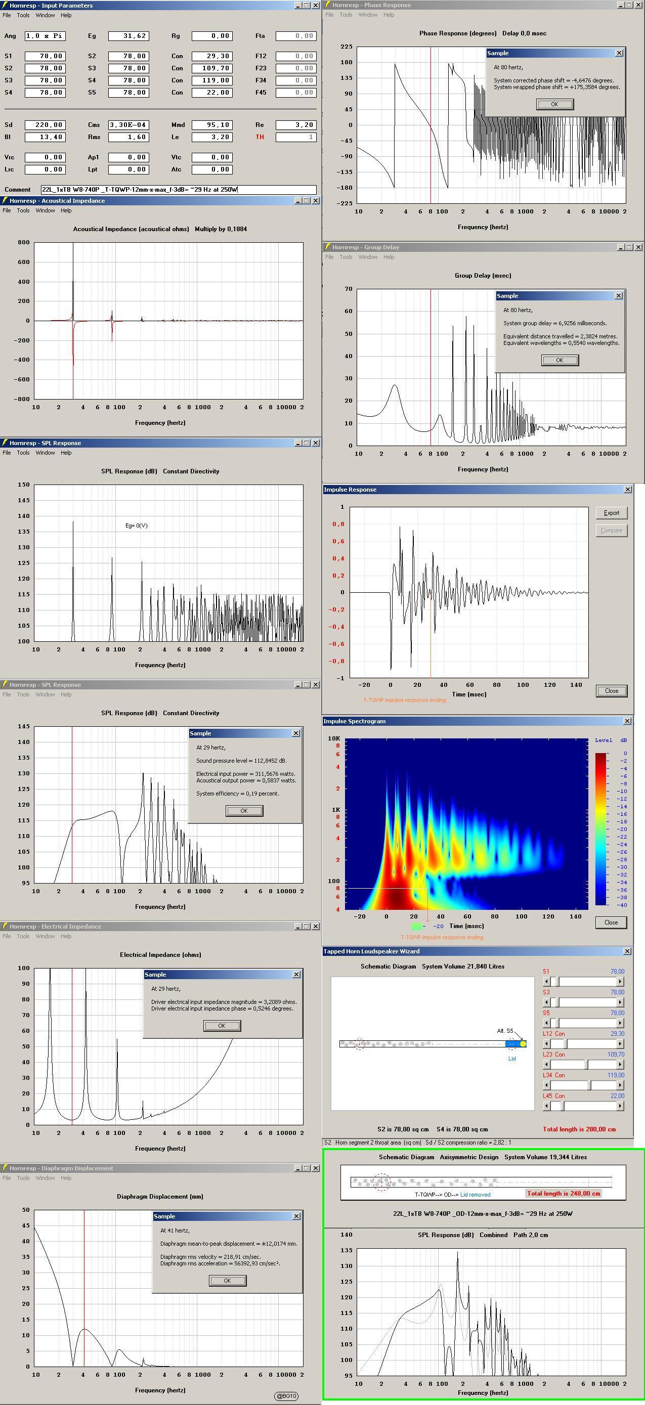

Hi david,
If the TB- W8-740 is to be used at about 105 dB average SPL ( 10 dB headroom),I would choose an easy folded stuffed T-TQWP: No in-band Gldy ripple and much lower FR ripple above 80 Hz that a TH version would produce, IMO = superior SQ is secured: See the picture.
b:magnify:
djk this looks pretty impressive on paper especially for such a small system volume. Depending on the folding this could be small enough to fit in a corner in my room. What would it look like in 2.0 pi environment just so i can compare to other designs?
Bjorno I'm not too too familiar with T-TQWP but I assume that would be a relatively easy build? What are the main advantages over tapped horns? Also what dimensions would I be looking at? they seem fairly small which is a good thing... ;)

I found the T-TQWP design interesting when I first saw it as well - thanks for bumping the thread since I had forgotten about it.
bjorno (or anyone else with experience with these) is this really a practical design? the cross-section is basically a square tube 3.5 inches per side - is this viable with a fairly beefy 8" driver? I'm not even sure how you'd construct such a thing, and would think at the very least that a front chamber/rear chamber might have to be modeled.
Also, would a T-TQWP be stuffed, or just lined like a conventional TH?
Is it a coincidence that the F3 is very close to Fs for the driver? Most TH designs are ~0.5 octaves down from Fs.
Definitely a very interesting design if it can be made to work.

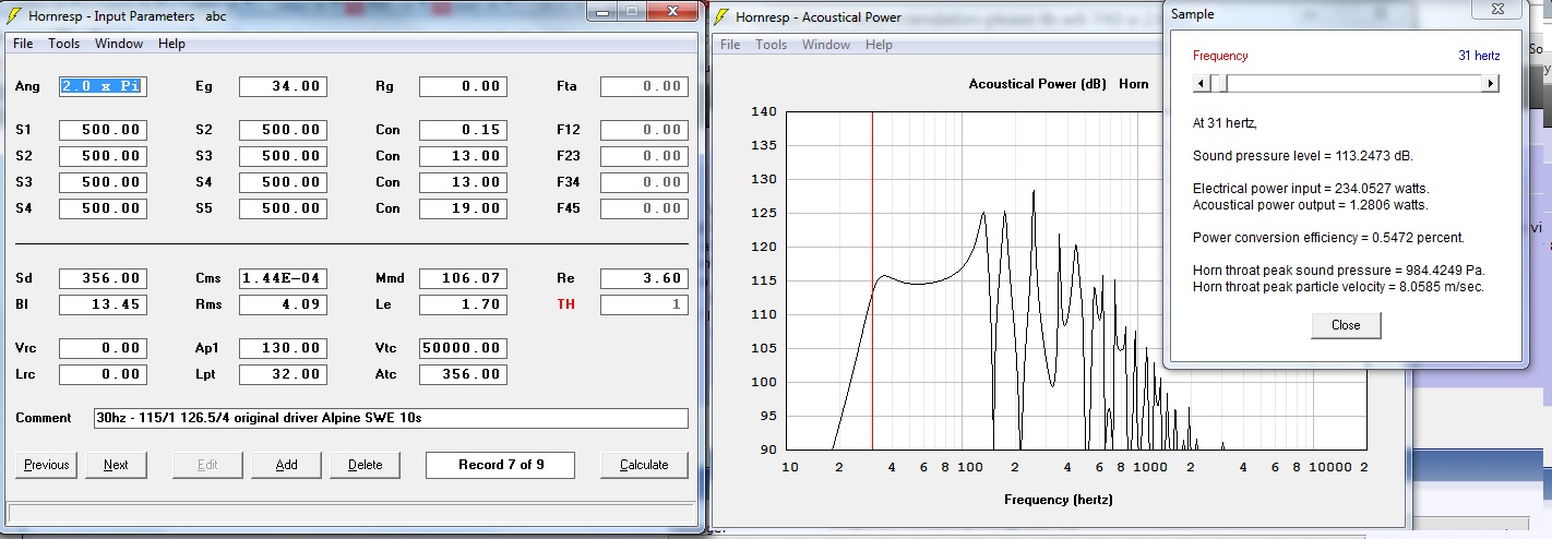

More design ideas, 114 dB free space max output to 31
Here is a 10 inch driven 250 watt design that I've been modifying (adjusted from a 40 Hz TH pipe to a 31 Hz one) that should do 114-115 from 31-90 +-2 dB with no added inductors. The driver is 50 bucks free shipping see Alpine Type-E Subwoofer SWE-10S4*| Creative Car Audio
see this forum thread for the original design (I am basically stretching it wider and taller to make the hornresp numbers correct). Should be roughly 3.5 cu. ft standing on end with a foot print of roughly 14x14inches. http://www.diyaudio.com/forums/subwoofers/259509-new-sub-design-constricted-transflex-simple-build-series-tuned-6th-order-3.html
