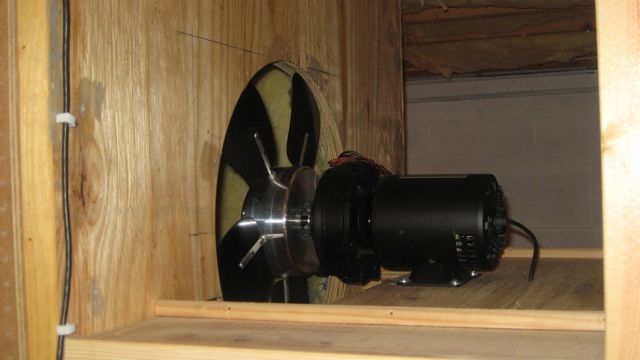

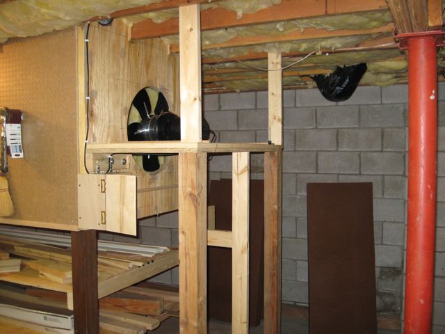

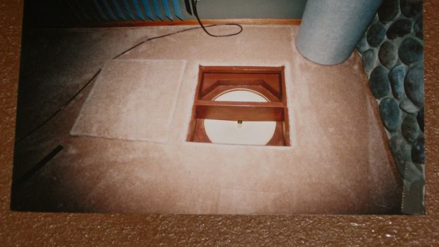

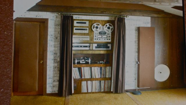

I found that the best enclosure for the Hartleys is an
infinite baffle. I originally used a very large closet
for my first Hartley, but later I mounted the woofers
in the floor, using the basement as a infinite baffle.
I also used a Velodyne subwoofer management
system using a 40 hz xover and cutting the bass off
at 15 hz, for protection (necessary in a infinite baffle
to limit excursions below 15 hz. They worked very
well, but now I use a Eminent Technology rotary
subwoofer and the difference is like night and day.
The rotary subwoofer goes to below 1 hz and one
does not need any protection.
I have a pair of 12" Pioners under the floor, in a concrete horn that opens to the room. ;)
