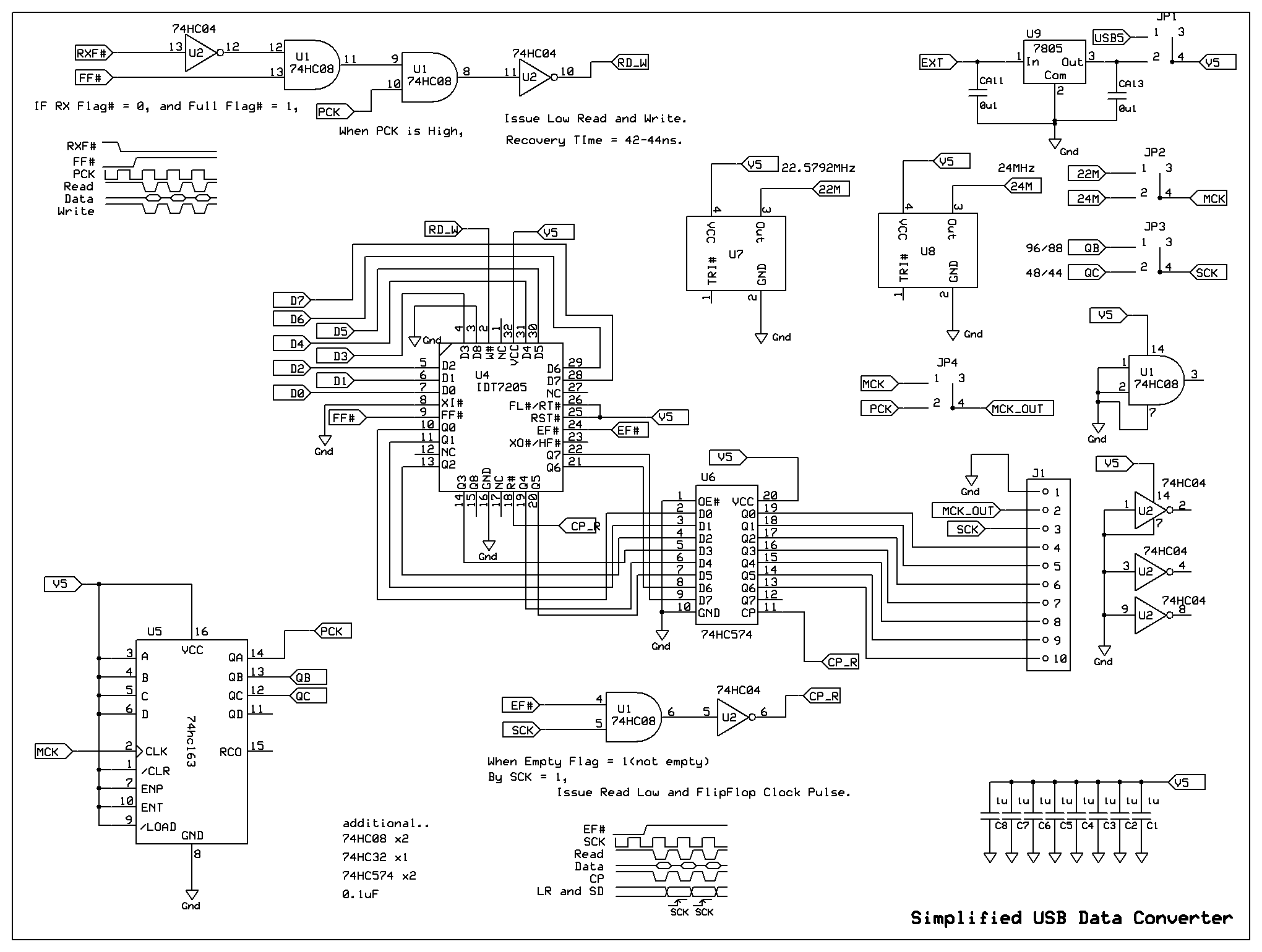

Attached, Schematic for Simplified USB DDC.
UM232H - IDT FIFO - 4 of 74HC, Clock, Power.
This is Manually Clock Control version.
By some Pin control + Multiplexer, clock can be controlled.
PCK is, 4x faster than SCLK, so FIFO is filled faster than consumed.
When FIFO empty,
(a) Stop both CP and Read: LRCK, SD, both freeze. <- I do this. DAC will stop.
(b) Stop Read, Run CP: LRCK runs but SD keep same data. 111111.. or 000000...
in any case, it's safe for I2S PCM signal (=-1, = 0). but DAC runs.
(c) Stop CP, Run Read: same as (a) for outside DAC.
(d) ignore EMPTY: causes invalid read, LRCK runs and SD will be 111111...
This will be dangerous?

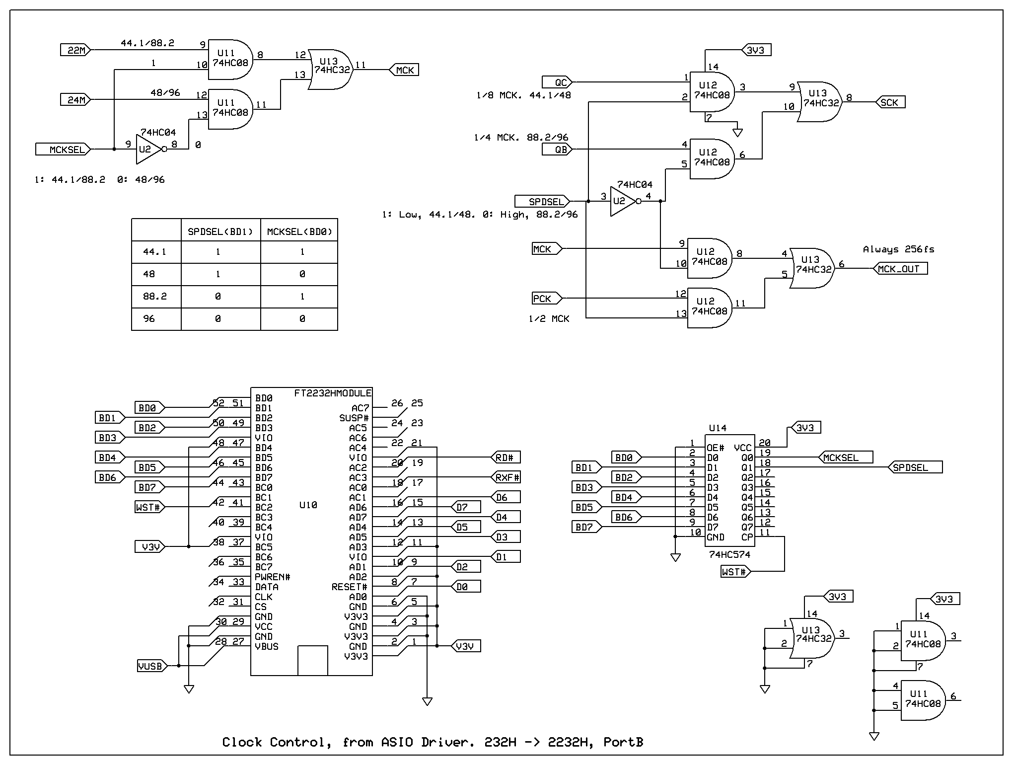

74HC163 output is wrong,,,
MCK: 22M or 24M
QA = PCK: 11M or 12M
QB = 88.2 or 96, 1/4 MCK = 5.6M or 6M (256fs)
QC = 44.1 or 48, 1/8 MCK = 2.8M or 3M (512fs)
Attached Schematic, to control Clock from host.

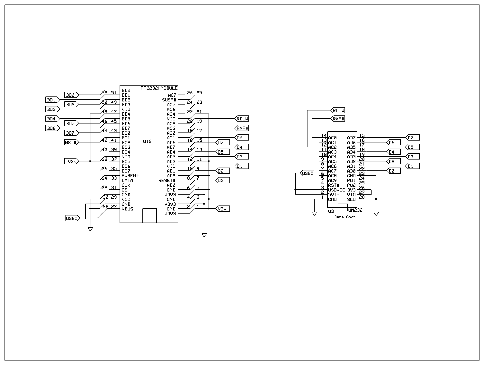

In this case UM2232H is required, PortB controls the clock selector.
I found IDT 72V05 (3.3V) has less inventory than 7205, 7206.. (5V)
and precision Clocks on eBay are 5V driven.
This circuit uses 74HC, so easy to change whole voltage to 5V.
UM2232H is 5V tolerant. FYI.

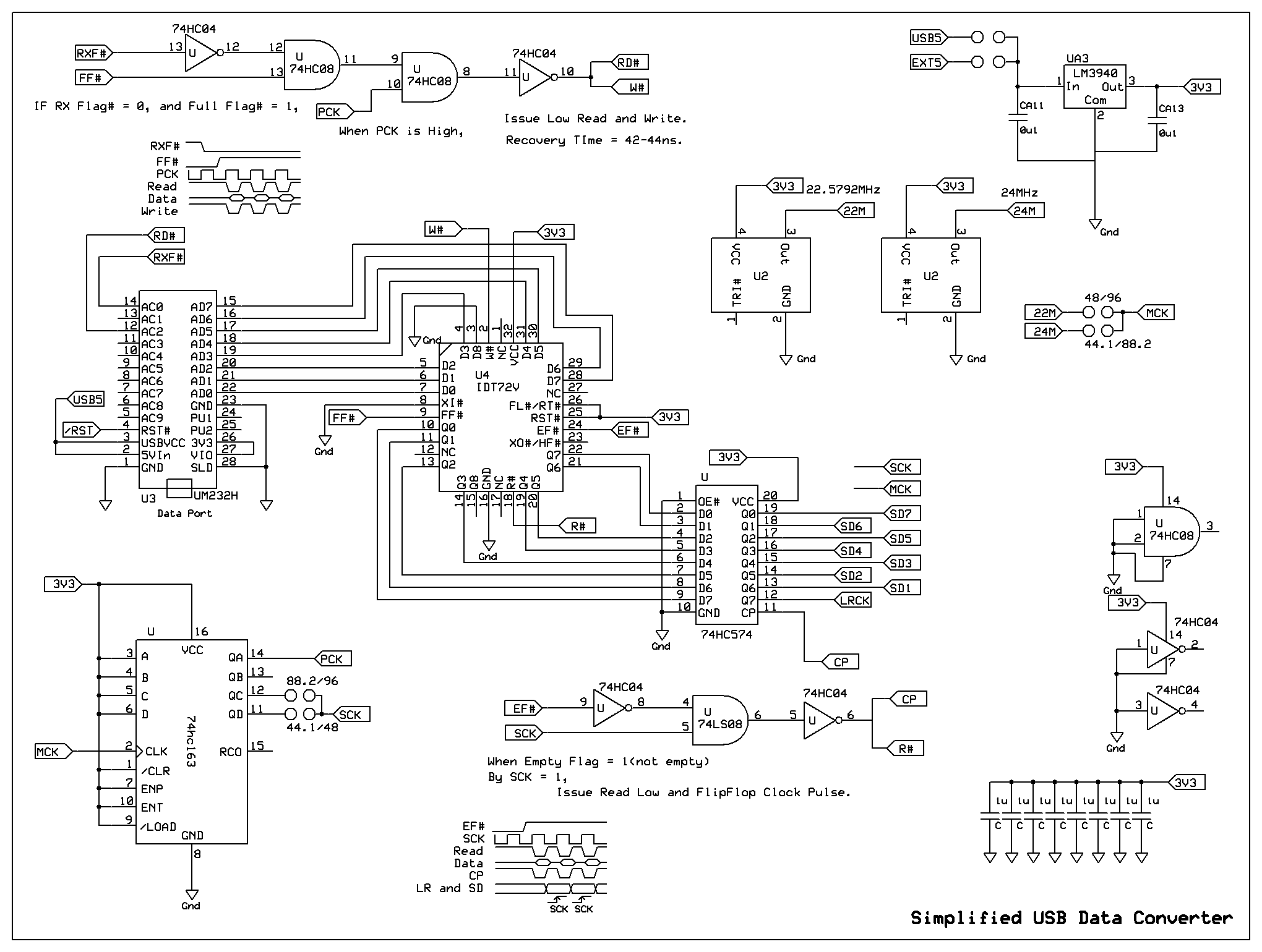

Here is simplified USB Digital converter, only usses FTDI + FIFO + DIP devices.
Parallel - Serial conversion is done in source code.
Code:
			//LRCK = 1, RH
			LRCK = 0x01;
			for (int k = 0; k < 8; k++) {
				ch12 = (RH>>(7-k))&0x01;
				*(pSend + j*64 + 33 + k) = LRCK | (ch12<<1);
test program only uses Bit 0 (LRCK) and Bit 1 (Channel 1/2).
By this serialization (pick 1 bit from PCM data, and assign to send buffer)..
Code:
Bit 0:
0000000000000000000000000000000011111111111111111111111111111111
Bit 1:
0LLLLLLLLLLLLLLLL0000000000000000RRRRRRRRRRRRRRRR0000000000000000
This byte stream can be sent to I2S directly.
This source code is only for functional test, under CPU load there is dropping.
To use this USB DDC, multi threaded ASIO driver should be required.

Also, what software do you use for your schematic drawings?
