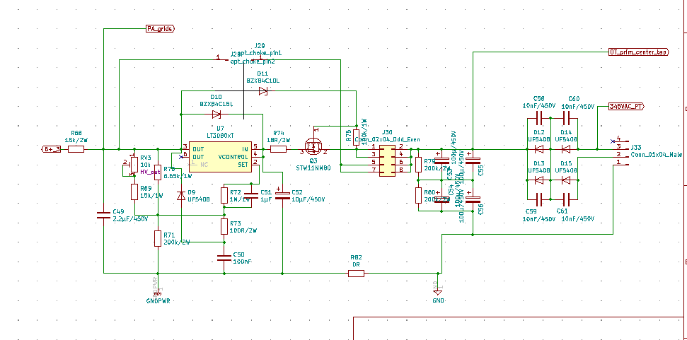

Hi Tom,
first off: thanks for providing the circuit for DIY!
I built a modified version as in posts by cpaul on page 15ff of this thread. So basically the design you tested there and ran sim in LTspice before. Seems working good, Vout 400VDC.
However, in reality I have only 230 V unregulated and the voltage at the input is pulled down to this point (without the regulator connected I have nice 450V at the filter cap just right before the regulator). The MOS is still fine, cannot see something is heating up or anything weird.
Do you have something like most-common-mistakes when building these?
Thanks for some hints if you have...
Cheers
Gunnar

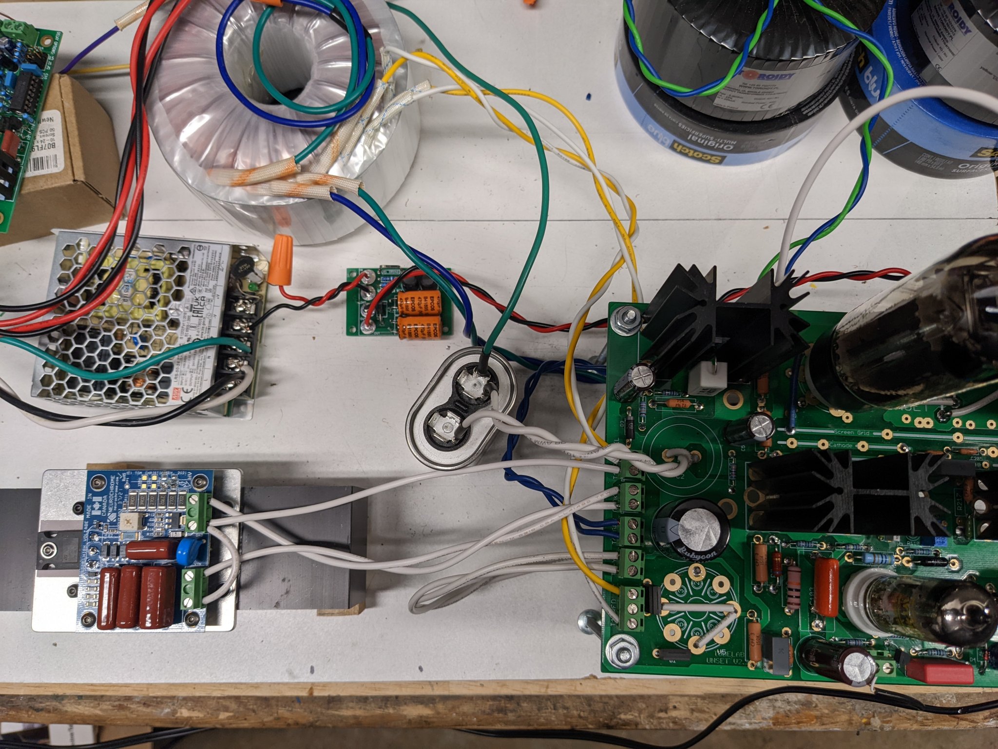

Hi Tom. I am using your maida regulator to replace the choke in one of George's UNSET beta boards. On my REW output I am seeing a spike in the 120Hz range that I am trying to reduce. Other than the 120Hz spike everything else seems to work fine with the regulator, V in is 465V and V out is set at 425V and remains stable. Attached is a pic of how I have it wired in. The off board cap in the pic is a 10uF on the output of the regulator and the green wire coming off it is the connection to ground. Do you see anything in my setup with the regulator that would be a likely cause of the hum?

What would be the latest scheme do use for DIY? I see some have made their own modifications.
Some use transistor ZTX450. What is the function of this transistor and how it affects this regulator?
I would be very happy if someone could share their final working controlled stable HV regulator with low noise and very low PSRR in audible Hz range.
