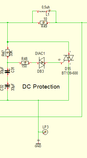

Hello,
I not reading this thread to much pages
how about protection about this amp ?
Short circuit
Overloading
Clip
DC like triac crowbar if device fails ?
any amp > 30V Rail should have DC protect to protect speaker from amplifier device fails
This is important, because this amp running with high rails
I lost my speaker long time ago after an amplifier fails and DC OUT full rail kill very quick my HI-FI speaker before relay can disconect
never lost any speaker again after add this circuit

Hello,
Short circuit
Overloading
Clip

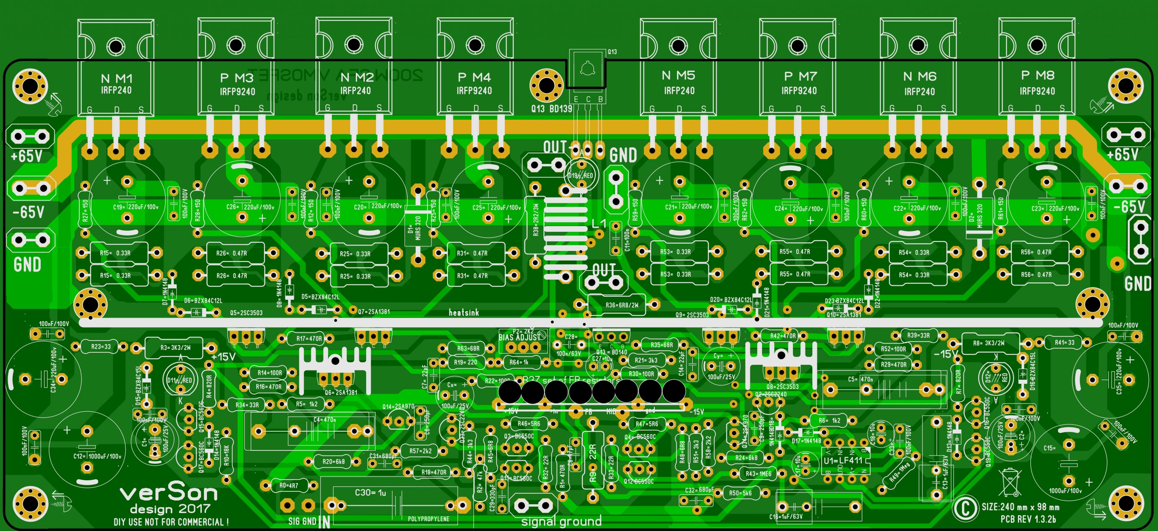

BOM attached.
PCB photo view attached.
  • 200W-CFA-VMOSFET-BOM-1.3.2-balanced ready.txt
