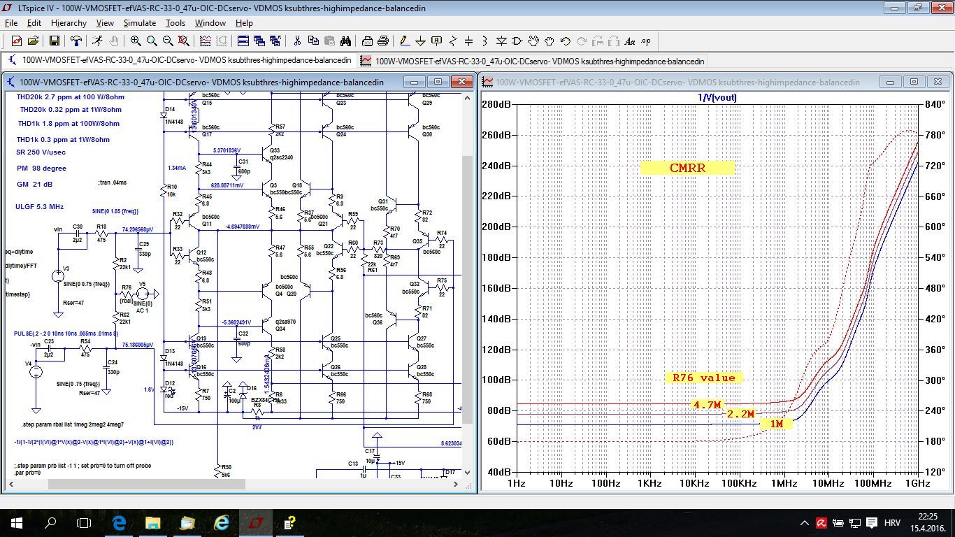

My CFA amp with balanced inputs does not use additional op amps converters(like instrumentation amplifier) but has built in discrete balanced inputs. Adding op amp balanced converter will increase distortion and I prefer to do that as the amp part.
Attached simulated CMRR dependent of the R76 value.
It's important to use 0.1% metal resistor in the input R18, R54, R2, R62.
comment --- to have a balanced Z input also requires the source and the cable/interface to be as well balanced. You wont find a twin pair cable wound to such precision (0.1%). Nor the bal output Z. So, some where there is needed a 'system' trim of R/C for best CMR. This is typically done at the Ips.
THx-RNMarsh
Thank you Richard for your comment.
For most domestic use one does not need balanced inputs and in this case there two possibility with this amp and the layout presented, pure CFA mode or VFA with higher impedance feedback network.

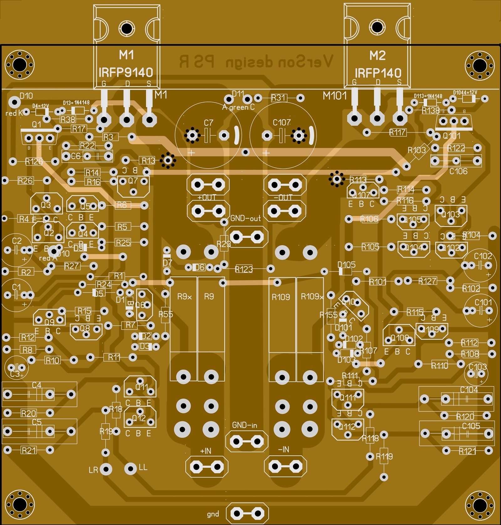

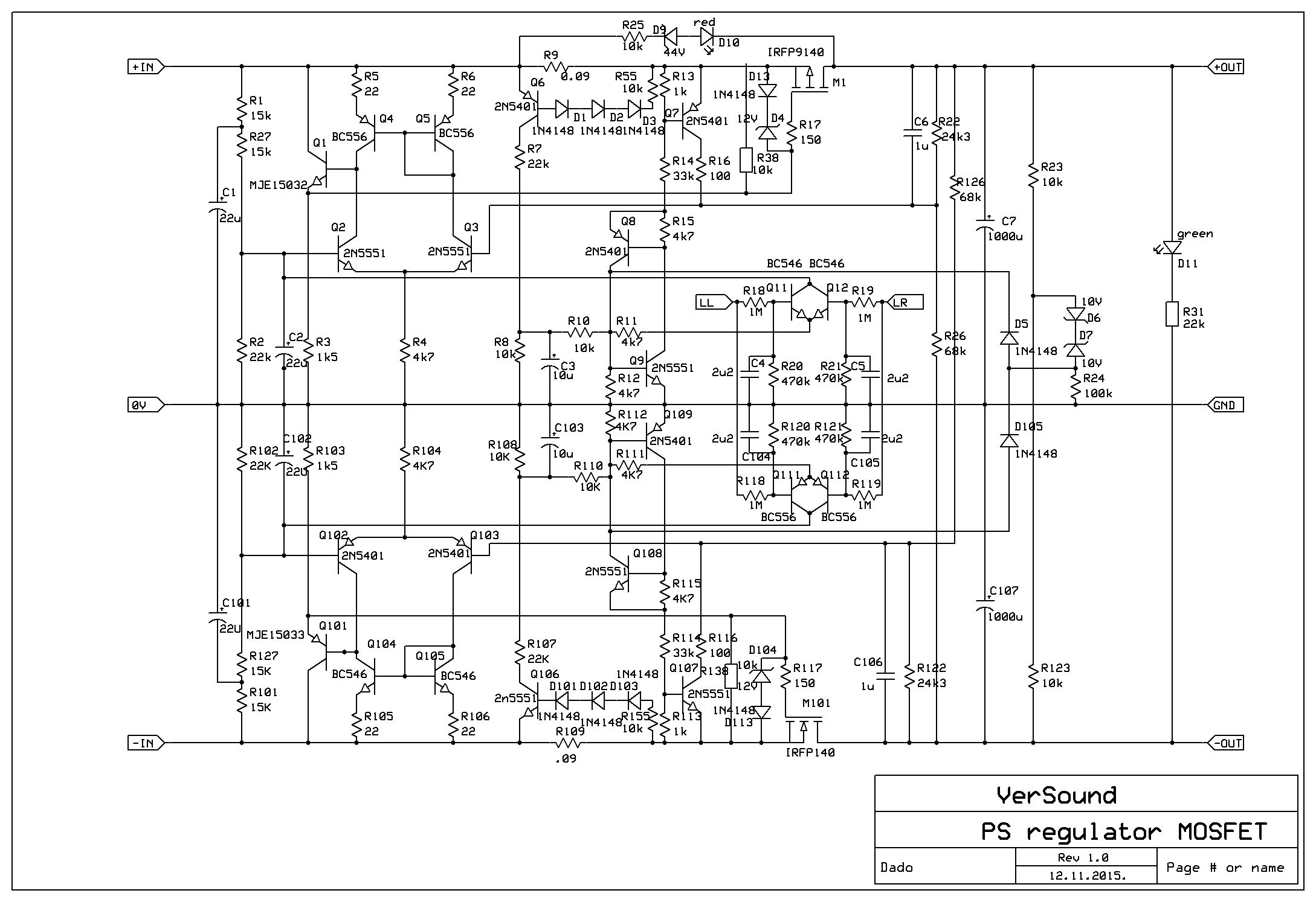

This PS regulator (acting as a capacitance multiplier) could be used with 200 W amp version. It provide, except cap multiplying, overcurrent protection and detect DC on the output and switch off the power.

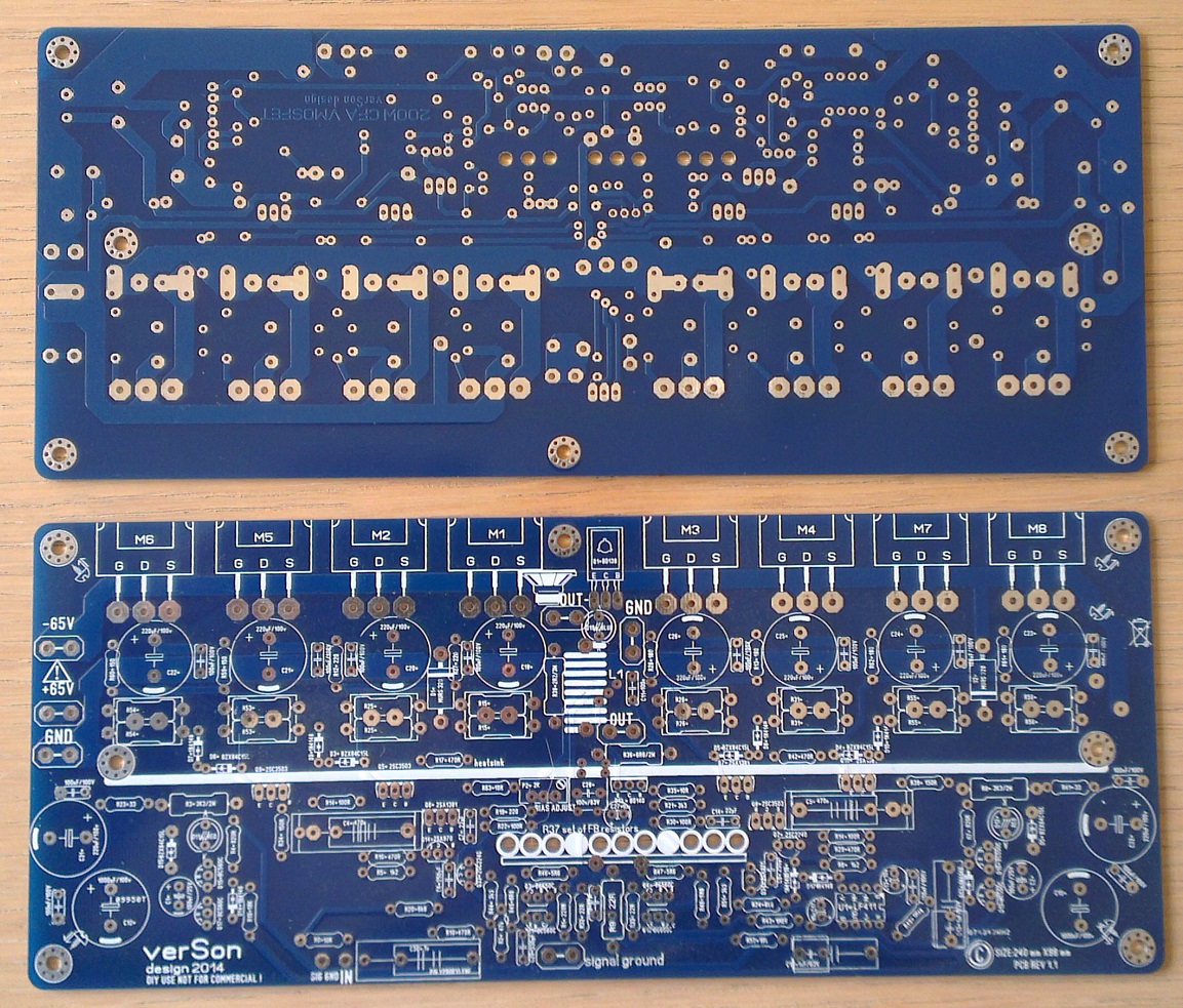

I still have two 200W CFA boards, look here: http://www.diyaudio.com/forums/solid-state/243481-200w-mosfet-cfa-amp-74.html#post4271136 , if somebody wants to build this 200W version I can offer those two boards for 30 EUR per board plus shipping.

Nobody interested?
It passed some time and I hope that some of you who bought the boards finished the amp. I appreciate very much your listening impression, measurement if done, the amp photos, suggestions, complains ...
I have some information from others, not many, and would like to hear more.
Thanks, Damir
