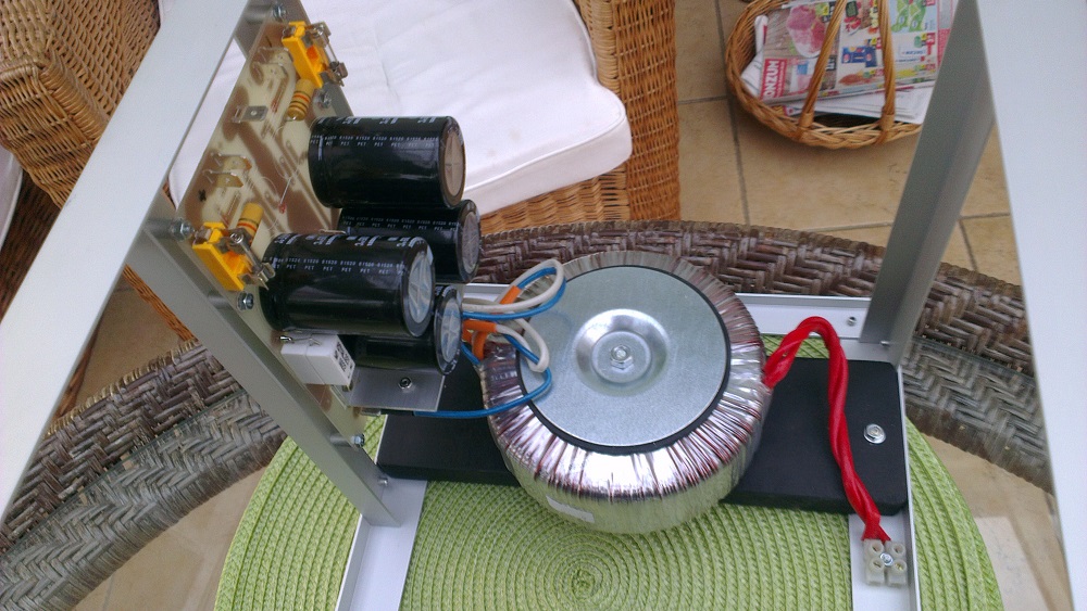

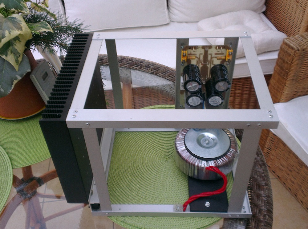

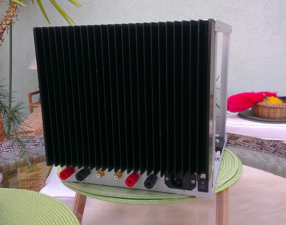

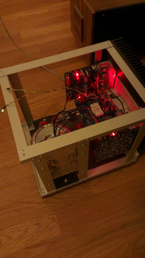

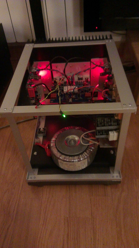

I used this one.
Looks great! Especially in "Big Boy" enclosure Are you using a single regulator board for both side? What's your listening impressions? Are there PCB's available?
Thank You
Yes, I am using a single regulator boards, and it's to early to talk about listening impression, so far so good.
