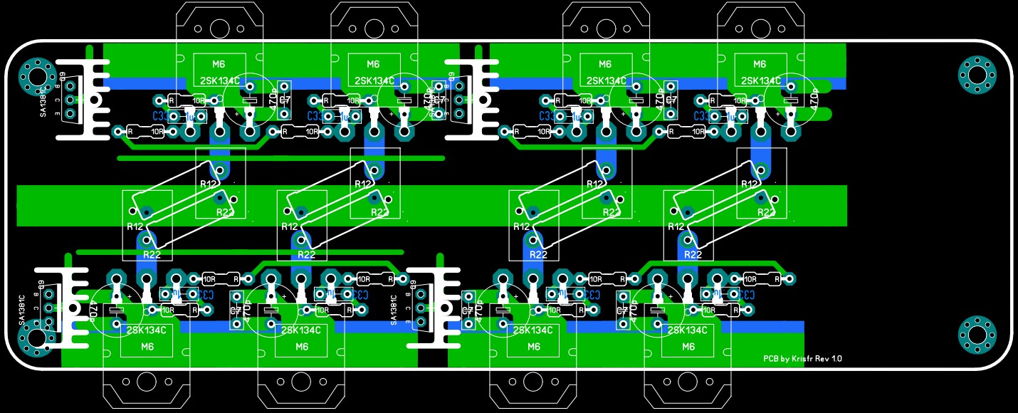

Assumption is the green traces are on the back/solder side, components are mounted on the top side.
Would have to be, how are you to solder under components, like the trim pots for example, if the traces are on the top side!
I have seen many layouts, in that the zobel network return path to the common point ground, use a separate conductor and not use the same return path, as the big filter caps occupy.
Why is it only a single sided pcb? Is there a cost advantage or are you making it yourself? I see that the mounting holes show like they have a via ring around them, why is that, when it is a single sided pcb?
What method is used for the Power bjt attachment to the heatsink?Are they mounted on the backside, but shown on the top silk/assembly.
ecap polarity symbol (+), on the top silk screen layer, should be on the outside of the circle. That way you can see orientation(inspection) when the component is soldered into place.
Not sure if the graphics represent the top silk scrwen layer or the top assembly layer or are they the same? Looks to be silk, so you really don't want the component to hide the silk info. Silk is used for both assembly and troubleshooting.
Add copyright and date.
The component placement looks very good, thus makes a nice layout.

Is this a acceptable layout...
As I already commented, I think there are reasons to use a wider layout with the OPS all on one side.
Any reason not to use such a layout?

On the PCB from post #180 it looks like all the OPS on one side would make the board no wider any way.
I understand habits to do it one way but I think the "across" the symmetry axis is a little better for thermal and layout.

I do not believe that it is a good idea to put the output resistor inside of the output inductor.
Are those disconnected copper "islands", at the top and bottom, under the leftmost output devices? You don't want any free-floating copper that isn't connected to anything.
I know that the following will seem to be "off the wall". But the caps that feed the output devices are directly providing the current that makes the music come out of the speakers. They ARE the signal path. (See the link in my signature section, below!)
Trace inductance, and therefore trace length between the caps and where the fast-changing high currents will be needed, is your enemy.
Instead of two big (10000uF) caps, it would give lower impedance to use smaller values in parallel, such as 2x 4700uF, or 3x 3300uF, or 5x 2200uF, or 10x 1000uF. (It might also be nice if you could star the output devices wrt the big cap, or star the power and ground rails to each device plus give each one its own 2200 uF or larger cap, plus some smaller ones.)
How were the 22uF values calculated, for the decoupling caps near each output device? I would use the largest value that can be squeezed in (certainly the largest value in that case size), or, even better, add a larger value in addition to the 22 uF (220 uF to 1000 uF), or, better yet, multiple smaller values in parallel. I know, you're out of space. But these could affect the transient response and imaging accuracy.
And the 100 nF caps are very far away from even the closest driver's collector pin! There should be one for each collector pin, right AT the pin if possible. A few extra millimeters from the pin can make a difference. They need to be very close, for HF stability. At high frequencies, the inductance of more than a centimeter (or probably much less) of PCB trace makes them almost totally useless.

Would making a front end and separate OPS board be a prudent objective? Since the ground and voltages would be different anyway. Something like OStriper would do or did do. Then I could make a "Beast" similar to what he is doing on the GLA.
I was going to suggest that, too. It would also provide better layout possibilities.
I have a little concern about the gate protection zener diodes that, in an unfortunate event of output being shorted to GND, there could be large current going through them as well as through the driver transistors that may result in these devices being driven beyond their maximum limits and getting destroyed. Could this be a real issue?
