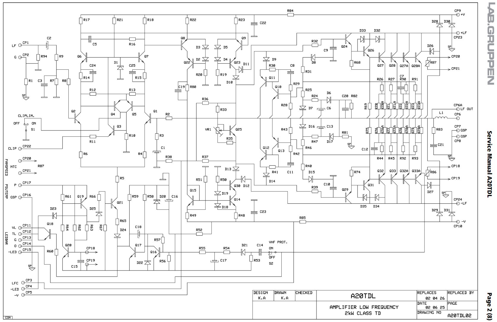

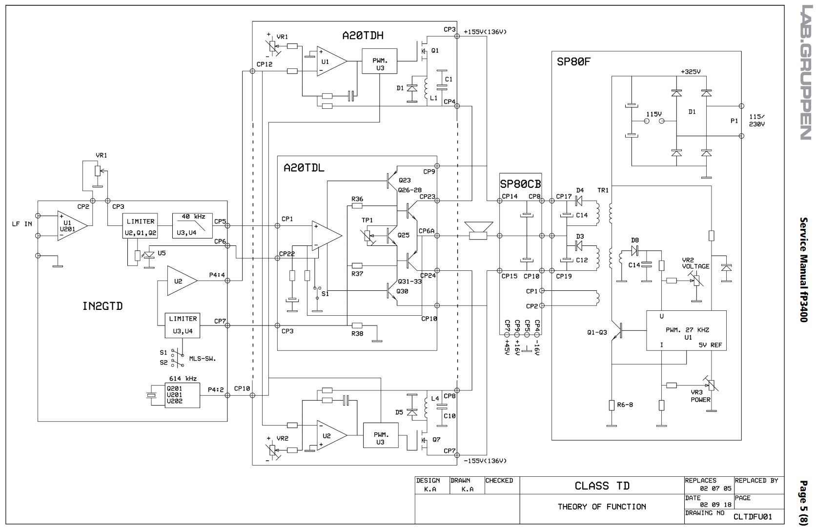

Btw, I have to correct my self regarding the previous post after having examined the schematics a bit closer, the fP2200 (incl. fP2400q, fP2600) is not a Class TD topology, but the fP3400 and fP6400 are, and they use fixed frequency PWM buck converters feeding the OP stage, if I got it right this time.
Regards

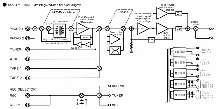

Conceptually this sounds similar to the Feed-Forward error-correction system that Sansui used in the early 1980s. US patent number 4,367,442. US4367442.pdf

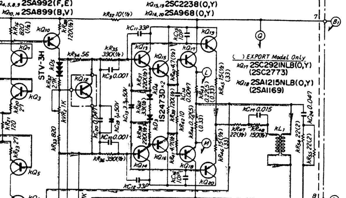

When we tried to make reverse engineering of AU-D9 we found that the low power amplifier (correction buffer) and ff network were not stuffed 😀 The amplifier sounded good though
