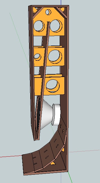

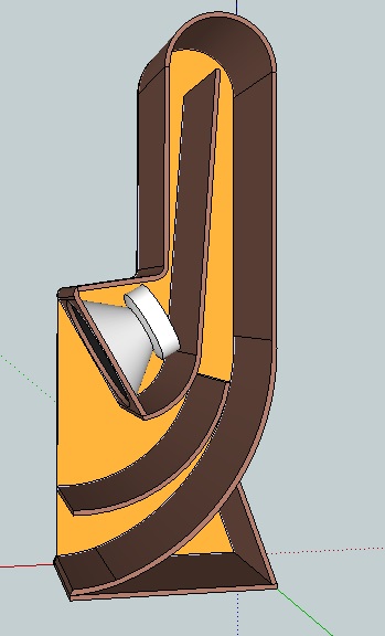

Have rejigged my drawing to look closer to the Gjallerhorn dimensions. Takes the height up to 2.2 meters but reduces the depth down from .6m to .45m
Would leave the base at .6m x .6m to give better stability. Yes did briefly look at a tube sub but they really don't appeal to me.

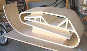

Not heard the term kerf before but from a quick image search that seems like a straight piece of material with parallel cut slots in it to allow the material to bend. While I didn't know what it was called I was actually wondering if I could use that in my current cabinet design to keep a constant horn increase.
I don't see why it wouldn't work especially if I fill the cavity behind it with something like expanding foam to keep the sound pressure from bending it.
Edit:
Actually nothing would stop me putting something like an epoxy glue in the slots to help keep it rigid after it is built and in place.

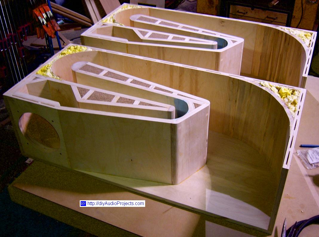

Did a bit more of a search on kerf and came across some very smooth looking cabinets.
