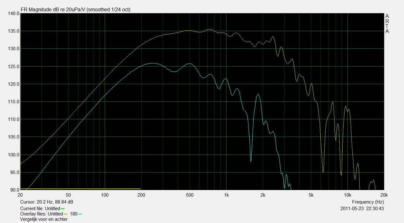

2-way: Waveguide + Cardioid-like
The opening post is now updated with the images!

Here's a diagram that illustrates my point from the last post.
In the last post, I suggested that the 'trick' to the Dutch & Dutch speaker is to juggle the volume of the chamber behind the woofer and the density of the stuffing. The idea is to create a low pass filter with a corner that's relatively high.
The reason that we want a low pass filter is because a low pass filter will create a delay that gets longer and longer as the frequencies get lower and lower.
The reason that you want THAT is because if you get the filter shape right, there will be a delay between the front and the back that attenuates the response.
The reason that this is so magical is because it eliminates all the issues you see with dipole speakers from Linkwitz and Kreskovsky. Their speakers are very nice, no doubt, but they require many channels. The reason that the require many channels is because the dipole works over a narrow band. The reason that the dipole works over a narrow band is because the delay between the front and the back of the baffle is FIXED. It's fixed because the DISTANCE between the front and the back is fixed.
An acoustic low pass filter eliminates this drawback. The delay gets longer as the frequencies get longer.
So far so good?
Now if you look at the diagram that I posted above, you can see that a low pass filter creates a delay that is almost constant, when measured in wavelengths.
IE, the delay starts at zero and it grows to 0.3 milliseconds, but if you evaluate that length in WAVELENGTHS the length is almost constant.
Neat, huh?
There's still a lot of work to do though. You would need to figure out the correct volume of the enclosure, what type of stuffing to use, how much to use, the correct corner frequency for that low pass filter, and the correct slope. (I think you want a first order lowpass btw)
I think I'm on the right track here...

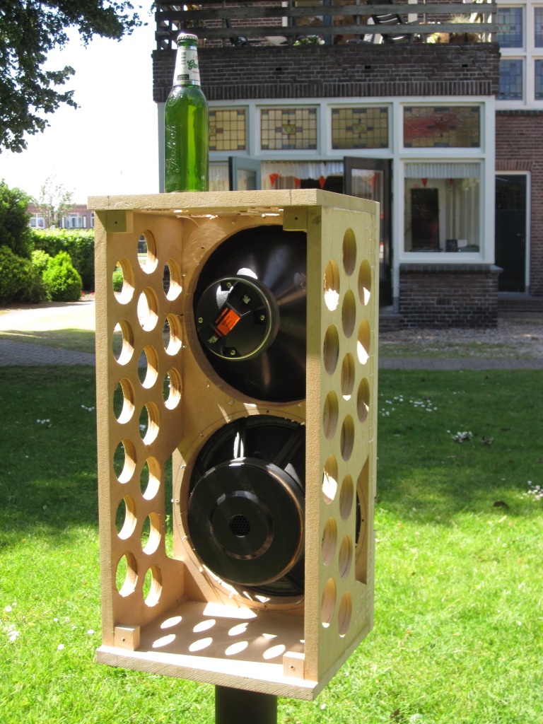

Here's another idea I had about this box. This idea is simpler than what I posted five months ago.
If you look at the original box and the new box, there are a couple of changes:
1) There are far fewer ports
2) The ports are relatively close to the woofer.
I'd invested a lot of time tinkering with this idea in Hornresp, but Hornresp can't measure a fundamental aspect of Keyser's design:
Not all of the sound radiated in the box will escape from the port immediately.
For instance, in the Dutch and Dutch speaker, the pathlength from the front of the cone to the back of the cone is about 60cm.
In a conventional dipole, the pathlength difference will have a couple of effects. First, a big peak that occurs when the front and back are in phase, "the dipole peak." And then a rolloff below the peak.
One of the things that I couldn't figure out about this passive design was how is it working across a broad range of frequencies? And I think that the answer is "because not all of the sound inside the box escapes immediately."
To get good cardioid behavior, we need the sound emitted from the ports to be delayed with frequency. IE, it's not sufficient if the delay is one millisecond across the board; with every octave lower that it plays, the delay must grow longer.
But since the sound can't escape immediately, that may be a passive way to generate the delay. Some sound escapes the box immediately, some sound escapes the box after a single reflection, some takes a few reflections.
BTW I can't think of any easy way to simulate this! We're basically talking about a complex interaction of the following:
There's acoustic/damping material inside the enclosure. In case of the Olympus speaker (this thread) it was rockwool. At low frequencies / long waves the sound pressure kind of takes the shortest route out of the enclosure. Above a couple of hundred hertz almost all sound is damped.
This is indeed the greatest challenge. Basically, in the lower end of its passband the 8c midrange is a pure cardioid. Then as the directivity of the driver and baffle edge diffraction starts to increase, the output of the slots requires a low-pass filter that matches the decrease in output to the rear. At the top of the midrange drivers's passsband the directivity is no longer the result of the cardioid configuration, but just the driver itself and edge diffraction.
Actually, a theoretical cardioid consists of two point sources spaced some distance apart. The point source in the rear has inverted polarity and a delay equivalent to the propagation delay between the two sources. So no frequency-dependent delays.
The internal dimensions of the cardioid enclosure are much smaller than the wavelengths by the way, so it's difficult to think in terms of 'reflections' inside.
611119d1491990102-2-waveguide-cardioid-3-jpg
This is the first cardioid-like speaker I ever built. It really was a matter of trial & error in the beginning. I made holes in the sides, top and back panel. Later I replaced the back panel with a panel with no holes. That improved things considerably. As you know, the latest designs have a single port closer to the front. In this 6moons review you can find some photo's of the construction.
