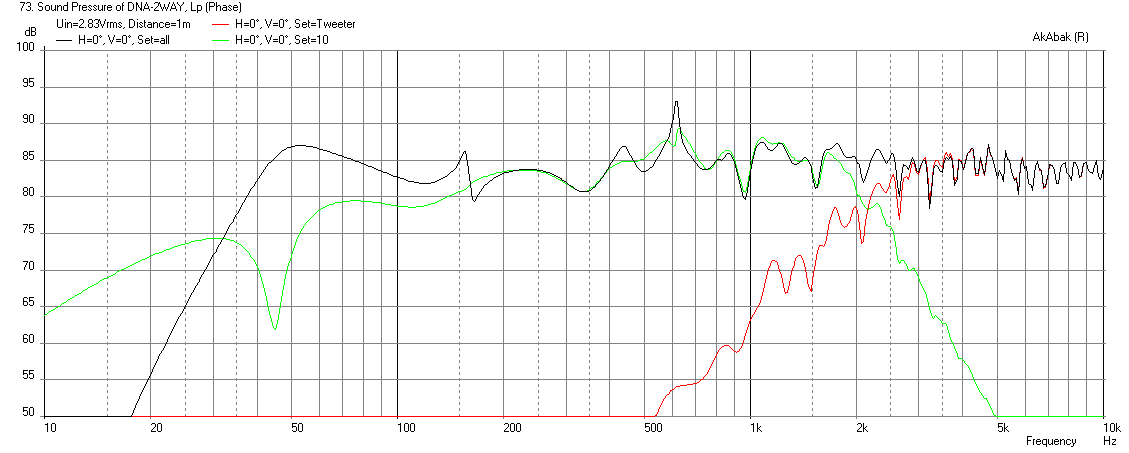

DNA (wide) 2-way with AC130F1 and RS28F
Here is a DNA BLH widened to 9.0in internal width and fitted with an Aurum Cantus AC130F1 and a Dayton RS28F dome tweeter with a ~2.2kHz cross over BW4 on woofer and Bessel 2 on tweeter. There is also a 1mH and 10R BSC applied to the AC130F1 to reduce the effects of baffle step losses. A lot of the ripples shown in the model will go way in reality when stuffing and padding losses are introduced.
More info on DNA horn here:
http://www.diyaudio.com/forums/full-range/235457-decware-dna-horn.html

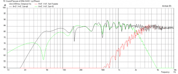

Here is the performance on a 30in stand sitting 60in in front of a back wall, there is quite a bit of baffle step losses:

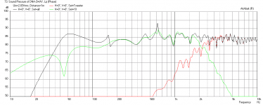

Here is a corner placement 24in from either side wall - looking better frm bass department. 83dB overall sensitivity with 37Hz f3:
This may not be the most efficient BLH as it is more a hybrid BVR/BLH design and this driver is meant for a bass reflex but what I have on hand so I was curious. However, you really can't beat the combo of the AC130F1 and RS28F for overall smoothness and ability to integrate well for an overall solid combo.
