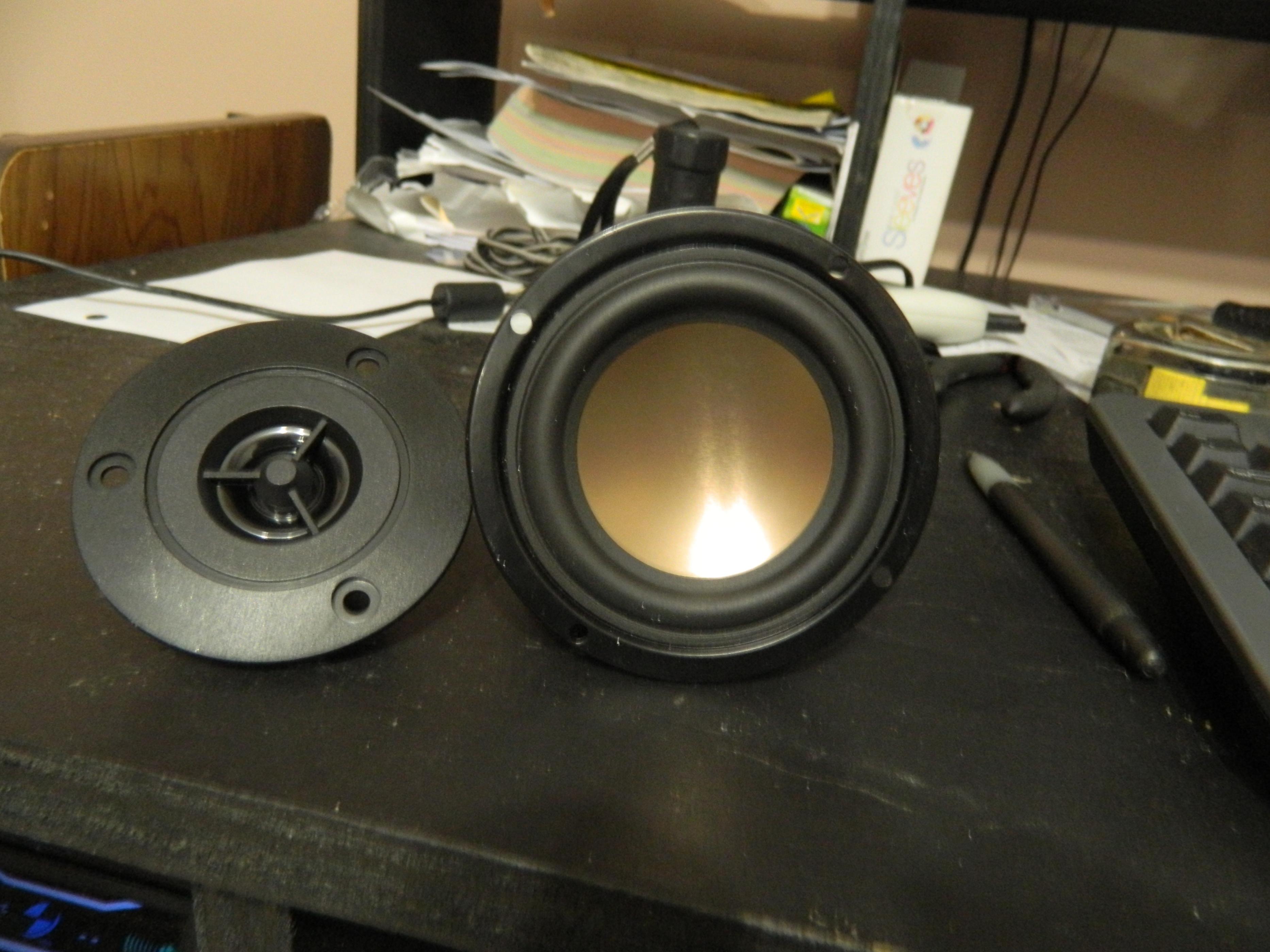

I'm starting this thread to show a different approach on the oval cabinet using 3/4" MDF.I'm not a big fan of full range speakers, but there are many that are good quality but none can reproduce as good as a mid-woofer and tweeter so that's my approach a 2-way line array using 12-mid-woofer's, 12 tweeter's. the woofer's are HiVi b3n ,RMS 10w, max 30w / 100-7000hz /8ohms. Tweeter's are a buy out @ PE / 1/2" Mylar, shielded , w/2.2Ω, 5 watt padding resistor , RMS/ 30 max/60 and to tone these tweeters down Ill put in a 100 watt L -pad & 2x2" ports . Here is a general idea of the shape. Another DIY Audio member Wesayo designed these. Measurements are 51 tall x 13"deep x 8-3/8"w these are internal measurements . These will be used for my TV ? stereo. Ill post pictures of my progress when I get started. :D

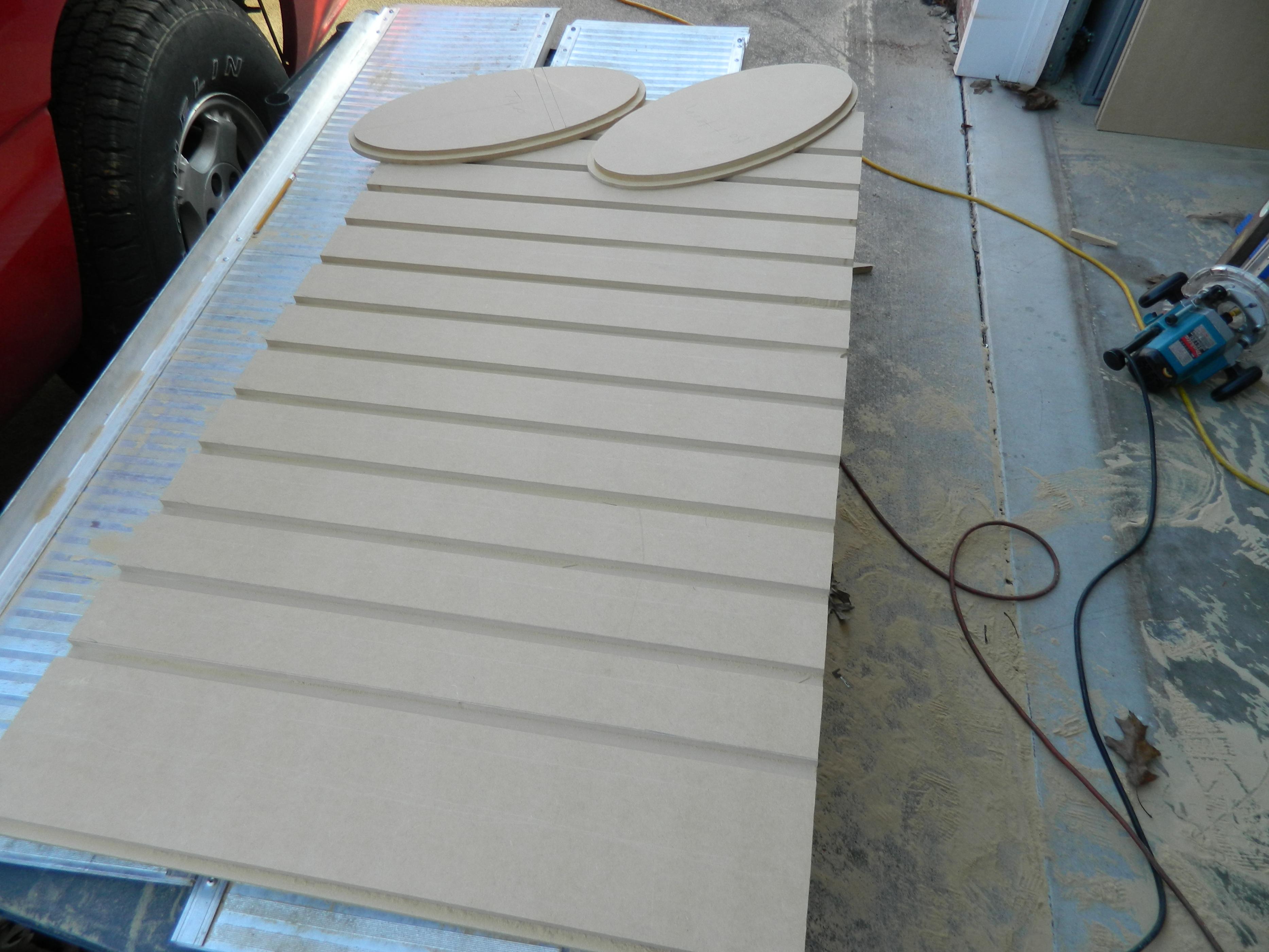

Here are my panels for the side of the cabinet along with a top and bottom. I decided to show this stage before beginning the kerffing as to show the rabbit cuts to receive the top, bottom and braces. these are 3/4" wide rabbits and the shorten work load from taking several passes you will want an industrial router ,mine is a 3hp. Makita this cut it in one pass. Anything less and you will burn up the motor pushing it this hard . Some may question the bracing being so close but remember the sides are kerffed and not as strong as solid wood ,the braces help remedy this condition. The next pictures will assembly. Stay tuned for the next episode

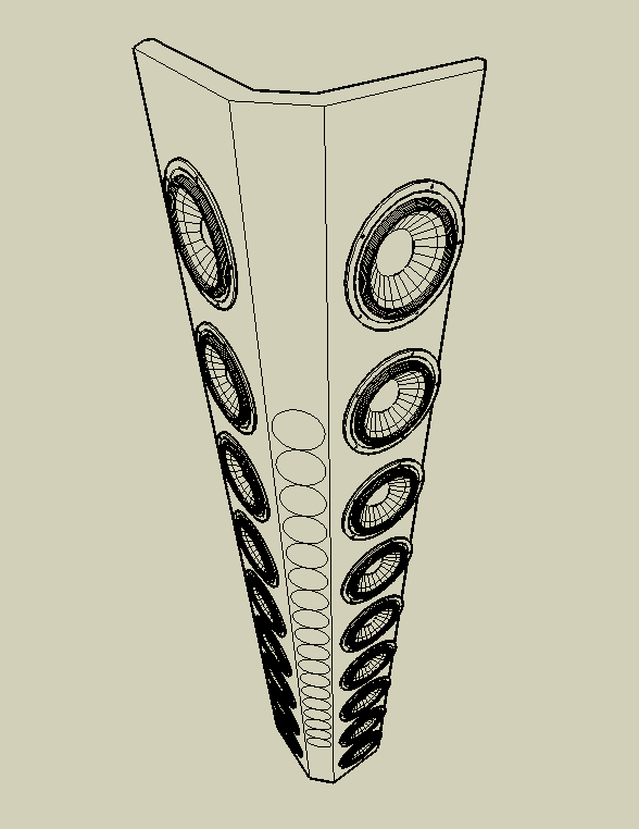

It will be 52.5 "tall x 12.5 deep with a 8.5" wide baffle stepped up 3/4" for the woofer side with open cell foam stepping down to the tweeter in 1/4"increments , this help with diffraction from the tweeter .... I have even kicked the idea around of a inverted angled baffle this approach which would look allot cleaner without the foam, but figuring the angle can be a bugger of math equations and a hair puller .....
This is similar to what I'm calling an inverted baffle although mine would have woofer on one side tweeters on the other perfect V shape but the angle is very critical ...

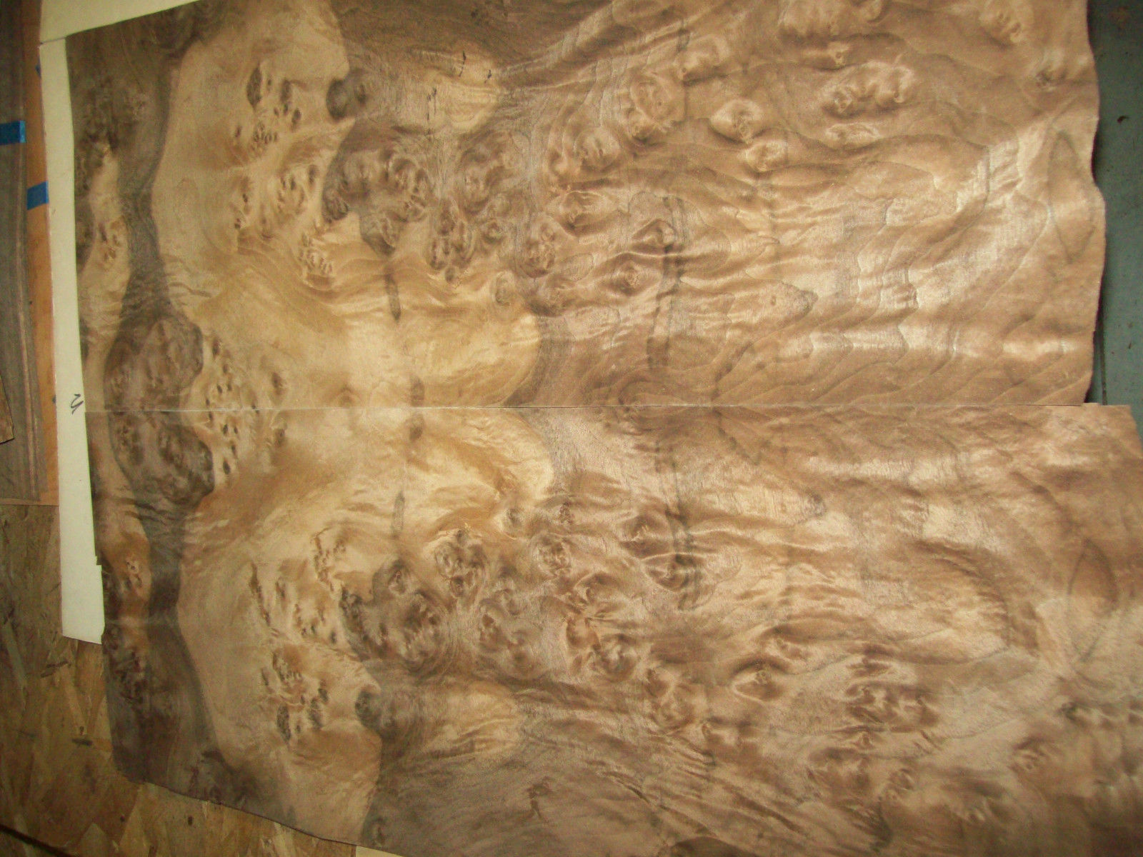

Well today its 16 degree's so needless to say " I'm staying inside " no work on the speakers today, but I got on eBay and bought a great patterned walnut-burl veneer to wrap around the sides of the cabinet's .... This will be gorgeous:spin:

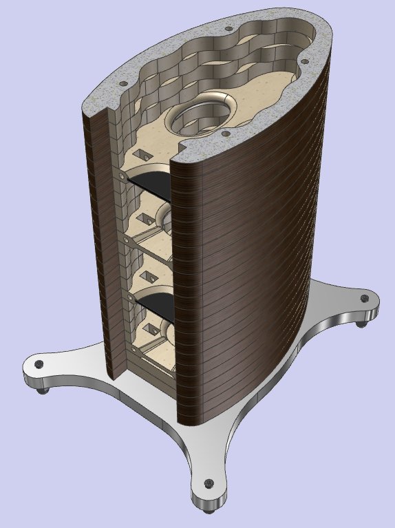

Hi. I'm a big fan of the translamination process. If I may, I'd like to make a suggestion. In the drawing you show each layer as one piece. When I do this process, I make the "ribs" with a cut at the back as well as the front. This will save you a ton of material when you start cutting.
I agree docterbad the picture was of another DYI member but I'm building mine out of MDF as the pictures show , I only used his picture as reference to the style and shape. But thanks for your suggestion. I'm cutting allot of time of labor by making the sides out of MDF instead out the stack approach.:D

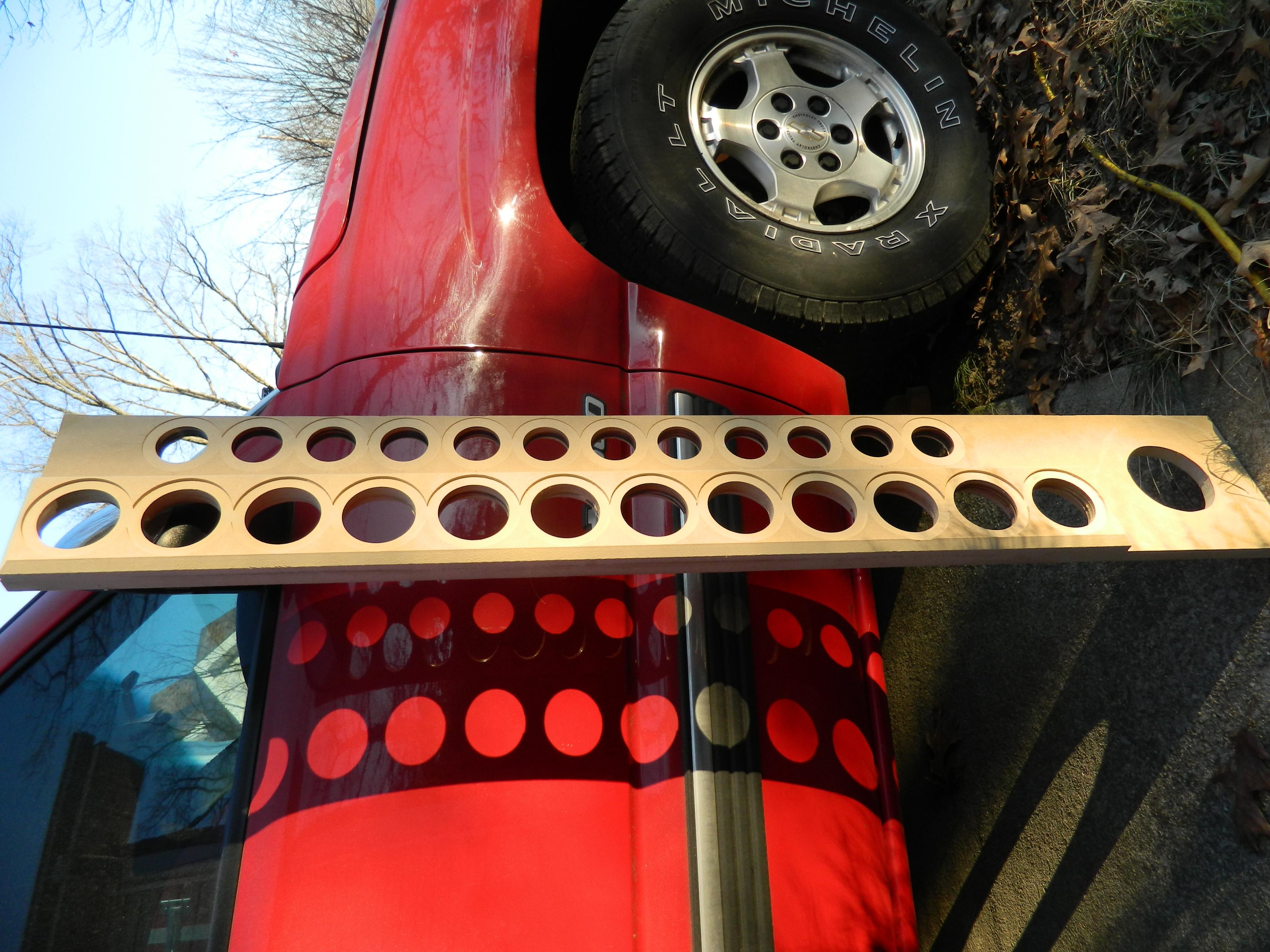

Speaker baffle's
Wow! a lot of holes to punch out and recess, I had to also recess the back of the holes to allow for the 1-1/2" thickness and allow the woofer some breathing room. These HiVi 3" were not intended for 3/4" material let alone 1-1/2" so I recessed the back down to a 1/2" thickness this give space for terminal hookup.:snail:

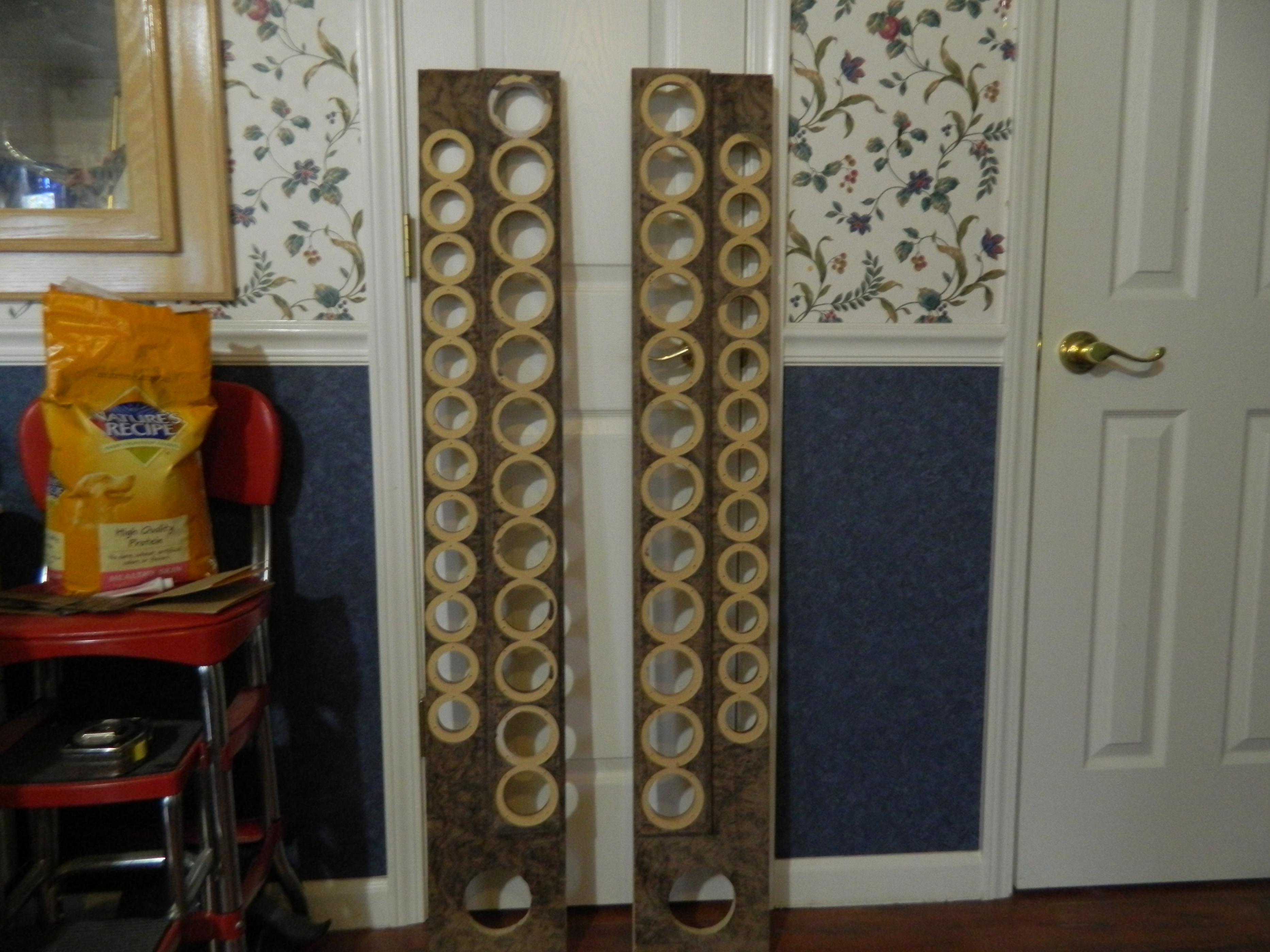

Front baffles
[/QUOTE]Its been a while since my last post but its cold here and slow going on progress but I started laminating and got the front baffles done. The sides are next, I'm having to veneer this in pieces rather than after assembly because of the oval design will not work with a veneer press. If your thinking you could us straps forget it because it takes a 800lb + of pressure to flatten out the veneer evenly and these are big panels at 31"x 51.5" More to come in the next few days .
