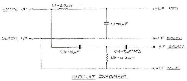

I think you might end up with something a bit like the SEAS Idunn: Idunn

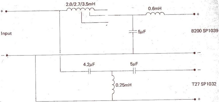

These are a couple of 3kHz KEF crossovers for 8" bass and 1" tweeter.
Impedance should be reasonable with 6 ohm DC drivers.
The 104 was a plastic bass and the second 0.6mH is probably optional, the Celeste III was a paper bass. You will need an attenuator or some sort of resistance in the treble circuit and you need to take care you don't take impedance too low for your amplifier. I can't help you with the tonal properties of your unusual waveguide tweeter, and polarity might be unpredictable.
But a start, I think. A 10uF shunt on the bass here will take crossover down to nearer 2kHz, but the tweeter filter will need to change too. I'd start at 3kHz to be on the safe side. :)

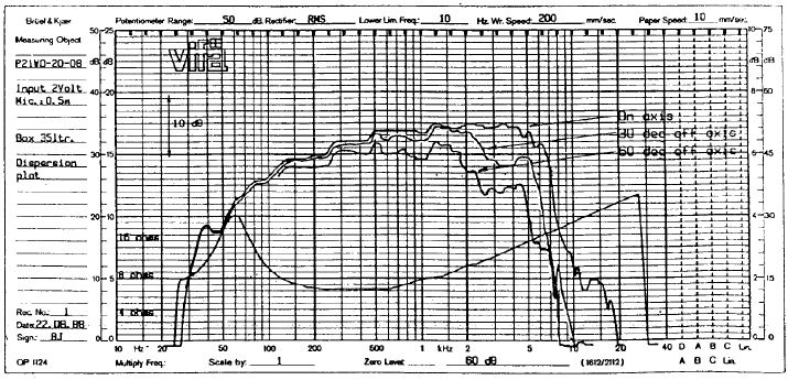

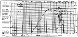

The 8" Vifa polycone looks quite well behaved. It'll probably sound OK on just a 1.5mH BSC coil and rolloff naturally around 3.5kHz. The waveguide tweeter might give you a hard time though. But who knows? Lynn Olson spends 6 months fine tuning a speaker. Mostly by ear, once he's in the right ballpark. :D

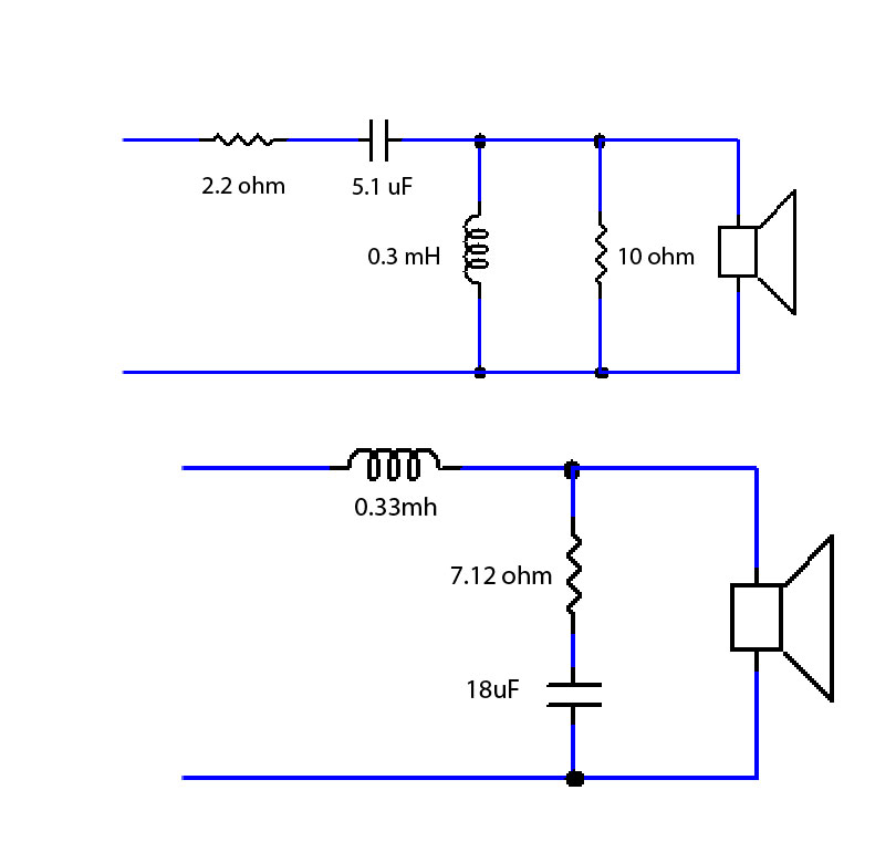

I'm new to speaker design. I've only made one other pair that I'm very happy with, using CSS fr125 full range in mini onkens.
I got these speaker 2nd hand and cheap.
Something is missing in the sound though.
They're wired for one or two amps. Each with two L-pads, a 4U7, 6U8 Claritycap and one homemade coil made from some braided wire! Is this OK. Solidly built, 62l bottom ported and tuned to 40Hz I think he said, but can't be sure.
Maybe my amps haven't enough power. I'm using a My ref C, or Nad 3029.
They seem to be lacking mid range. I just want to get rid of the biamping stuff and get them sounding better.
I've been working through AllenB excellent tutorial and it just seems these two drivers are not well paired. Crossover recommended at 4KHz which I think brings the scanspeak upto 14ohm's Is this correct? AllenB also mentions that 4k is not a good place for woofer to cross. The resonance frequency of the tweeter is quite high at 1500Hz.
The tweeter attenuator (L-pad) goes AFTER the tweeter filter.
But you might be quite close to the 3kHz KEF Celeste III tweeter filter here with 4u7 and 6u8. The bass unit will need some work by the sound of things.
I'd be surprised if it sounds any good without at least a BSC coil. That's a 0.7mH bass ferrite unit bottom left, the coil top right is a much smaller value tweeter 0.2mH aircoil in that different example:

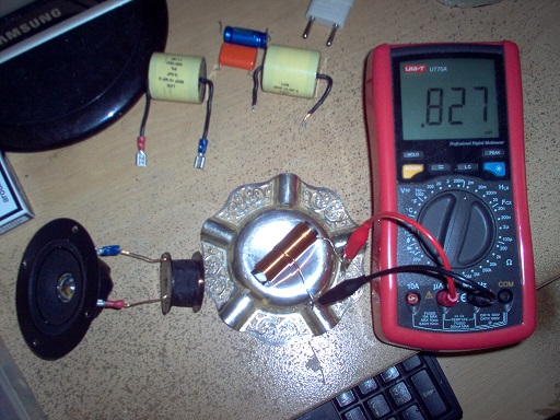

You need to draw up the existing filter to work out what comes next. It's gonna be hard without a good multimeter with the ability to measure capacitance and particularly, inductance.

No, the 0.33mH bafflestep coil on the woofer is completely wrong. It should be much bigger.

I do consider a good multimeter useful. Not cheap though. Mine was £70. Here I use the inductance scale on a 1mH coil to see what a nearby metal plate (or circuit board) does to it.

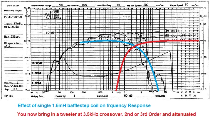

I've never tried to demonstrate it quite this way before, but an 8" polycone bass will need very little filtering. Most of the rolloff is built into the driver already. All the simple 1.5mH coil here does is tilt the slope down about 2dB per octave. With first order 8" bass, usually second order tweeter works best on phase.
This is a simple filter you can adjust by ear. bling has got lucky the Vifa bass is well behaved. If you want to do higher order for a cleaner sound, the KEF Celeste III schematic is a good start. That might be for another day, because it's good to start simple and get to know the drivers. 30-60 litres is usually about right for 8" bass, so that shouldn't be hard either.

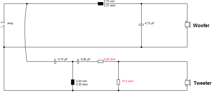

Thanks for your suggestions.
I'll try out the Celeste III as I already have those capacitors In the speakers.
Speakerbug in AU has P-cored coil 2.7mH for $21. Is air coil ok for for tweeter?
