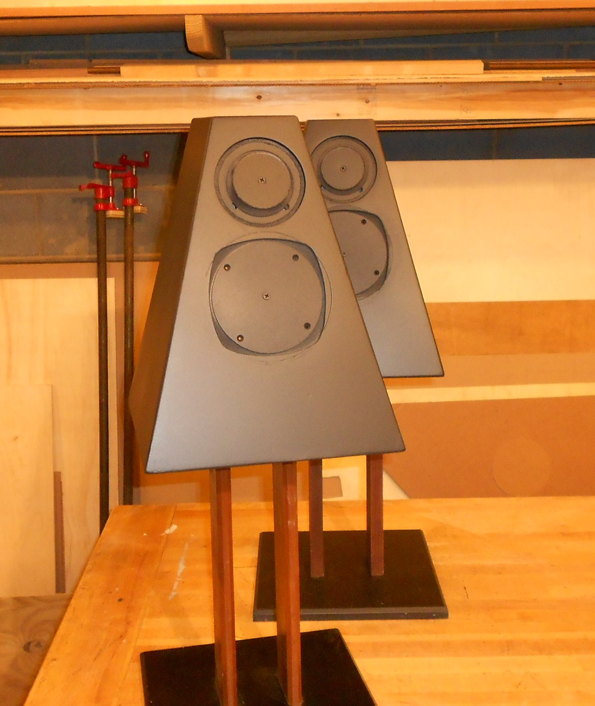

The triangle speakers are next, have duplicate parts - 3.9uf tweeter cap. Funny but true, tiny little thing(s) (poly) think I should order some nicer ones? :scratch:

I finished up the black pair today, a little disappointed, the bass is a little muddy.
The oak pair with the sand walls sound better; both pairs have a nice "live" soundstage and are working nicely.
*Going to pull some damping material out of the black pair.
I guess I could find one Allen. I did work on the black pair yesterday, while listening to the sand filled ones (which I'm loving).
I took out the cut foam out and replaced it with 3.5oz typ. damping/stuffing material. This is the same as the oak/sand pair.
I do wish I could get the black pair to sound as good. What would I listen for? The panels are 1" thick, lead-lined and very solid.
The oak pair is 3/4" mdf with 1/4" sand (set in glue).
Both set of BR boxes are same volume and ported with 5" x 1-1/2" pvc.

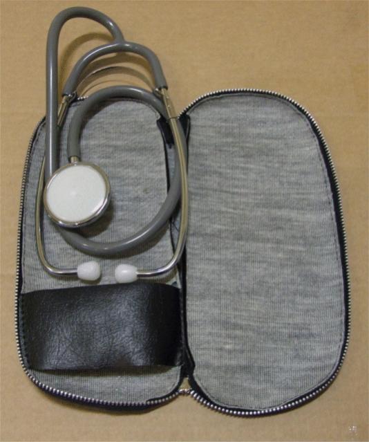

I can go over a panel and find the pattern of the resonance. For example that a panel vibrates at 1/4 and 3/4 the way across, all the way up and down it. Based on this and on what I can hear I can decide whether to brace more or damp more, and where. It helps me decide whether a panel resonance is a possible source of a problem I can hear, or weaknesses in a front baffle with large cutouts.
It isn't possible to hear much, per se. You can tell the broad range of frequency but it's fairly easy to tell where a panel is and isn't vibrating. You could always try using a glass for this.

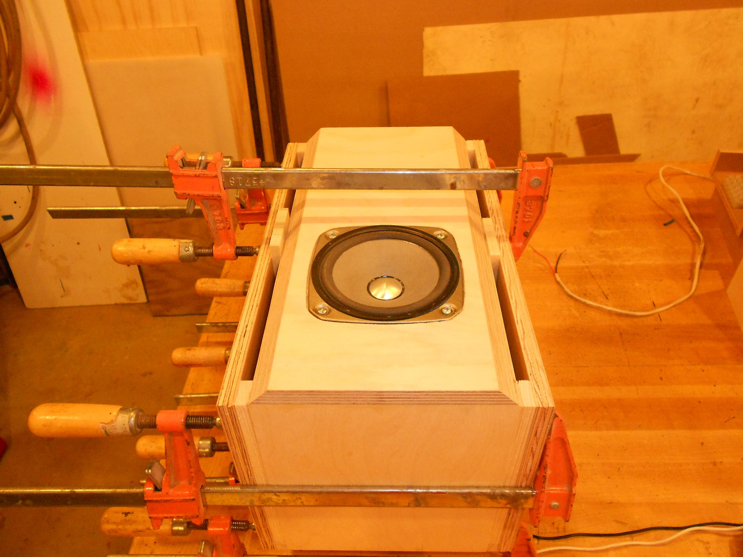

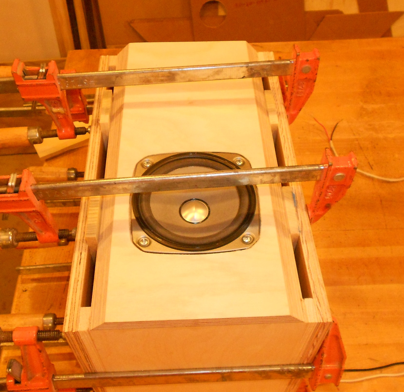

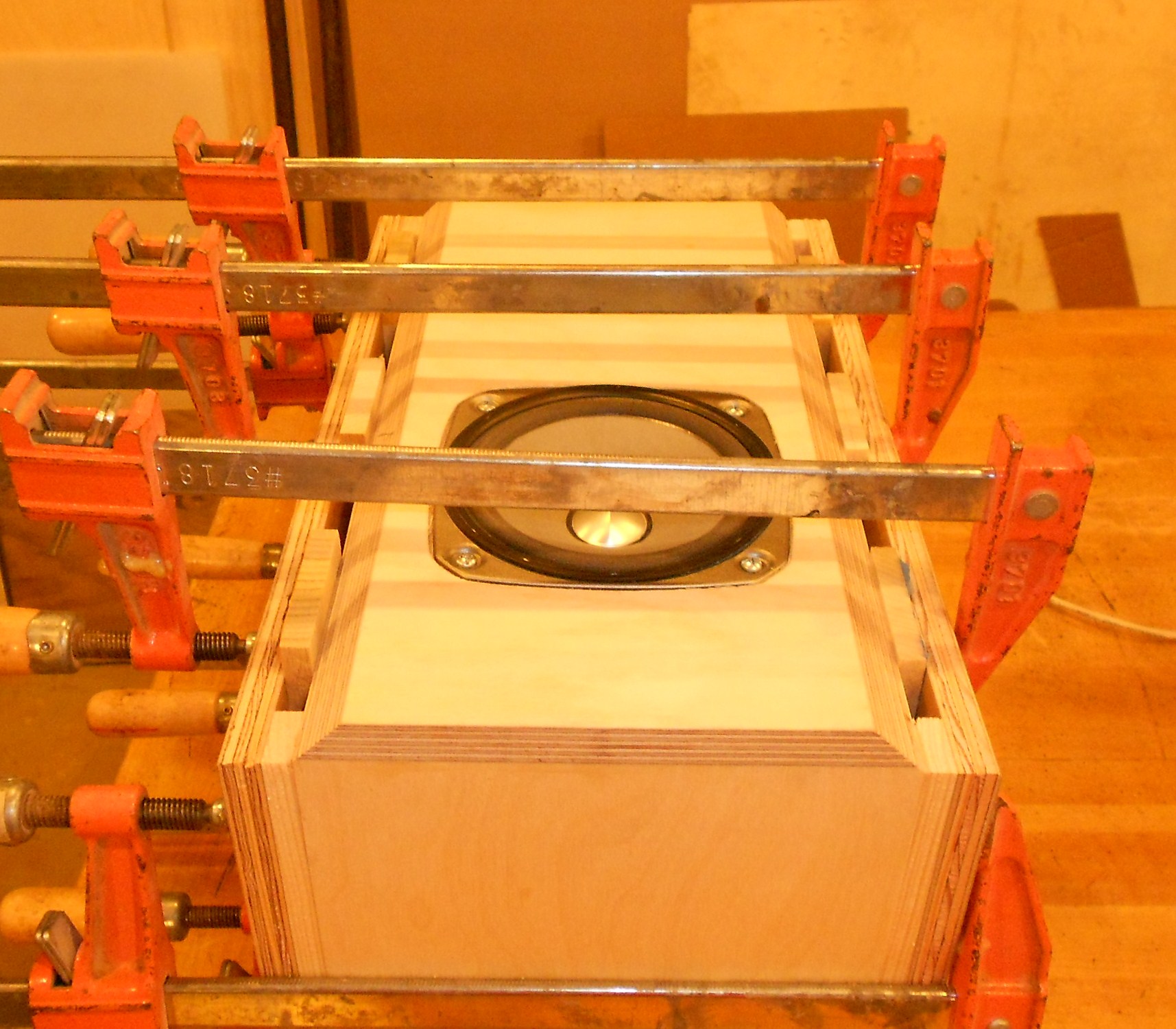

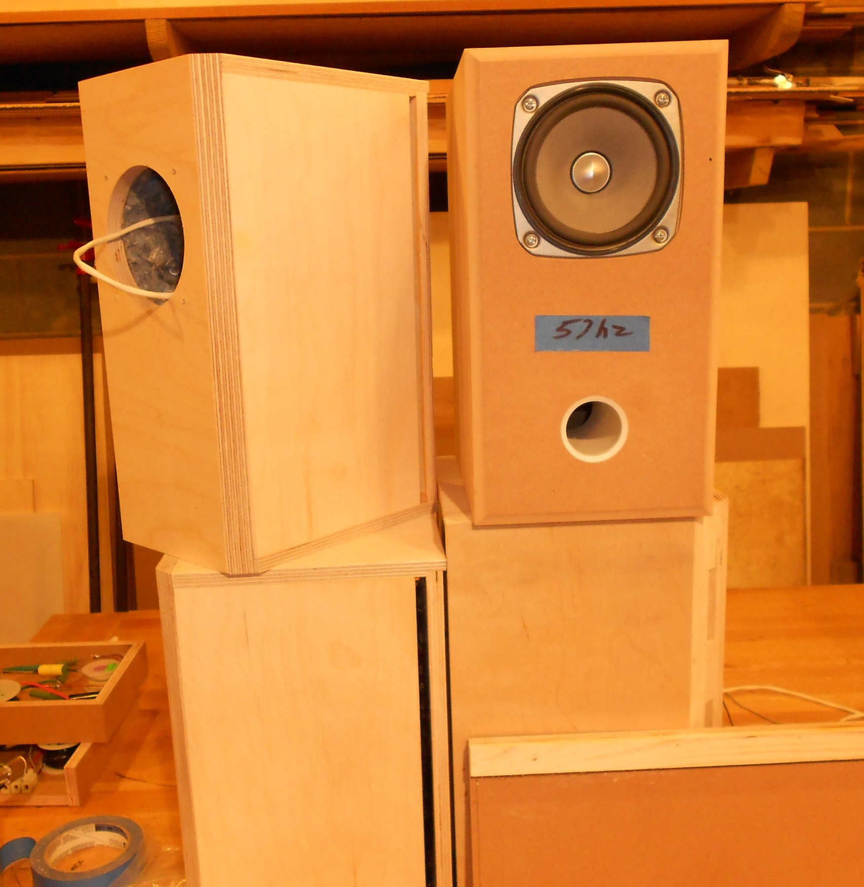

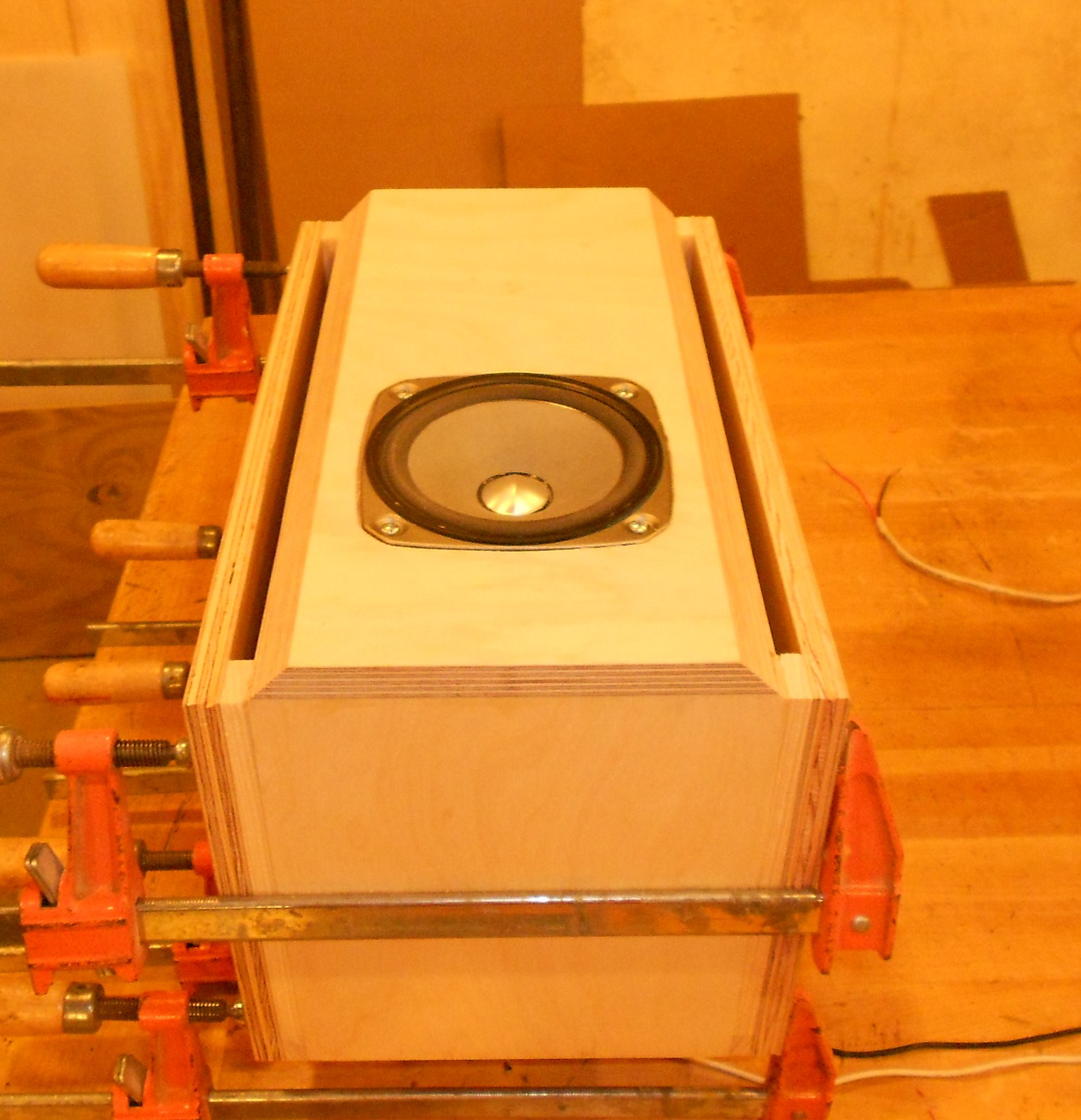

For anyone interested...I'm putting new sides on Fonken, don't know where to tune it. Some where around 60hz - 70hz. 72?:eek:
The box with blue tape is the Fostex box as per in-the-box-plans.
The yellow will give far more perception of bass. The white is the Fostex value. You just can't make something do what it can't do. The bright green is -3 dB. As you can see, they both fall off at about 200 Hz. I would go for the 70 Hz range. The good news in measured, the yellow is actually a little better than that. Sim is never quite correct. I expect the white is better too. Waiting for glue to dry, on my X45 ( successor to the SR71) so I'll try and get some measurements of the striped cabinets.
Shooting in the dark
Tvgeek, maybe you could measure the bass response with the different number of strips, e.g.:
No strips - 82hz
2 strips - 75hz
4 strips - 70hz
6 strips - 61hz
The box/woofer did seem (to me) that it was just working too hard with all 6 strips in.
