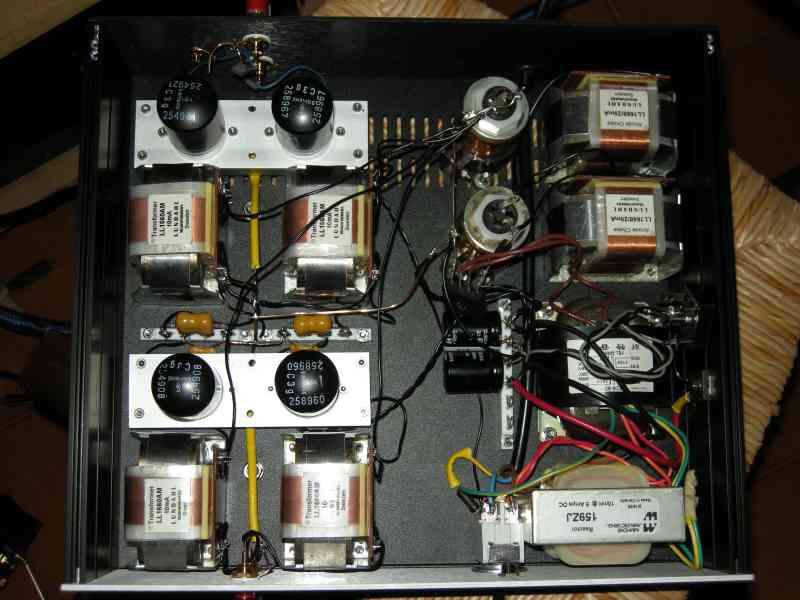

Now that I have finished my SP10 turntable project, I want to build a high end phono stage to meet and exceed it. There is a well reviewed phono stage that has the following published details.
No caps or resistors in the signal path
Point to point
Pair C3g tubes in input stage, 2123 Hz, passive regulated DC heaters
Pair C3g tubes in the output stage, 50-500 Hz, AC heaters
LCR network transformer driven
39 db output level for MM
Step-up transformer for MC
Power supply 6CA4/EZ81 tube rectifier w/choke filter
Input impedance 47Kohm/200 pf
Output impedance 1200 Ohm
Gain 39 db
I found these transformers that have similar construction to the commercial unit. Noguchi Tranformers FMQL and FMQH RIAA equalizer coils.
Are there any known schematics that can be modified or anyone up to the task to sketch out? Or too difficult a task?

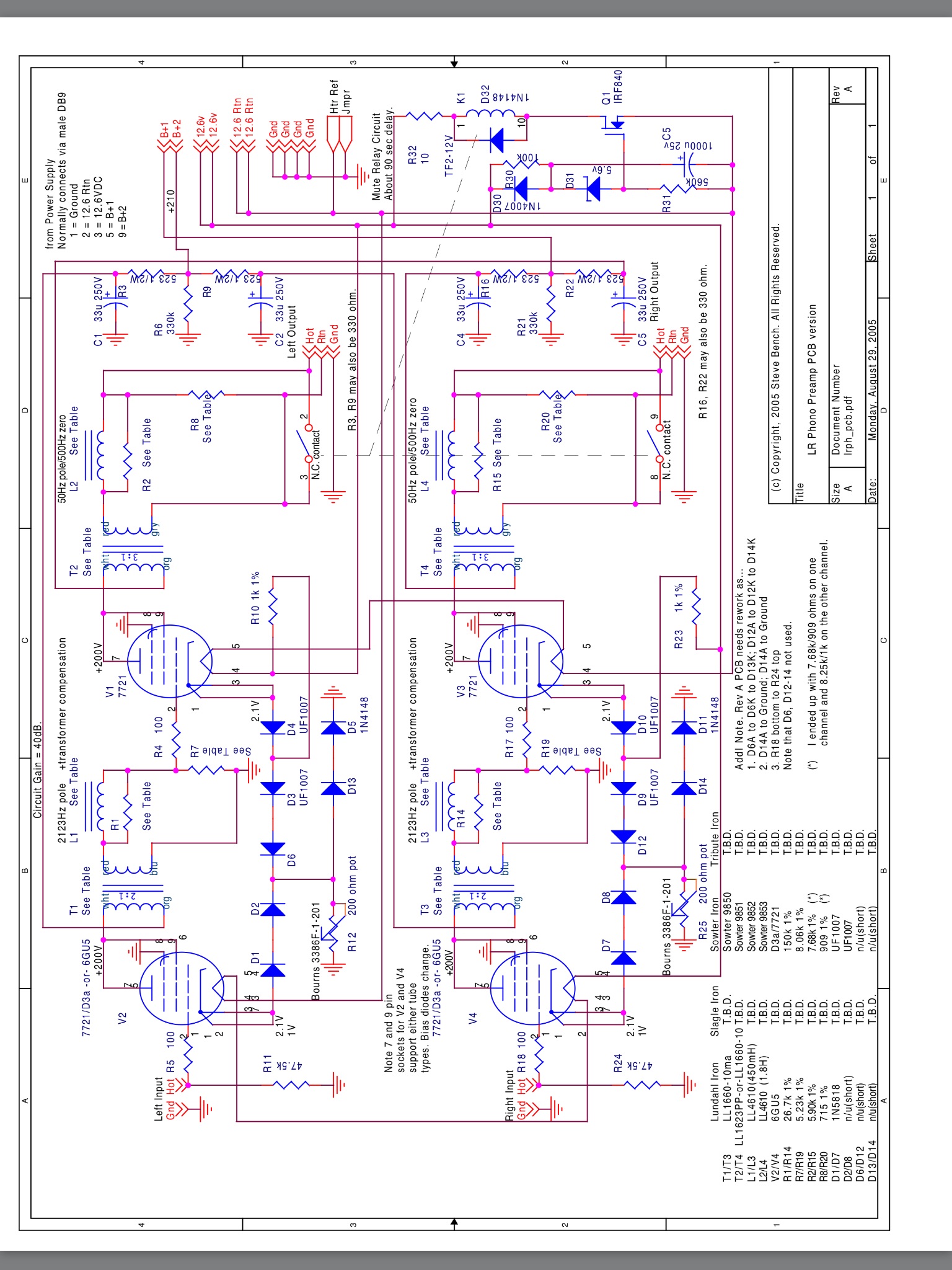

Searching again today I found a schematic in the right direction. Steve Bench. On Jacmusic.
Lundahl Moving Coil transformers.
Here is the schematic
Has anyone built this?

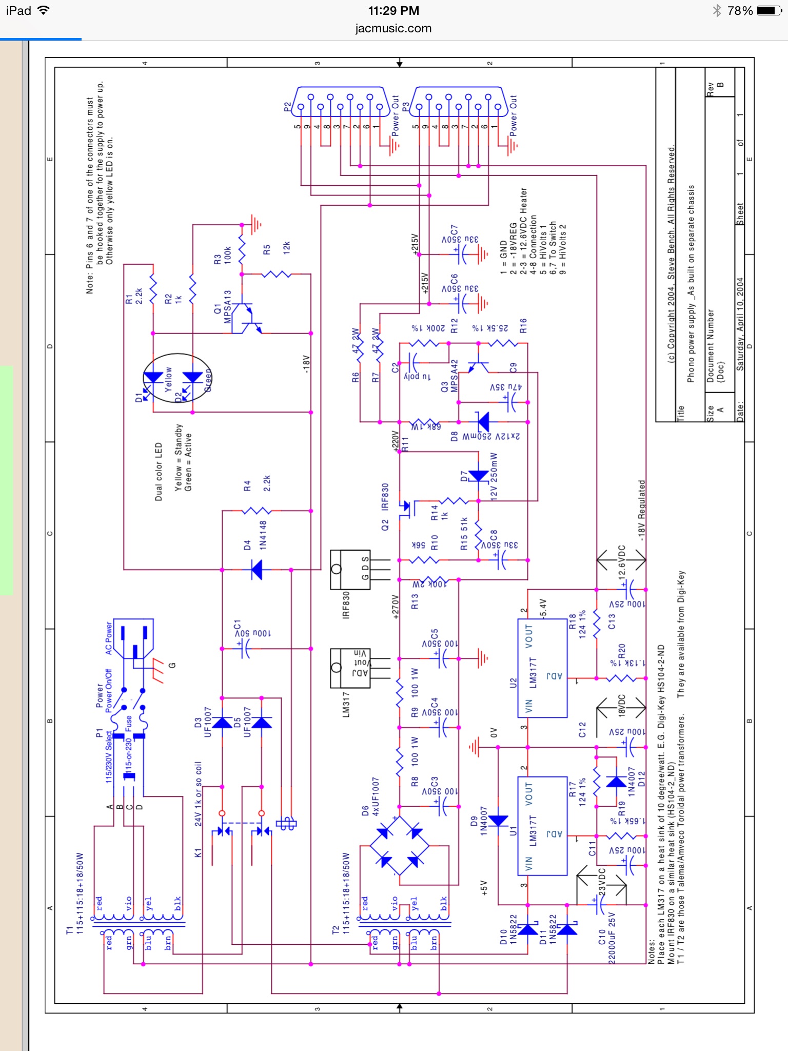

Here is the power supply for the Steve Bench (now Stephie Bench) phono stage. The phono stage is actually an LR design.
After some more digging I have been told a couple of people have built this design and had "problems stabilizing it in the bass, presumably because of that positive feedback fix for the bass roll-off". I also understand that they were not able to overcome it.
I'm still researching to see if there is a solution or an update to the design.
