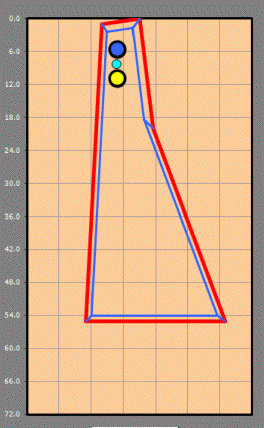

I have now got SPLTrace working and played a bit with FRM. The shapes allowed there for baffle simulation are pretty limited in FRM so I had a look at the other programs JR recommended. It seems like BDS has the most flexibility. Even that only allows up to 5-sided shapes. What I really need is to be able to run sims with a small rectangle sitting on top of a larger one, which amounts to an 8-sided object when you include the "shoulders" of the larger rectangle.
So, I tried to make due with a 5-sided shape as if the small rectangle was placed on the larger one with one side aligned with the side below. The opposite side then is two lines, so it is really a trapezoid underneath rather than a rectangle. Working with that sort of shape I was able to work out a few things.
I found that a 7" wide baffle with 1" radius chamfer on one side and a 1.5" chamfer on the other side gives a pretty smooth response. The drivers need to be offset towards the 1" chamfered side. Also, the tweeter response is best when it is placed a bit to the left of center relative to the two mids. Moving it an eigth of an inch either way makes a big difference to the response curve. I was surprised that such small changes made such noticeable differences. Also, having the baffle wider at the bottom than the top, a trapezoid, was better than a rectangle.
Overall, the take aways seems to be these:
Large radius edges, unequal, are advantageous
Offset drivers, and tweeter offset relative to mids is an advantage.
Mildly trapezoidal shape is an advantage.
I will fiddle some more with this modelled as a tall trapezoid since in the end the MTM unit will sit on top of a woofer box that is tall and relatively narrow. It only sits on a squat rectangle in the interim.

Nice work. Your conclusions are valid although I would probably just say larger radius edges are better. Notice though that the scale of the BDS chart is fairly large so that 1dB changes can look kind of large but may not be that significant in the big picture.
Also, as I tried to say earlier, you want to try and think of the diffraction and FR responses together. If the FR has a peak and/or dip, can you get the diffraction response to cancel it out? You can still import both the FR frd and the diffraction frd into the FRM to see how they will sum together.
The Edge will allow you to model the shape you are interested in but it won't allow you to do any edge treatment (somewhat ironic given the name chosen for the program). The other pain is that it doesn't export frd files - you have to trace the diffraction curves you generate to be able to use them. That is a bit of a pain but there is more shape flexibility.

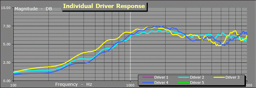

Well, I am encountering a rub there. I'm sure it is because I am such a noob at this.
I can make a nice set of response curves in BDS but when I try to bring them into FRM I am not believing what I am seeing. I have been saving the responses from BDS for the individual drivers. I can not save the summed on-axis response for some reason. There may be some setting choice that wold allow that but I haven't found it.
So, if I save an individual driver response curve as an .frd file and then import that .frd file in FRM as a baffle import, one of the choices on the right side of the sheet, it lifts the response curve up into the 95-100 db range. The curve generated in BDS spans more than 7.5 db, and that appears to be getting added onto the basic driver curve in FRM, that curve having been created in SplTrace. This addition can not be right, can it?
Another thing that bugs me is that when I chose 2 drivers in parallel in FRM, that changes the impedance curve but it does not increase the output shown in the frequency response curve by ~6db. Why?
Again, I must be missing a setting somewhere. If the FR curve _had_ been raised ~6db as expected then I can't see how adding another ~6 makes any sense. It seems like this baffle response import should be done by multiplying by a ratio, not by adding a value. Is there a normalization step I am missing?

Import FRD file to modify --> Import Baffle-Room data --> Save modified result to FRD file.
If that doesn't work then there is something not working properly with the program. Let me know.
Baffles diffraction can be modeled as a loss or a gain. Notice in both the diffraction section in FRM and the Baffle Diffraction and Boundary Simulator (which are the same program) that there is a button for this. You want to be using the loss model so that the HF are at 0dB and the LF end up at -6dB. Notice however than in BDS, it's modeled as a gain so that the HF are at 6dB and the LF are at 0dB. So when you go to save the responses in BDS, input a 'Ref Level (Db)' of -6 instead of 0. That should solve the problem.
You are absolutely correct. The parallel wiring does raise the output by 6dB but doesn't show it. The reason is that the next step in this process is to import your modified frd files into a xo program like PCD (Passive Crossover Designer). Here, you will have to again identify what wiring configuration you are using and then you'll have to import an frd file for each of the drivers. This program will then do the proper calculation and give you the appropriate 6dB of SPL gain in its response charts. If FRM also did the same thing and then you imported it into PCD, the result would be incorrect by an extra 6dB. So in other words, FRM needs to export the result for a single driver and so that's what the program shows you.

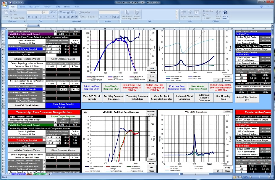

JR - You are a huge help! I have now got reasonable looking graphs by saving the files from BDS with the -6db ref setting, further modified them in FRM, saved again, added the phase data using the nifty transform in FRM and saved final versions. I probably skipped the extra step in producing the simulated impedance that you mention above. I just forged ahead anyway to learn how to run PCD.
So, I have then imported these frd and zma files into PCD 7.0. It is really starting to look fun at this point, like some interesting experimentation will be possible. But, I have now run into a new stumbling block.
I can not figure out how to tell PCD I want to use two woofers. I can enter offsets for both, but it says second woofer is "not used". Where do you enter the choice that this will be an MTM or whatever overall type of design? Also, none of the spinners I have tried do anything. I must have skipped a step here somewhere. I have read the instructions but they seem to gloss over this particular point. I can either start by importing an existing profile file or just start entering driver data. Well, just entering driver names and offsets, importing the frd and zma files and flicking the spinners is not happening for me.

Getting 2 woofers to work in PCD is a simple matter of hitting the "Number of Woofers" control button -however if I recall correctly that isn't working any longer either.

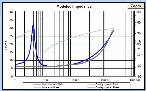

It sounds like you are saying running the box model does not actually alter/update the imported (SPLtrace) impedance curve in FRM? It looks like it does when you choose ported as box type. I am using sealed and I can't see any difference with or w/o box settings. I don't understand why you want a second imported overlay when it is the same as the original curve anyway (?).
You are sort of doing the same thing here with impedance as you do with the LF response when you model it in a box - it's the LF FR and the LF impedance that change due to the box, but the FR and impedance above about 100/200Hz stay the same. With the FR, you splice the responses together, but with the impedance, you modify the modeled response above the peak to match the raw impedance. Frequently, they are fairly similar but they are often off by a fair amount too. I suggest it's worth taking the extra step.
Ahh, so the impedance _should_ always stay the same above the peak regardless of the box but sometimes the FR software process changes it for some reason? OK. Something to watch for.

After an initial go at combining the woofer and tweeter responses in PCD I see that the left declining slope of the slump in output from about 3000 to 8500 Hz in the FR of the FE83 will probably have to be used as a crossover point.
I think what is going on there is not really a drop in output, but the consequence of there being a bunch of resonances just before, from about 1000 to 3000 Hz. Otherwise the FR graph of this driver should look like that of the FE85, which is wonderfully flat all through that region.

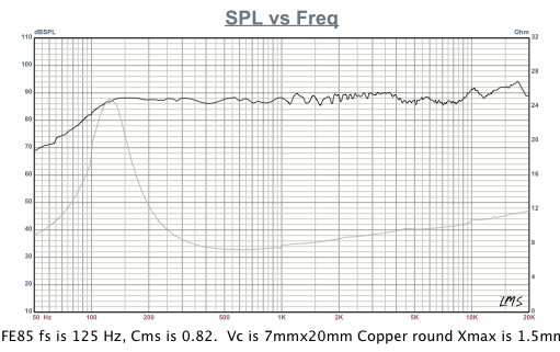

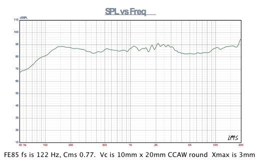

I am wondering if the cluster of resonances are the result of somehow faulty cones or if they are somehow caused by the reduced compliance in the spider and the longer VC length used to get the larger Xmax of the FE83 as compared to the FE85. The faulty cone theory might explain why these are in the buyout bargain bin. It is hard to imagine why the factory wouldn't have used he same cone on both drivers, but maybe they had a batch that didn't meet specs and so here they are on clearance.

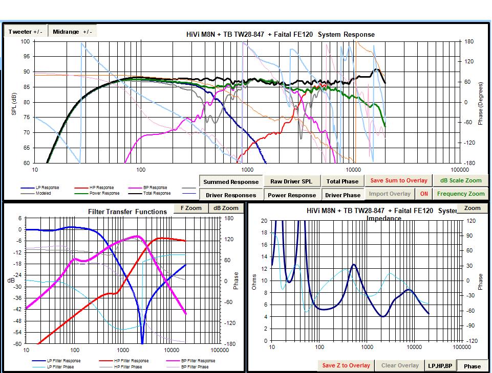

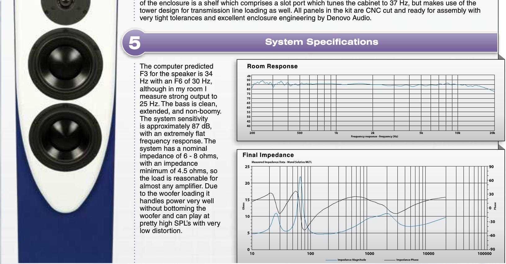

I think you've got the impedance thing. Below is an example. Blue is modeled in a sealed box and grey is the measured infinite baffle impedance response. Just a small difference this time but I would still modify the blue curve to match the grey one from about 1kHz to 10kHz especially if you were crossing over at about 3kHz for example.
You can use the spinners for the Le coeff. and/or expon. to make the changes and/or you can use the equalization modules to the left.

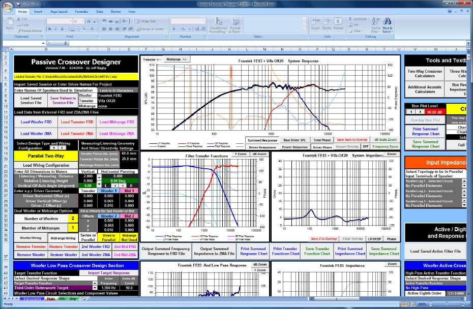

A simulating adventure
I have now spent some (quite a bit of) time fiddling with the driver data set up in the BSD and FRM programs. Note that for the tweeter I traced out curves from Zaphs pages where he made measurements on the Vifa OX20 in a 45 degree bevel since I plan to use the tweeter in some similar waveguide offset. Recessing the tweeter already causes some drop in the high end. I initially set 3rd order Butterworth slopes as target values and played with crossover points in the 1.8-3 kHz range. I found that I needed a notch filter on the tweeter resonance peak at 1060 Hz to get a decent match to the target slope and a good summed response so I have kept that in through all further digital experimentation.
I started with the assumption that I would need second order electrical filters to match the target curves (acoustic responses). That works out pretty well for the woofers but for the tweeter I just couldn't get a match unless I took it to third order electrical. And then I finally found that the rising response of the FE83s above about 8 kHz was causing some cancellation of the high frequencies produced by the tweeter. I found that adding another cap to the mid circuit brought up the sagging top end response. Just a Zobel plus 2nd order electrical wasn't enough.
Now working with 3rd order filters I find I can get a very nice summed response and a pretty smooth relationship of 90 degs relative phase difference between the woofers and tweeter through the crossover region with the drivers wired in normal phase. If I understand correctly this is the original D'Appolito configuration. I have attached screenshots of these simulation results. Layed out like this the impedance drops to about 2.5 ohms at one point. That seems pretty low. I'd be interested in suggestions about how to bring that up without upsetting he overall plan too much. Another improvement might be to somehow move the point where the woofer phase starts climbing to extend the region of 90 degree overlap as far as the tweeter phase response allows. Does the Zobel compensation affect this?
Also, in general the numerous small peaks in the FR curve of the FE83 are amplified when using two of them. I think I will be doing some experimentation with cone stiffening/dampening tweaks to see if some of this can be cleaned up. These curves could look a lot better if I were working with the FE85s frequency response for instance.
Just some quick observations.
- the acoustic center of the Founteks should be in negative units
- the phase should always be aligned in the xo region.
- the xo point looks like a good one for the drivers
- this can vary with how much LF you want, but it looks like the speaker sensitivity is too high at about 90dB. The Founteks look to be at about 84dB in the midrange, so 2 in parallel should get you 90dB but then you should be fully compensating 6dB for baffle step loss (bsc) so the PCD summed response should be closer to 84dB than 90dB. I think your tracing is probably accurate so what you need to do is bring the level down more on the FE83's with a bigger inductor to start off with. You usually look at about the level at 200Hz and then set your target for that dB level, which looks to be about 85dB.
- bringing the FE83 levels down also means that you'll need to add resistance to bring the tweeter level down as well. That will raise the impedance on the tweeter anyways. But I'm not sure which driver is the culprit here (or both) in your low impedance result as you haven't got the filtered impedance curves turned on for either of the drivers.
- a fairly low inductor value of .13mH for L3 on the tweeter can also bring the impedance levels down
- experiment with resistance in either of the drivers' parallel legs. It can be quite useful in shaping the response and in fine tuning phase.
- I'm not really sure that the tweeter needs the impedance compensation filter. The impedance peak is not really excessively large at about 12ohms. Maybe move the xo point north a little bit if you have to or if you can.
- I'm not really liking that 5500Hz peaking on the tweeter and the drop afterwards. I would perhaps start by trying to drop it via baffle diffraction though I'm sure you've spent lots of time on that already. What are the baffle dimensions and driver positions you decided upon and how did you solve your modeling dilemma?
- and just sort of a common sense thing: try not to make your xo too complex when working with inexpensive drivers. You'll end up spending way more on xo parts than what you spent on drivers.
Despite all that, I'd say your learning curve is moving along nicely.
- the acoustic center of the Founteks should be in negative units .

I have not done anything for BSC in this case since the plan is to use this unit as the midrange section of a 3-way. I was lucky that the mids and tweet came out at the same level without any padding resistance. Thought I'd leave that alone for now, until I decide at what level I need them to be for the low-to-mid X/O.
Ah, I missed a trick there. Next time I get at the PC for a while I will find and turn on the filtered impedance curves. It will probably answer my question...
I am amazed at how much this PCD spreadsheet does!
I put that in there because I was trying to get rid of a knee in the roll-off. It might not be needed for that at a higher X/0 frequency, but lower is better in view of the M-M interactions.
I'm not liking it either. I think this comes from the fact that I used the curve from Zaph's site where the OX20 was mounted in a shallow waveguide here in the PCD simulation, but I did not use that curve when I was playing with the arrangement in BSD modelling. I will need to go back and optimize with the waveguided version of the OX20 curve before any final decisions are made on the physical arrangement. The OEM curve, presumably on a flat baffle, just has a rising response from 15k Hz to the end.

Don't fall into the trap of thinking that the system impedance needs to be flat. The Rocky mountains is fine for today's solid state amps as long as the minimum impedance is above the amps minimum and the impedance phase isn't going above/below 60/-60 degrees.
Below is the chart for Jeff B's latest design (he's the one who wrote the PCD software). Impedance (blue) is actually fairly mellow but it's certainly not flat. And rising in the top end is no big deal. The FR is flat and that's what matters.
And the 2nd pic shows a 3-way I was working on lately. That one was a little challenging as they weren't the easiest drivers to work with but that still shouldn't be a problem for an average amp.
One other thing to watch for is that a low impedance phase around -60* doesn't coincide with a low impedance at the same frequency - that can be a tough load for an amplifier.
