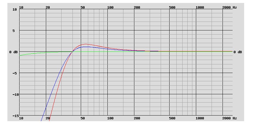

4.5ft³ = 127.43L
AURA SOUND NS18-992-4A, VB = 127.0 L, QTC = 0.928, F3=31.8 Hz (free field).
Note. Not advisable, the driver presents a peak of ~2dB@50/60Hz, unless you know what you are doing. It requires filtering and controlling amplification and frequencies. Might become a problem to match with the lower frequency subs in a bigger box unless they are independently controlled.

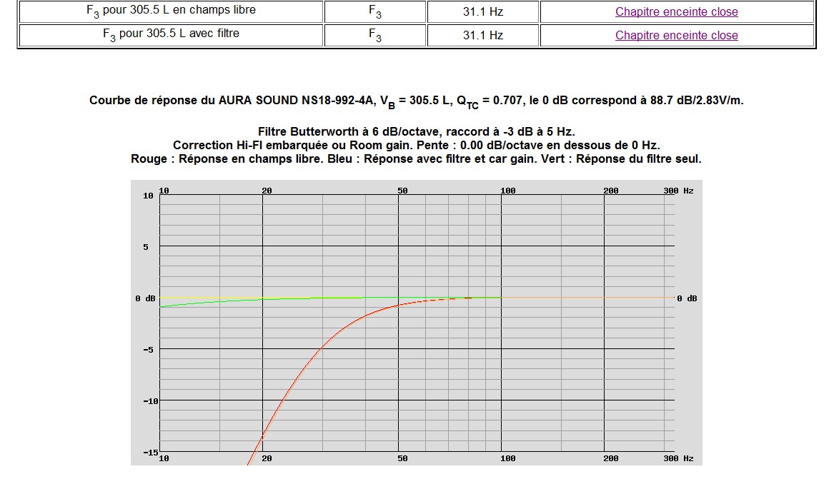

1. AURA SOUND NS18-992-4A, VB = 305.5 L, QTC = 0.707 (acceptable or ideal) :yes:
(305.5L = 10.789ft³)

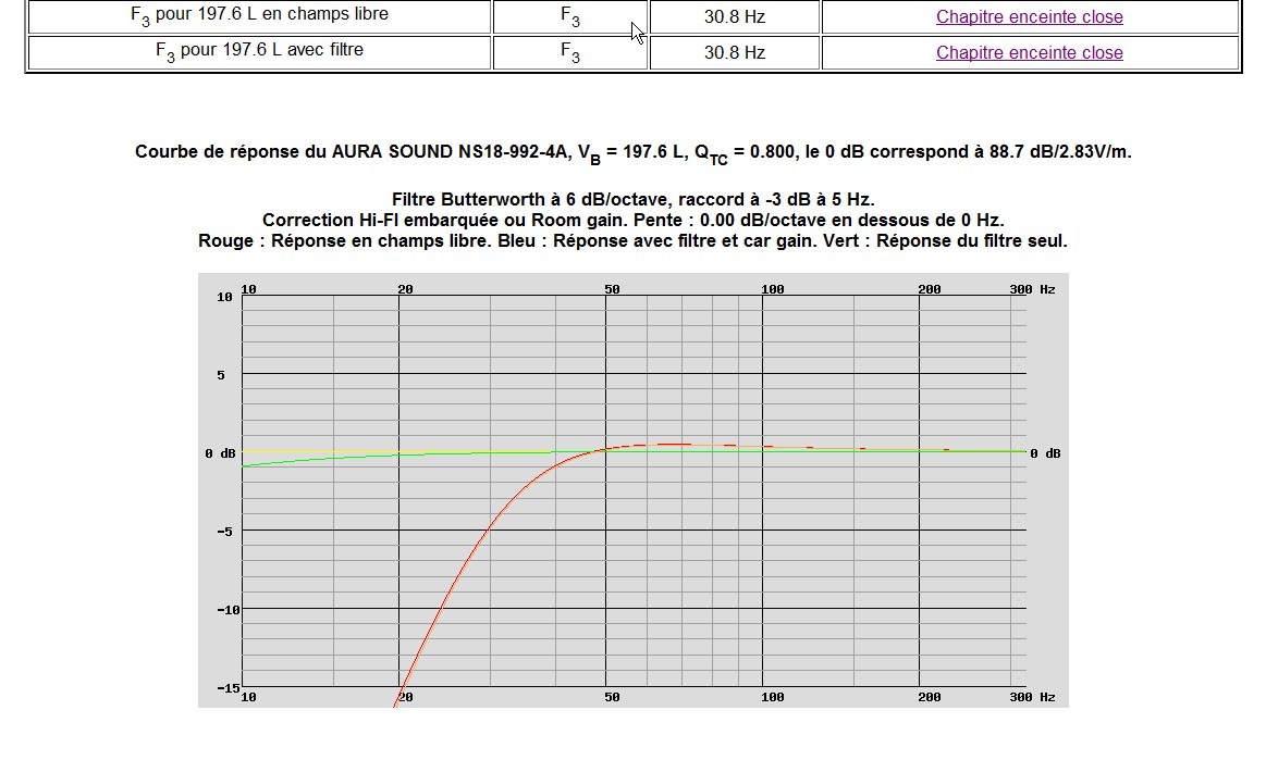

2. AURA SOUND NS18-992-4A, VB = 197.6 L, QTC = 0.800 (+/-, not ideal) :xfingers:
(197.6L = 6.9782ft³)

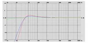

3. AURA SOUND NS18-992-4A, VB = 169.9 L, QTC = 0.839 (bad) :down:
Hope this helps, now is up to you...
  • 1. AURA SOUND NS18-992-4A, VB = 305.5 L, QTC = 0.707, le 0 dB correspond à 88.7 dB2.83Vm..jpg

  • 2. AURA SOUND NS18-992-4A, VB = 197.6 L, QTC = 0.800, le 0 dB correspond à 88.7 dB2.83Vm..jpg

  • 3. AURA SOUND NS18-992-4A, VB = 169.9 L, QTC = 0.839, le 0 dB correspond à 88.7 dB2.83Vm..jpg
