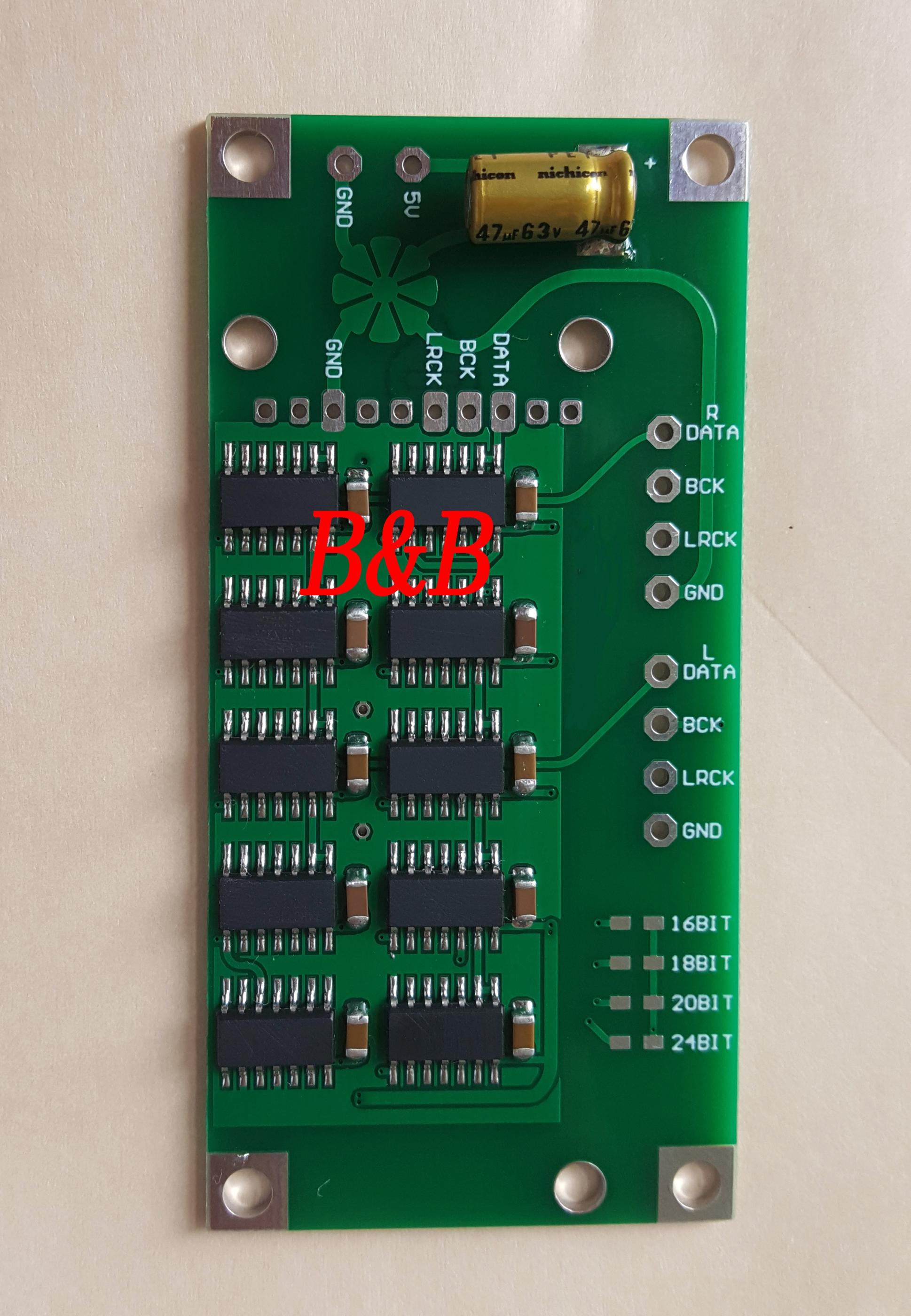

Can this I2S board connect to 2x PCM63 directly?
Pin18 clock and pin 21 data
How to
