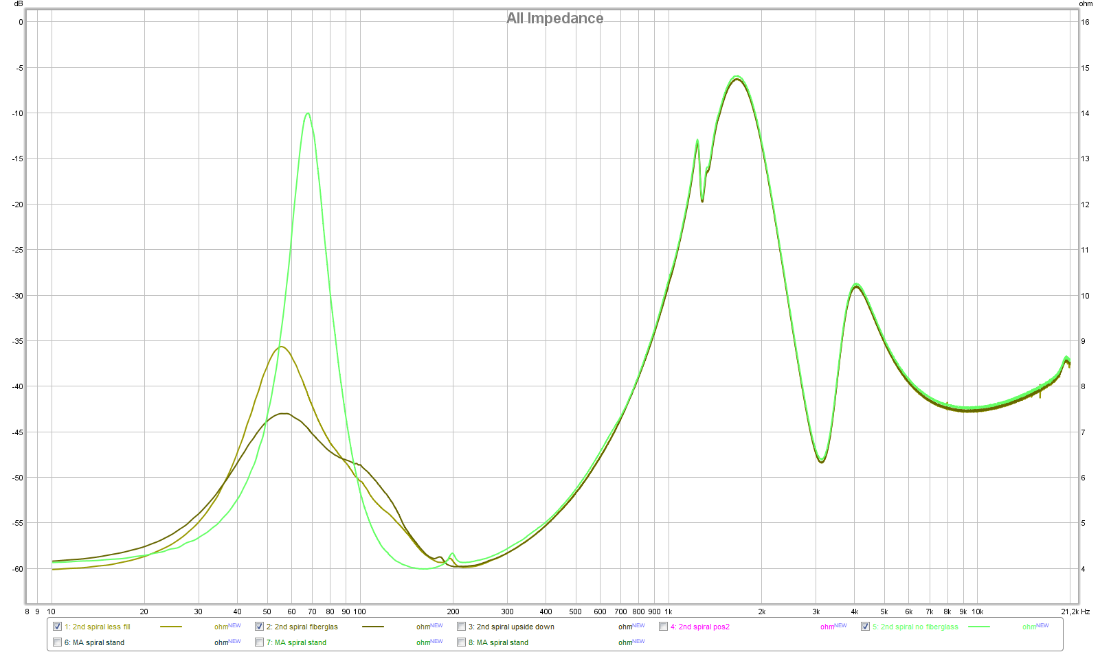

No fill comparison to no fill first spiral:
Looks close enough considering the difficulty of making these cabs identical.

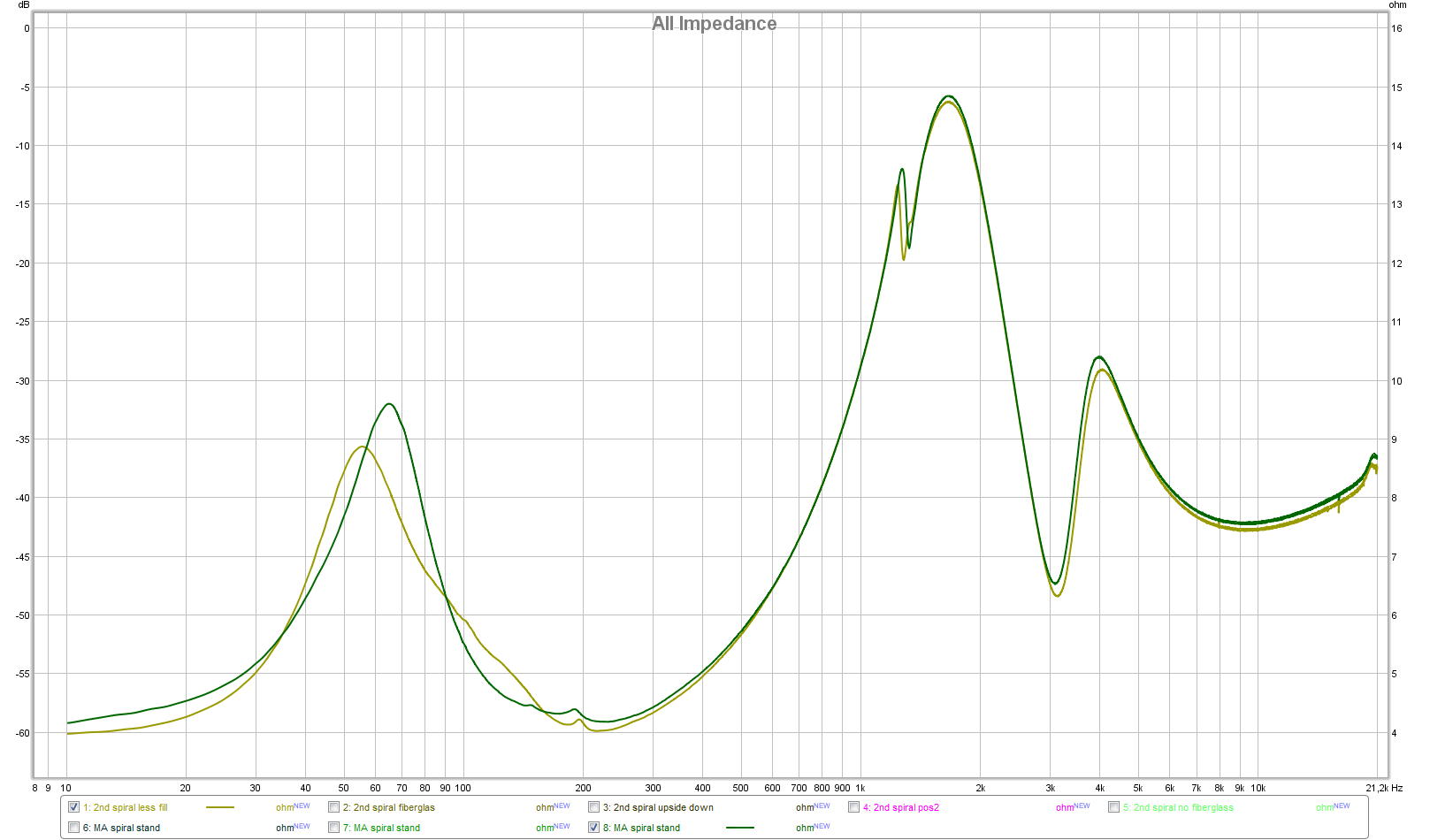

Different amounts of stuffing:
The first time I filled the second spiral with fiber glass I packed it a bit resulting in the huge shoulder at 100Hz. I remeasured the impedance with the enclosure upside down and at another location with the same results. Thinking I might have some weird resonance caused by not tightening the driver enough or something I removed and double checked everything and took out a bit of fiberglass resulting in the "less fill graph".

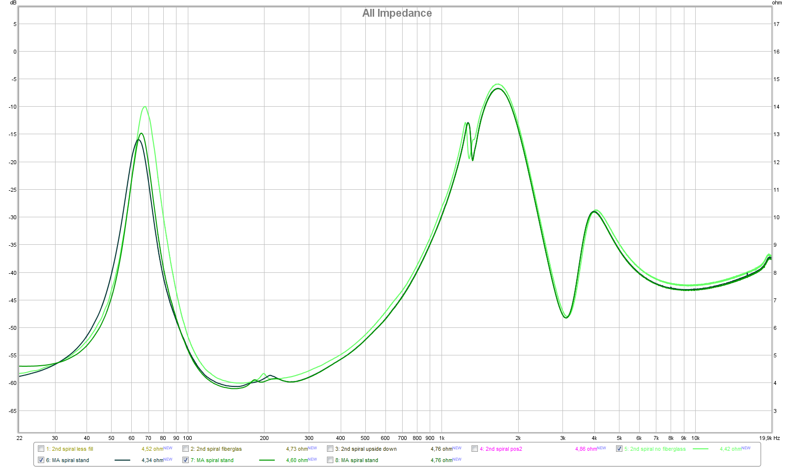

Comparison between first spiral with polyester mat filling and 2nd spiral with fiberglass filling:
I listened to these 2 extensively (mono signal and fast switching between the two spaced 20cm apart) and I have to say I can't really hear a difference.
I also noticed the little hump at 1.3K is still there, I'm still using the original wires so I haven't sealed the compartments with silicone, I'm hoping it goes away when I do. Otherwise I have no idea why it was gone with the first spiral.

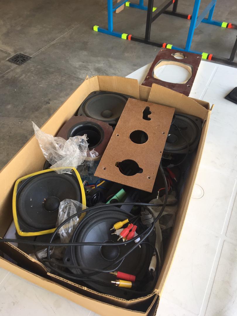

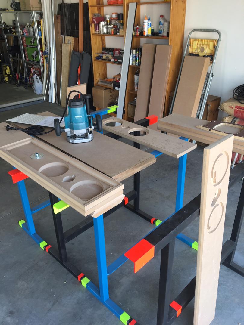

I have started about two months ago with my own speaker build DIY project.
I am using a set of Boston Acoustic VR1 speakers. I removed the drivers, ports, XO's and stuffing. The arrangement of the VR1 is TMM. My speaker build is a MTM arrangement and I do not know what to expect. I will use the exact same drivers and crossovers for the new cabinets.
It has taken me an afternoon to cut all the 22mm MDF panels, but now over six weeks to build a router jig to cut perfect circles. Every circle is either to big or two small by 1mm or 0.5mm....it is the most frustrating thing as I expected to take 5 days to build these new enclosures. I have given up many times, but the VR1's are completely cut up and I just must finish it.

Don't give up! This is my first time with a router and a hole cutting jug too. I bought a commercial hole jig and it works very well. The trick is to have a backing sacrificial board that is screwed to the baffle being cut.

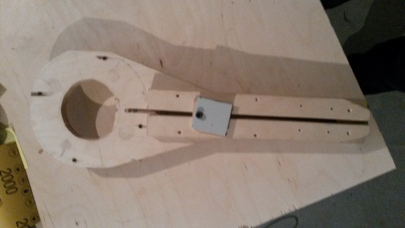

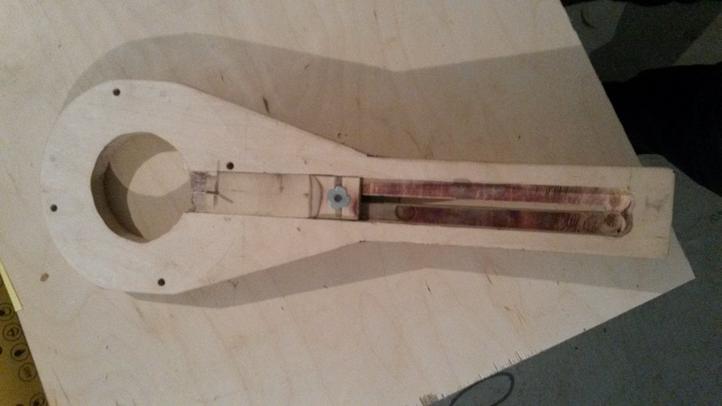

Some pics of my homemade circle jig made from leftover pieces of Birch ply using the router and a saw:

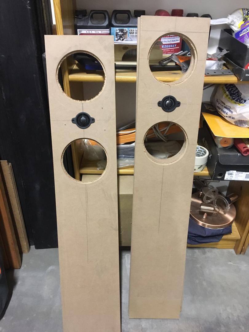

After 3 years, I am back!
Project stalled...in the meantime, I remodelled my house and built a new garage to carry out my hobbies...

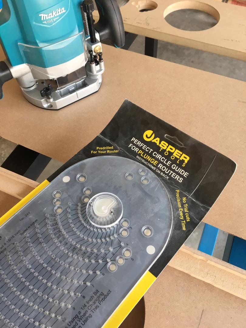

In July 2017, I bought the Jasper jig and a new router....they came out of the box last week for the first time...
After making many mistakes and destroying one MDF board after another in 2016, with the Jasper, life was much easier...I have made good progress...I have been able to seat these odd-shaped tweeters....the woofers also fit perfectly...
