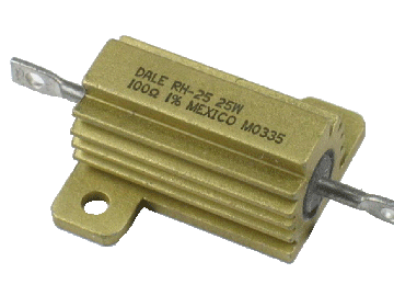

Roger, I'll take up your advice on not mounting the resistor across the capacitor terminals. I didn't think of the heat issues - I assumed a heatsinked wirewound resistor (as shown in the picture below) would take care of the heat dissipation issues! Also, thanks for showing an example of how to calculate the rails fuse.

Of course if you are remote mounting those resistors to a panel or something they could be connected to the cap as not much heat would go through the wires. I assumed you were talking about the typical sand cast or axial types mounted with short leads right on the cap pins.
I do hope that isn’t the actual resistor you are thinking of using. 100 ohm is way too low of value and will waste around 20 watts each. A value like 2000 2 watt would be far more appropriate using only around 1 watt. Anything from 2k to 10k will do fine with out generating excessive heat.

Sorry for the confusion :) I calculated for a scenario of about 60V DC between one of the rails and GND:
1. Using a 10k resistor to bleed, say, 2x10,000uF capacitors would require the resistor to be rated atleast 1/2W (double that to 1W) and it would take about 35 minutes
2. Using a 1k resistor for the same would require the resistor to be atleast 4W (double - 8W) but the time taken would drop to about 4 minutes
I am going for a longer discharge time so my final choice would be closer to option 1 (use a 2W or higher rated resistor as you suggested).

Discharging to safe levels and not to zero is what you are after. The times you stated are much longer than to a safe level. Even 6 time constants should be conservative and would give a time value 1/2 what you called out. This exercise does give one a good feel of just how much energy is stored in these caps. Certainly not something you want to dump across your test probe!
