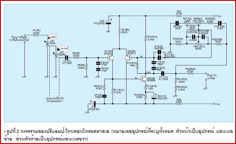

About the transistor tone control i posted earlier.. considering its low output swing (+-5V), I think it would be better to lower the boost/cut db to about +-8dB or thereabouts...with original values the boost/cut is about +-18dB. I dont think we generally need this much...
i will try to recalculate values for +-8dB boost/cut and a center frequency of 1KHz according to this :

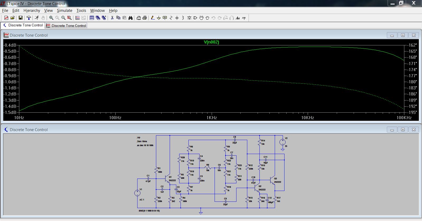

so what cut /boost do you suggest? +-15dB? +-18dB? I played a bit with lt spice and i came up with these values for about +-12dB cut/boost...
Administrator
Joined 2007
Its very subjective really but those do look respectable enough curves.
The problem with all these type of circuits is that they alter the frequencies a long way to the side of where you really want the boost or cut. For example if you want to boost around 30 Hz then even frequencies as high as 300hz get some boost too. You can't really escape that with this type of circuit though.

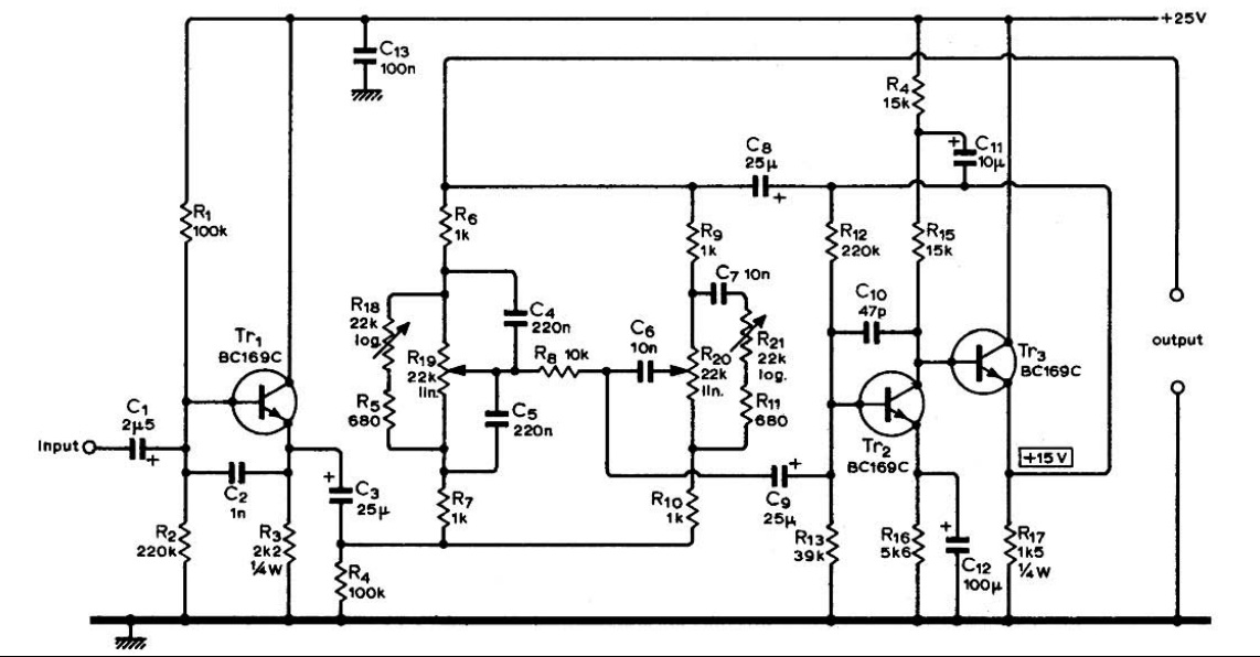

Hi Maouna,
I just stumbled across this thead agian and thought I'd add my $0.02.
I'm not sure why you would want to build such an old design, nostalgia maybe? But this a pretty bog standard Baxendall circuit, and in my opinion that design leaves a lot to be desired. Worst thing about it is its' inherently shallow slope filters which usually can't even achieve a 3dB/octave slope. Because of that issue, attempting to make adjustments to bass or treble frequencies will also modify the mid-band, and that is not what we normally want. For more info, check this out: http://www.rane.com/pdf/acceler.pdf
