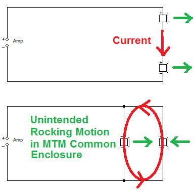

Back on-topic. IMO, series wired basses in a common enclosure work much better than parallel wired.
622595d1498272084-3-project-mtm-bass-loading-current-png
Any 18-y-o Physics student knows about Coupled Pendulums. And what the Physics tells me is that even the best amplifier in the World has no control over this coupling with parallel wiring. The basses actually take turns in doing the work. Which increases excursion and, hence distortion.

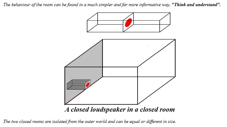

If you really think about it, and Steen Duelund did, it makes no difference if the damping is in the speaker box or the room:
637644d1506558339-8-duelund-woofer-steen_duelund_diagram-jpg
My Brother-in-law employs similarly minded Scandinavian engineers to line his walls in tapered rockwool around the drivers to get the nice sound.
Isn't the lesson to just use stiffer string if you're going to dangle your woofers in the air? I'm calling shenanigans.
Most ideas in audio are really take it or leave it. It's up to you. :D
But I think you would concede that if you have two woofers in a closed box, if you push one in, the other will pop out. This is my notion.
What is good about twin woofers wired in MTM or even MTTM series is they have equal loudness in the room whilst getting a quarter of the power individually, so distort considerably less. Two 4 ohm basses in series have a certain appeal.
Bottom line is we can get 6dB more loudness with MTM. Albeit more focussed horizontally, or cylindrical on dispersion to be precise. The PA principle which leads to 2X 12" basses or even 4X 12" stacked basses for bass guitar.

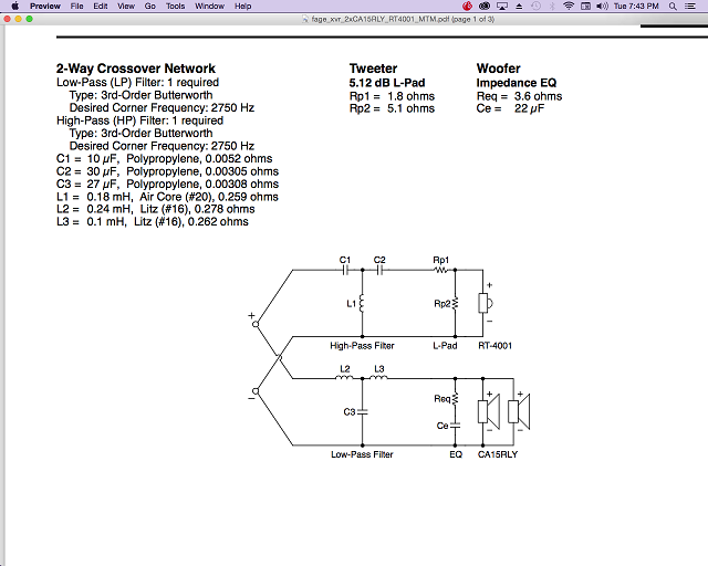

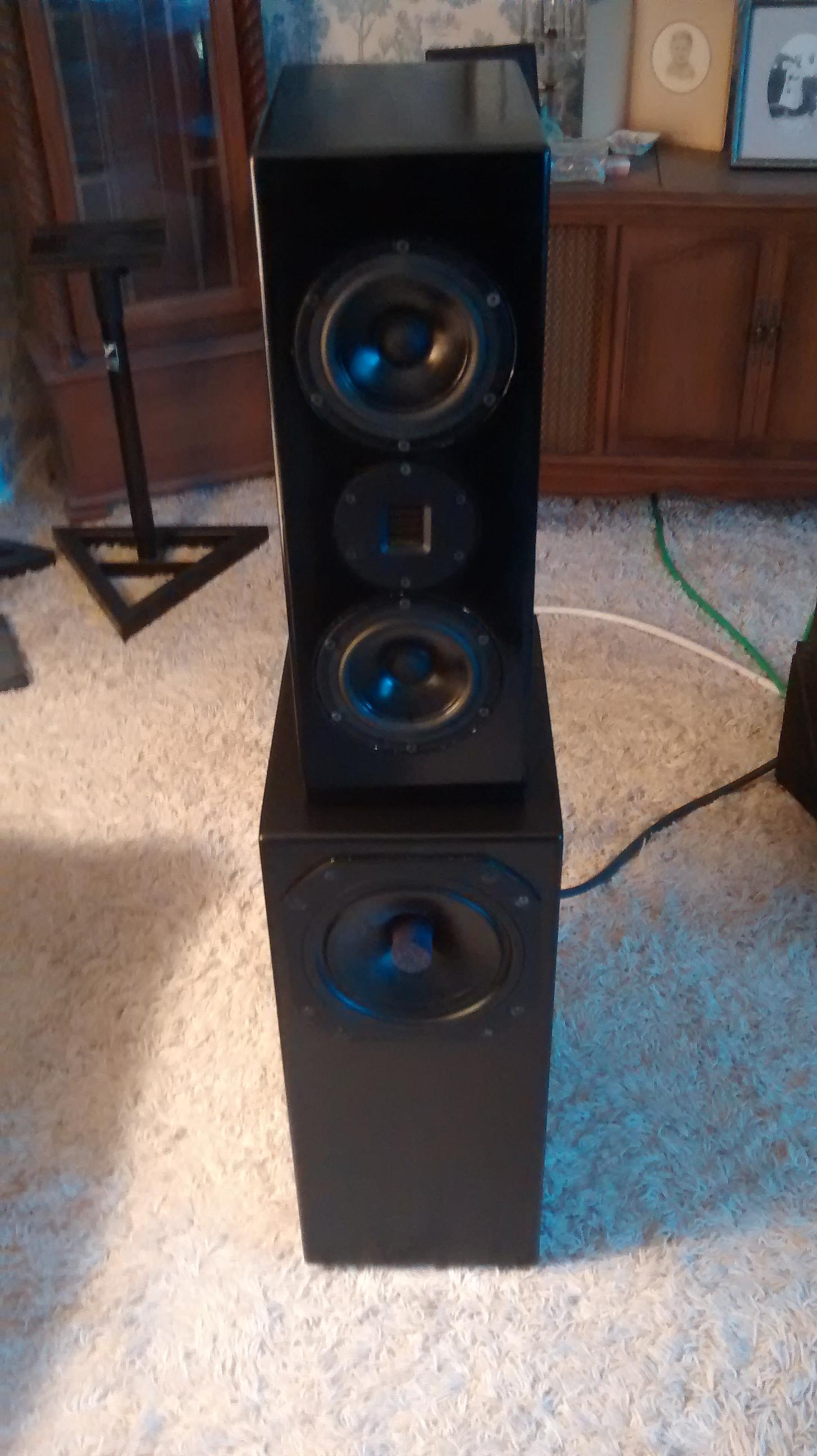

ShaneF did a terrific 5" SEAS CA15RLY MTM with a RT-4001 ribbon tweeter here:
562760d1470064509-seas-ca15rly-x2-cabinet-volume-suggestions-img_20160801_090130150-jpg

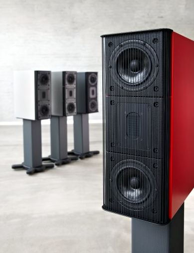

Of course he, wasn't going to go far wrong imitating the tested Gryphon Mojo:
544046d1460862112-seas-ca15rly-x2-cabinet-volume-suggestions-gryphon_mojo_duelund_loudspeaker-jpg
A lot to like there. The crossover suggested by Solen of Canada was an interesting third order design. No bafflestep worth mentioning, but you can add that if you want: mh-audio.nl - Home
These 3rd order designs with a 5" might work even better if you recess the basses to the back of the baffle and employ negative polarity. A standard BBC technique.
