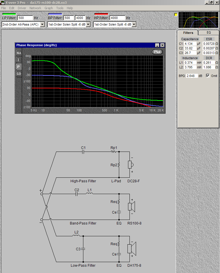

I was just testing my most recent set. It uses second order electric in combination with the natural roll offs for effective 4th order at only 1700. (modification to the Zaph SR-71). At my listening levels, it works. I would not push it really hard though.

I always use 1st order slopes on my tweeters. You need decent quality tweeters, preferably underhung with good Xmax but generally it's no drama if you deal with the impedance resonance.
Typical average power is <1W for most listening.
Power is not much of an issue. Say you have 1st order at 4kHz and feed it 2.83V RMS at various frequencies:
4 kHz : -3dB => 0.5W
2kHz : -6 dB => 0.25W
1 kHz : -12dB => 0.06W
500Hz : -18dB => .015W
Nowhere close to frying a tweeter especially since the majority of music energy is below 500Hz.
As for excursion, a decent 25mm with first order at 4kHz will stay within it's linear range below 100W. The other drivers in the system will be distorting before the tweeter does.
