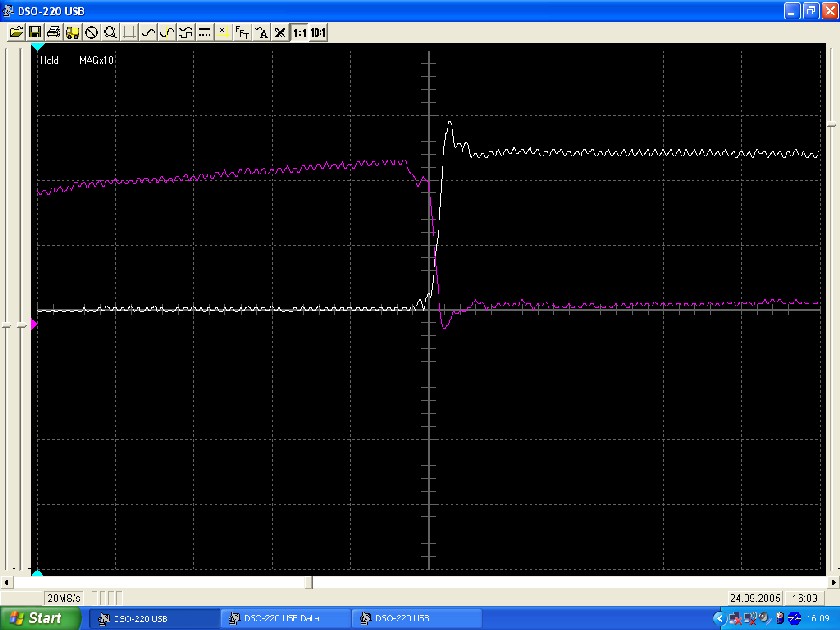

1kW PFC-Boost
Turn OFF in detail:
The white trace is the Drain voltage vs GND, 200V / Div.
The coloured trace is the current: 6.4A / Div.
Time base: 500 ns / Div.

These waveforms look right to me. In order for gate ringing to happen you need excessive inductance in the gate drive wiring, I would try to improve that if I was you.
How did you manage to blow that little IGBT?
In such a slow-switching circuit you could even use medium speed IGBTs, those that feature only 1V or so voltage drop and 100 to 200ns smooth rise times, or even bipolar transistors xD
I've been doing a lot of work in the 15V 120A prototype, I will post details soon to let you see how much performance could be obtained from four bipolar transistors worth not more than 5 euro in total.
I don't think that this set up has high inductances in the gate drive.
...well, at least there is no space left open. The loop area is about
80mm^2, mainly shaped like 2x40mm side aside. (Base from the most far away PNP ==> emitter resitors ==> both gates ==> both sources ==> source resistors ==> GND foil backwards to the collector of the PNPs==> base).
The ringing was one or two times "pull up slash back", at the moment when the drain jumps upwards. Feedback through reverse capacitance of the MosFets.... Gate drive resistance seemed to be the only key to improve this.
I tried to simulate this, as from theory already the reverse capacity with the intrinsic MosFet gate source capacity and inside inductance could cause ringing. During turn OFF the MosFet is acting like a normal
amplifier with cap. feedback and inductive load...
Well the simulation did not show any ringing. Even not with additional
inductors in the gate grive. Theory vs. reality... ;)
The IGBT simply died, without obvious reason.
But quite spectacular... :rolleyes:
The wave forms looked not perfect, but acceptable at that moment.
Peak current was around 6A....
I just wanted to measure the temperature with my infrared themometer, ...touch free measurement... - ZONK !!!!
....some seconds later, after my heart started beating again, I went on to measure the temperatures of the carbonized resistors and found them at 58°C (burned & open)... the IGBT around 50°C (blown: C-E shortened, gate open)....
Do you think there might have been some critical reverse load for the IGBT? I did not place an external diode between C & E.
...or voltage overshoot above 600V...( did not look to this value very detailed)...
Looking forward to your 15V/120A PSU.
...picked up the topic again.
Even if the inductances were already small, this circuit has to handle quite high di/dt. Something like 700A/us !
I derived a further reduced inductance of the gate drive loop by paralleling another GND foil on the second side of the driver transistors.
Now the MOSFETS can turn of currents above 20A within less than 30ns without bad ringing.

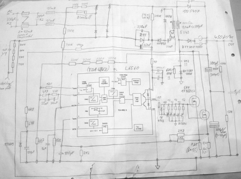

Furtheron I corrected an error in the schematic: Feedback from output was drawn wrong, while I assembled my proto correctly....
Last but not least I optimized the regulation and reduced the output voltage down to 450V.
450V has the advantage that each e-cap can handle the full rail.
I prefer this, because I want to run a halfbridge converter from that and connect the cold end of the transformer to the center tap of the caps. If something goes wrong the center tap might be pulled to one of the rails and the e-caps will see full output voltage, not just half.

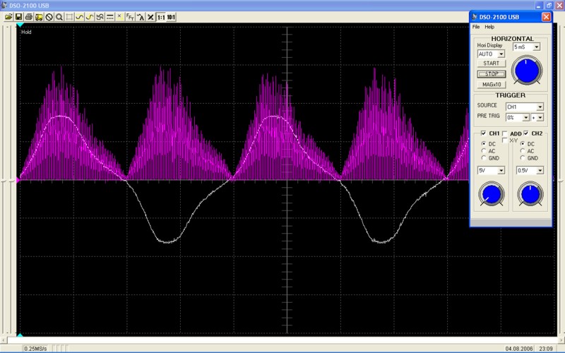

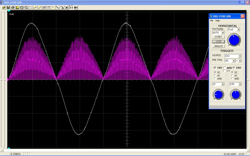

Current wave shape is quite nice at 120V.
Input: 120V/50Hz
Output: 500W
White trace: Line current 2A/Grid
Red trace: PFC choke current 6A/Grid

Hi Chocoholic. Congratulations, that's a nice job. However, those average current waveforms are not looking too well. I will try to get some captures from my continuous mode L4981 based PFC so that you can compare.

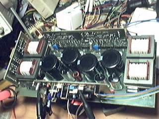

BTW: The 120V 20A AC class D amplifier is almost finished, this is how my prototype looks like:
....looking not to well...
Hm, at 500W/120 it is looking almost perfect. :confused:
The difficulty was the trade off between wide input voltage range (which is influencing the gain of the forward transfer function).... extreme load range between zero and 1kW and my ears, which can hear the PFC working and are very sensitive to regulation modulations or even worse interuptions.
Originally I adjusted the regulation loop to get a nice sine wave also at 230V, but for this I had almost no P portion in the feedback loop and real integral (instead of two staggered PT1 ) .... resulting in quite poor regulation of load changes and interuptive operation at high input voltages at low load....
Also then I was not able to provide the 700W at 120V anymore. Now the P-portion of the regulator is pushing the current wave shape from sinusodial towards trapezoid shape in order to draw more current from the line, if the output starts to drop in a unpleasant way.
How did you solve all this without trade off in the THD? I thought these relations would be a fundamental drawback of this topology. Instability at low load is mostly caused by the two integrators. First integrator is the output cap with current feed and second is usually the integratot of the regulation loop.
And if you do something else than a slow integrator in the regulation, then you will not have sinusodial line currents anymore, because the regulator might act within each half wave.
Things are getting easier, if we move to large output caps.
As soon as remarkable changes of the output voltage are slow compared to the line period, we could use a slow PT1 regulator without violating the sinewave.
But who wants to use several thousand uF/450V....
??? :scratch1: ????
You solved it? ...you are starting to threaten me !!! ;)
Hi Chocoholic,
I agree with Eva that your Haversine looks a bit strange. I would expect it to look more sinusiodal. The distortion looks rather large?
In my experience, load regulation is very poor when the PFC is working well. I let the OVP do it's work! Trying to compensate for reasonable load regulation upsets the modulation.
