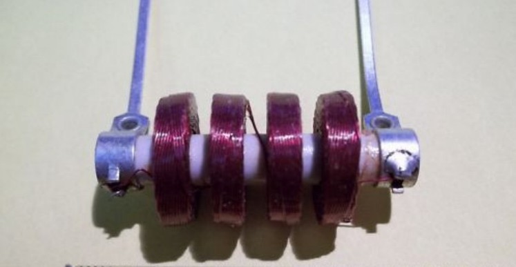

Hi diy's,
I'm looking for a way to make a 1Gohm or preferably higher value resistor (low wattage). Any of you have experience with this?
Might I take an older carbonblock resistor and scrap away the surplus or is there a more feasible way to do this? Please note that it is not an option to buy materials for this so need be surplus, second hand, things for waste, or the like ...
Suggestions are appreciated,
Greetings,
Jesper
P.S.: It need not be more precise than 10-15% and temperature stability is less important.
You can make a very high gigohm resistor with a suitable ceramic form and India ink. I once made one from a choke that I unwound like to one below. A single straight line or multiple lines will do it. The more ink you use, the lower the resistance. But I'm talking very high resistance, and you'll probably need a good megohmmeter to measure it.

Like hollowstate suggested, a lot of materials can be painted, sprayed or drawn upon an insulating carrier. Inks, antistatic sprays, wallpaper glue (methyl cellulose), etc. etc.
You need to experiment with dosage and concentration to get the right value.
Another possibility (also for higher wattages) is a saline solution in a glass tube with metal end caps.

i'm thinking a #3 pencil lead turned on a lathe...

1G resistors are about $3-4 Digikey or ebay. For homemade, pencil lead sounds like the most promising idea.
Test: hook scope (or other meter) across a 10M resistor and hook it in series to your 1G resistor, and hook the series pair to a source (battery, tone generator, power supply). Measure voltage across 10M to calculate current. Measure your source voltage. With V and I calcuate your R.
