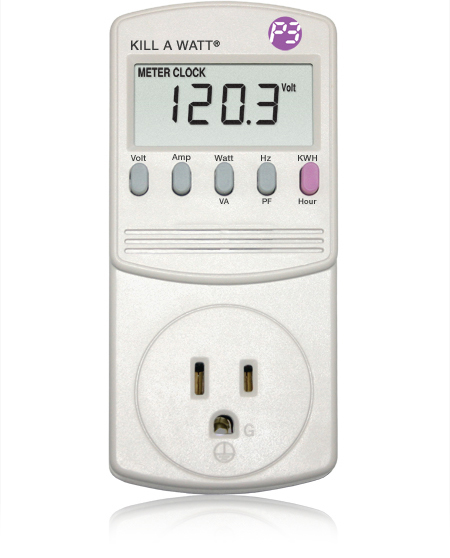

Not sure, how do you test the " no load input VA"?
Measure AC current and ACV with multimeter, V x A = VA.
The KILLAWATT a great power meter.
P3 - Kill A Watt
Thanks WSJ
I put a clamp meter on the phase last night and got,
0.7A x 230v = 161VA
Does that sound low?
I do know that when I fired it up on the variac without winding it back to 0v first it blew the fuse straighht away! hence the soft start!!
I measured my ALESIS RA150 amp at 66 VA, no signal.
4 ohms: 75 watts RMS per channel.
For the size of you trans, 161 VA is not too bad.
At my power cost, 161 VA would be about $12 a month running 24/7.
