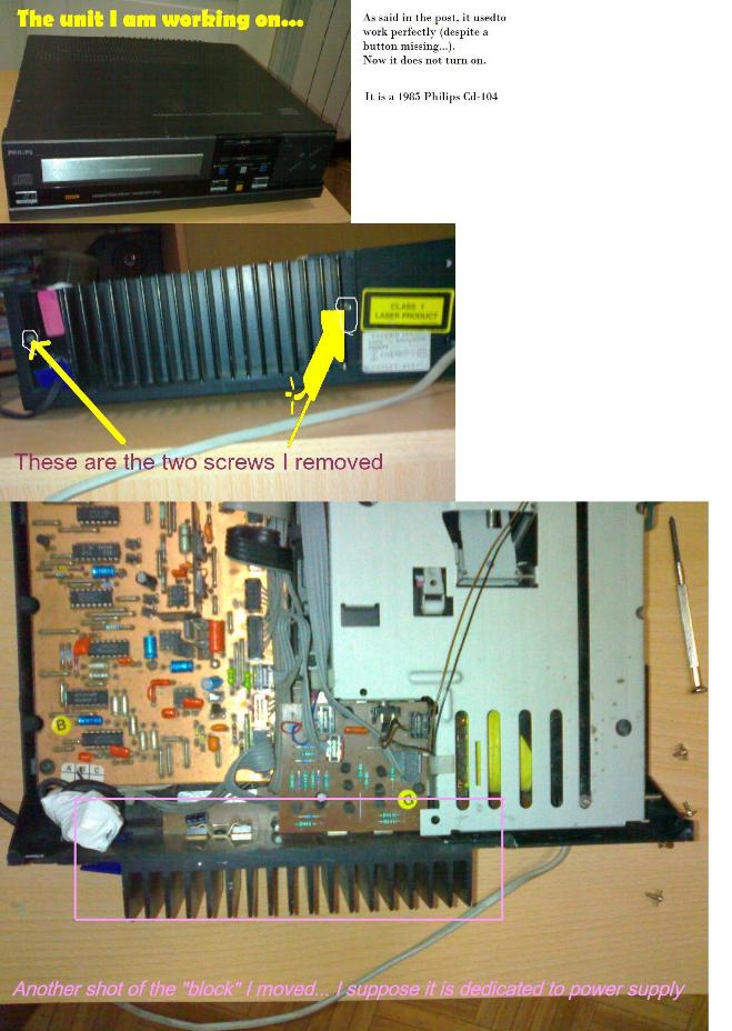

I am actually dealing with a 1985 Philips CD-104 unit. It used to work fine, until I opened it in order to replace the cables ending with the two RCA connectors... To get more room during the work, I removed the two screws which held in place the power supply "block", situated in the back of the unit... i didn't remove anything else. When I had done the job, I reassembled everything and replugged in the unit.
But... it did not turned on like it used to do... after pressing the "power" switch, nothing happened.
What should I do? Could you give me any advice to fix this issue, annd to get this wonderful player - which hadn't had any issue for 22 years - working?
Also I would appreciate if someone could send me a pdf copy of the service manual for this unit, in English or Italian... I read in an old thread that some users of this forum possess it...
P.S. I hope to have expressed myself in a good way (I still have to improve my English...). Anyway I've attached some images, to get it clear....
Thanks in advance for your support!

First of all, many thanks to Andy for his fast reply...
Actually, I didn't have to discard any connector (only changed the audio output cable and unscrewed the two screws in the back, showed in the picture...). So wrong connections should be to esclude...
I had already thought about checking/replacing fuses... but the matter is that I don't know where they're located (that is the reason why I've been looking for the service manual...).
Hoping that it is not a stupid question (it might be, as I'm not a pro in fixing these devices ), could someone tell me where these fuses are ? I don't want to risk to furtherly damage the unit while searching them...

Wow, that must be one of the earliest CD players! The big PSU heat sink in the back is a trip.
I'm asuming that you've followed the AC cable's path into the power transformer... that probably involves removing the aluminium shield that appears on the right in the back view. If you trace that wire through the trace and into the transformer, it should hit a fuse somewhere along the way. Assuming a fuse is the problem, that should be it.

Look carefully for wires that might have loosened, that sometimes happens with those old players when they get opened up.
