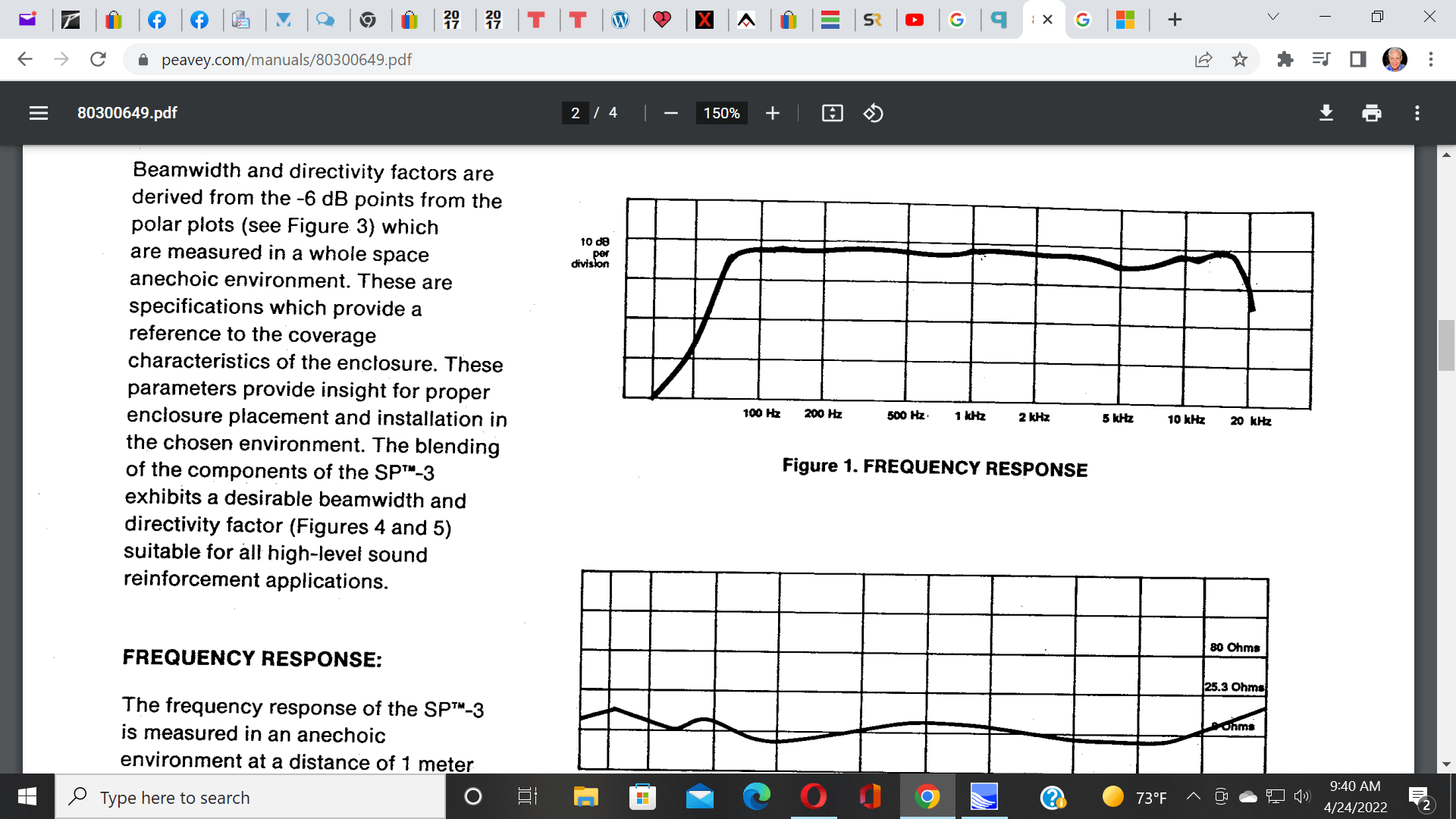

I think Peavey LIED to us about the Peavey SP3! If you look at the frequency response graph I posted of the SP3, it shows nearly ruler flat response, out to nearly 20K ! LOL, the Peavey 22A driver will not play out to 20K, and in the exact same horn, it shows a big wide rise between 2 and 4K. I have to use some EQ to get rid of this peak!
I can't see that you have ever posted any frequency response curve until post 19. I don't have documents of SP3 from the mid-80's and too late now. SP2-XT from 90's and SP2(2004) both show a dive starting at 14 khz up and spec is 3 db down 17 khz. All still use the RX22 titanium horn. Neither of which matter to me as my hearing has stopped at 14 khz since summer '69. (howitzer) .I think Peavey LIED to us about the Peavey SP3! If you look at the frequency response graph I posted of the SP3, it shows nearly ruler flat response, out to nearly 20K ! LOL, the Peavey 22A driver will not play out to 20K, and in the exact same horn, it shows a big wide rise between 2 and 4K.
Bumps and dips around crossover point are to be expected. Both the ones I've owned, SP2-XT (stolen) and SP2(2004) keep the crossover point between the +- 3 db brackets. My music room is much worse, and I have a lot of damping in the room. Carpet, acoustic panel ceiling, record & bookcases on all walls (full) urethane foam furniture a 2 organs with benches pedals & speakers. Here is the room with SP2(2004)on white noise.Mike rolls of @ 14 khz.
Nearly 99% of speakers on the consumer market use +-10 db as their frequency response band, and Radio Shack used +-20 db on one product I bought (headphones). Even JBL consumer was using +-10 db. JBL pro line was +-3 db last time I looked. Most vendors won't even tell you tolerance.
Speaker market is all smoke & mirrors at the consumer outlets. Even most reviews are full of adjectives, instead of data. Careful vendors like Home Entertainment (Houston) AR KLH go bankrupt and the name gets bought out by sleaze pushers.
