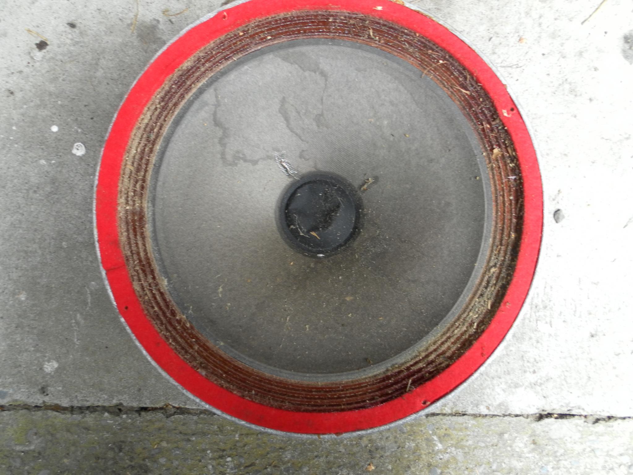

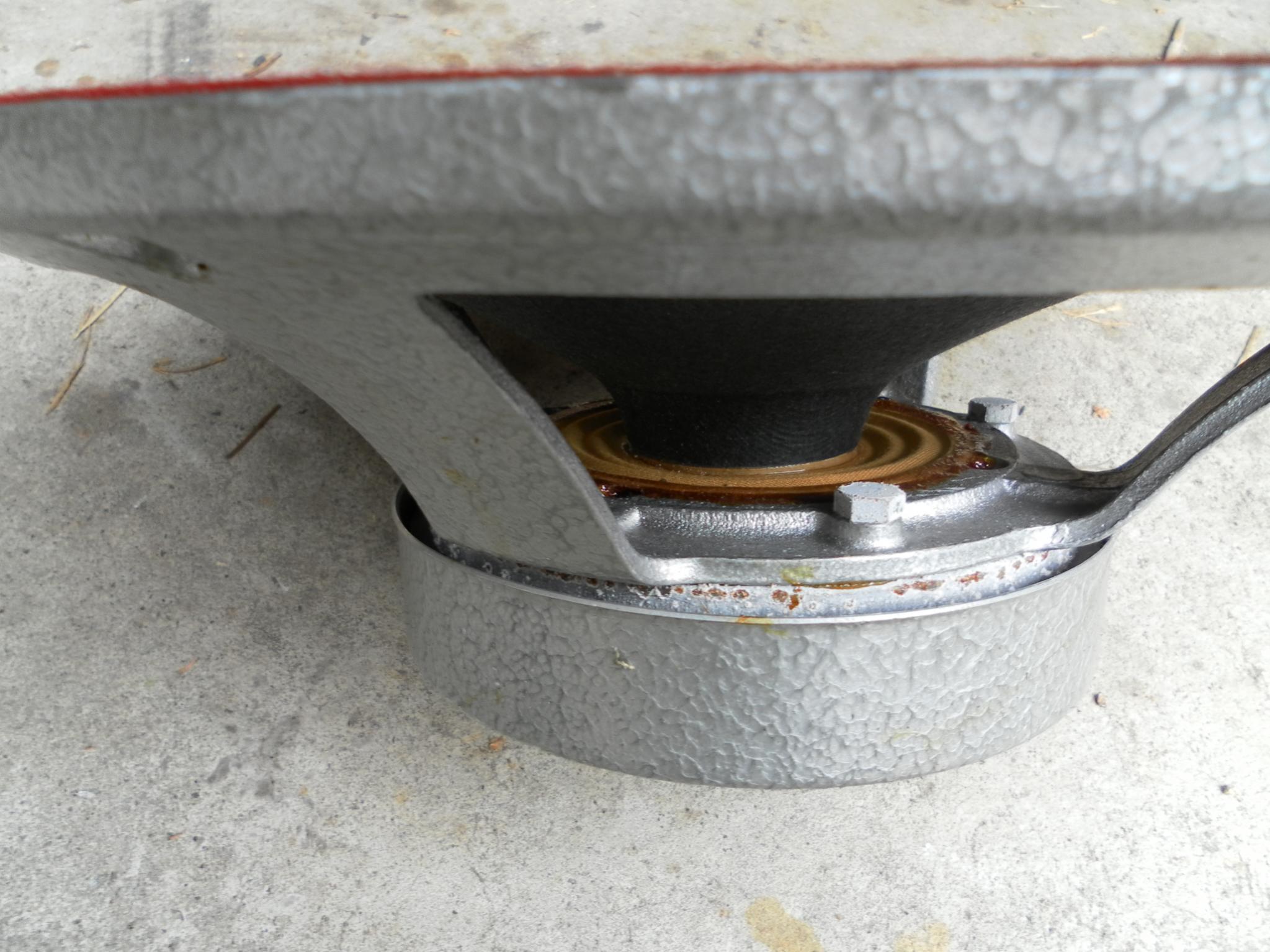

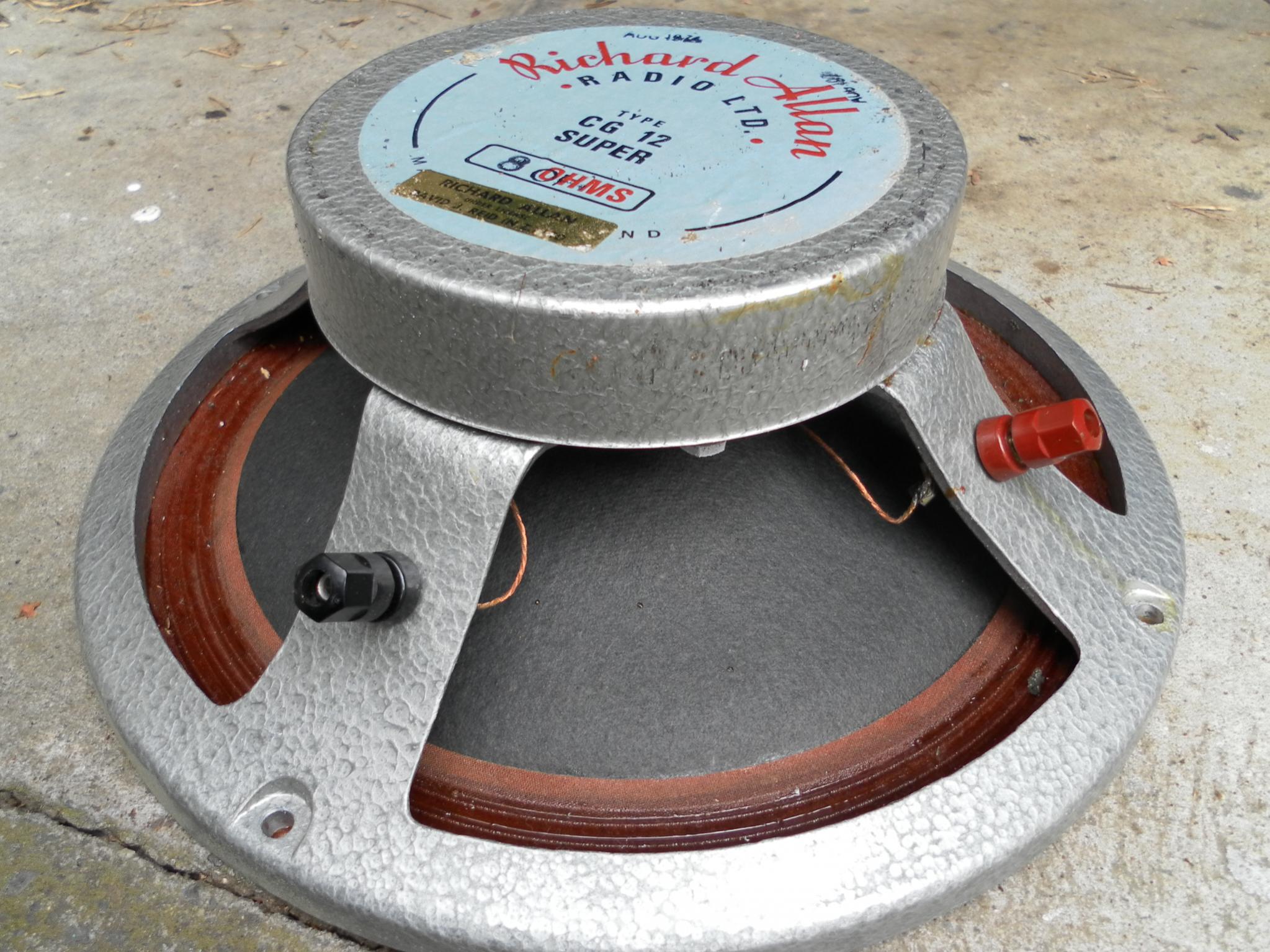

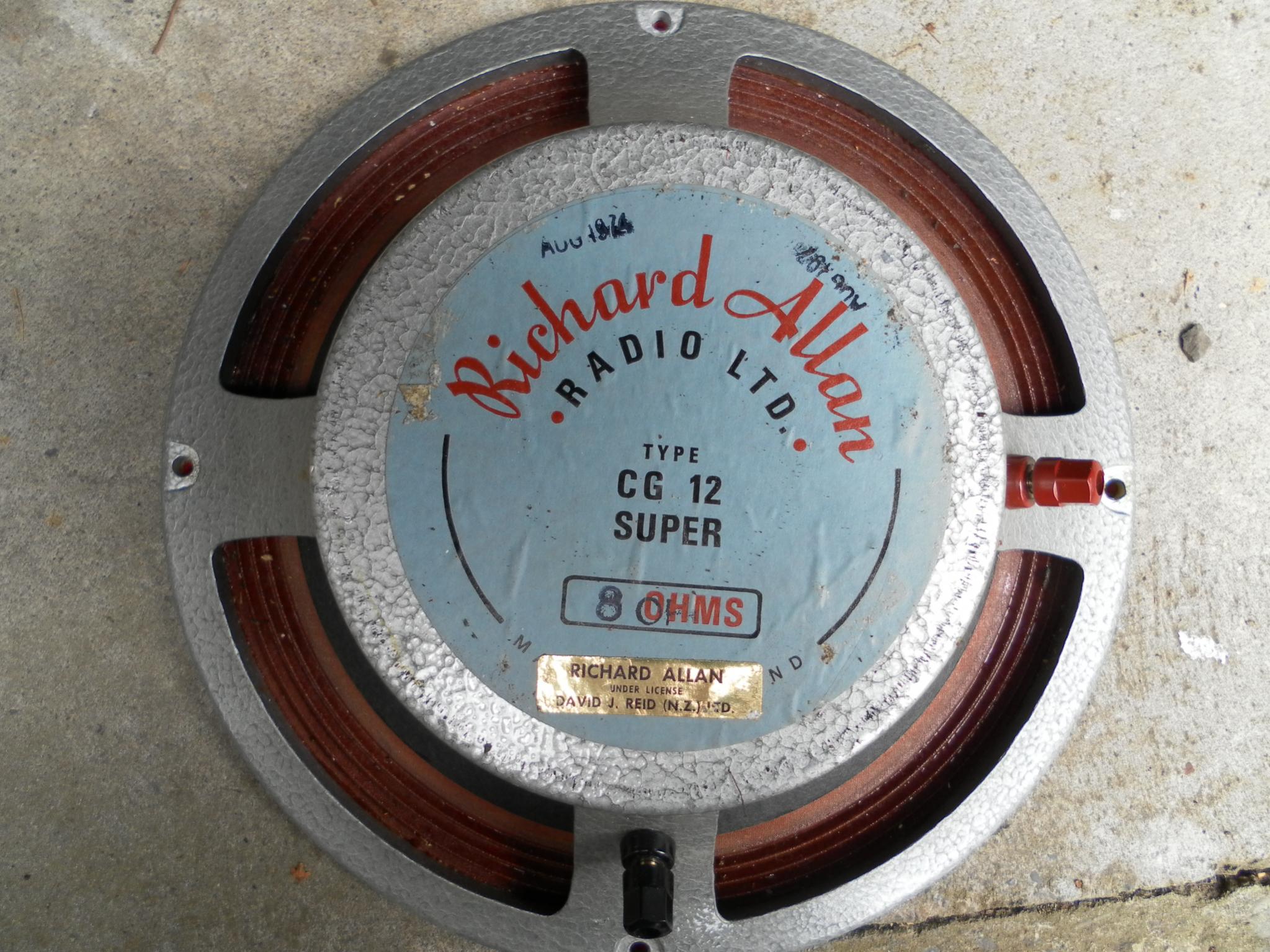

I found a set of Richard Allan CG12's at the local dump, the cabinets were ruined due to moisture and only being made out of chip board,
I am wondering if there is anyone out there that knows what the values of the 12 inch woofer (pics below) would be?
I am wondering if they would be a good base for an OB project?

Hi, There is a link on here to some specs http://www.diyaudio.com/forums/multi-way/33249-richard-allan-speakers-t-s-parameters-attached.html
Depending on the year, the specs "may" be different. For eg, i've seen it rated at between 30W - 100W. Plus i expect the T/S will also be different too.
I know yours are from 1974, but i havn't been able to clarify the data for then !
RA made some excellent sounding drivers, i know because i built a pair of cabs with HD15's & HD12T's Supers as Bass & Mids with Motorola Piezo's for disco use, back in the day They never gave me a moments trouble, & i received Many compliments about the sound. Shame they are not around any more
Make sure they are FULLY dried out, & then operate them on LOW power at first to see if they are damaged. Let us know how you go

are you absolute 100% certain those woofers cannot work in their present state
if the really are no good, you might just as well try and save them and a do a little mod job on the cone
most likely not dipole woofers
but if thats your intention, then a little cone modding might help in that direction
but only when you have made sure they wont work as is
they dont look so bad to me
thanks tinitus.
the boxes these had been mounted in were not usable. The cones now they have been been gently dried as suggested by Zero D seem to work fine.
All other components, mid, HF drivers and XO's are in excellent condition considering their age.

Hi radiosmuck,the bakelizing of the paper cone at the apex is used to prevent creases from occurring as a result of high forces applied from the voice coil.It is a well established practice throughout the speaker industry.The Richard Allan speakers CG12 and the CG12 Super are bass speakers.An alternative model fitted with an inner tweeter cone,the CG12T offered an extended range.
