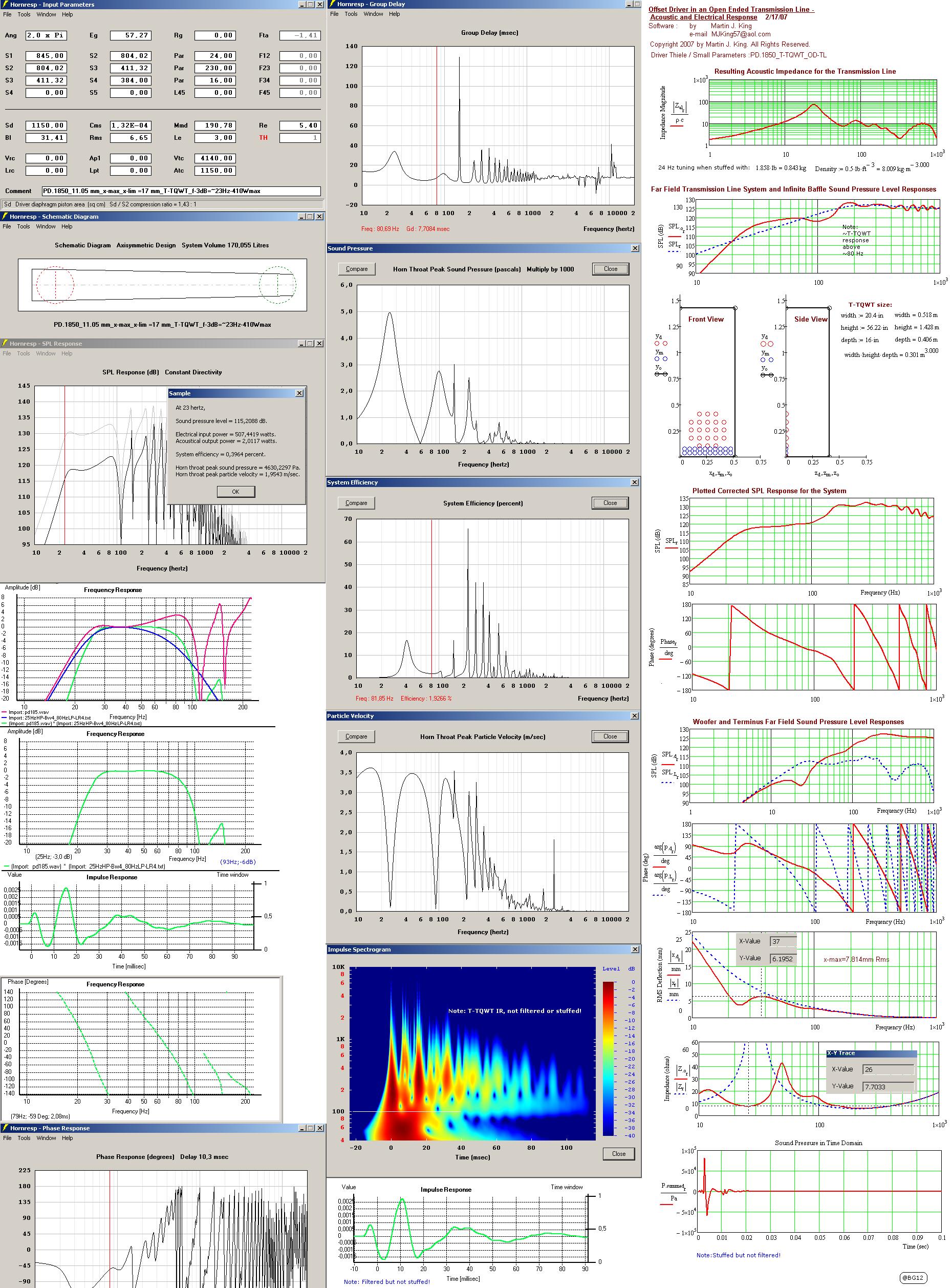

I have settled on a tapped horn for 20 or 30 hz up to 100hz. The driver is to be a high quality 18", yet to be determined on the brand but the PD1850 is looking good.
Maximun height can be 2300mm, would anyone help me with the design, I have hornresp, but tapped horns are beyond my basic knowledge.

:eek:Prepare for a box larger than 500L if you have a TH in mind and you have to invest in an good FR EQ + signal delay for your main speakers.
A T-TQWT uses a third of that volume, no EQ or delay needed: :D
b:)
Am I reading that right B? No delay needed?? Why...?

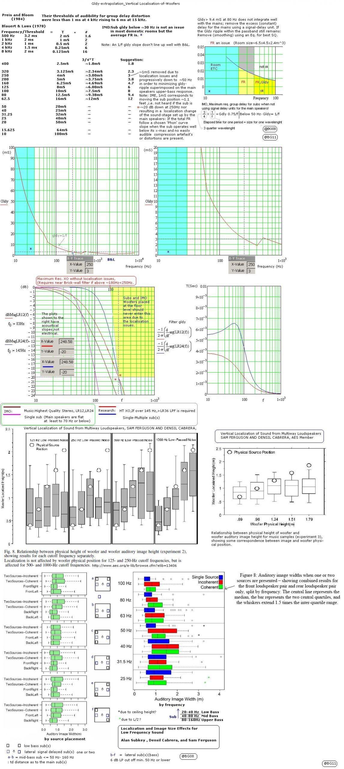

Hi mRgSr,
Ever since the early seventies and on Ive never bothered on Gldy delay for most of room scattered subs Ive designed and built (Ive designed hundreds of (multi-)sub systems since then) if the Gldy stays below a 1/f slope of ~10 mS(~9.4= my choice) as this is within brain fusing-time for signal onset of the Pre-Pulse and Main-Pulse) at 80 Hz when used with overlapping mains:
The resulting FR ripple is IMO/IME minor when compared with the room interactions( normal domestic rooms) that always have a much higher influence on system FR smoothness at the summing point.
In larger rooms and when the listening differing distance to the mains and the sub(s) adds several mS you cannot avoid signal delay units, this applies too if subs are used as a stands for mains:
You generally want good acoustic summed phases at the chosen XO point.
b:)
